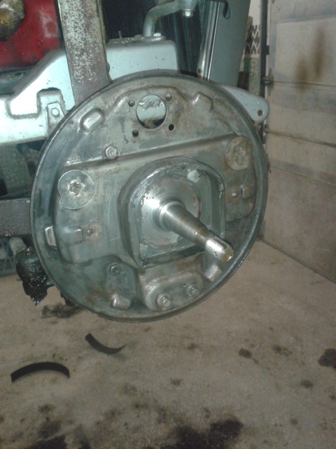

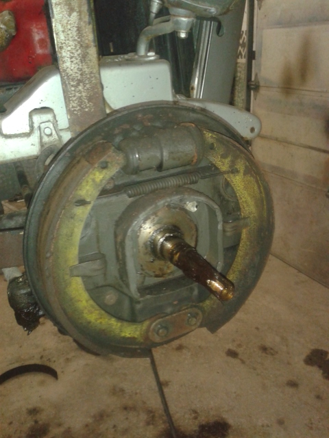

  7. and a before, during & after with the right front brakes, onto left front & then rears today.

    Backing plates and spindles look to be in very nice shape. Are the drums able to be turned?

    I spend very little time on FordBarn but are the grease catch things on upside down?
    "I need my mirror boy"
    Atwater Mike and Denns1989 like this.
  11. Hey shine.
    You are right.

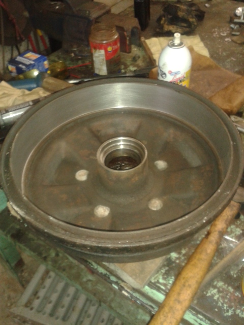

  12. Shop was able to turn the fronts, couldn't turn the rear because of the axle hub, my machinist friend is taking care of that this coming week - I went & seen him today, will drop them off after moving Snewpee around this weekend, here is one of the front drums, cleaned up nice.
    ha ha the car will answer to either name ;-)
    Okay, I'm going to stop posting pictures if you guy's start making more work for me ! ha ha ha, ya they are definetly different than the rears, makes more sense to have the curve on the bottom, here is the right rear all cleaned up after some effort today.
    And I also discovered that I have the front shoes on wrong, didn't realize the forward/ reverse shoe length difference until I started working on the rear brakes... oops that's an easy fix... plus I have to take front hubs off again to fix the upside down grease catchers... those must have been wrong since 1962 !

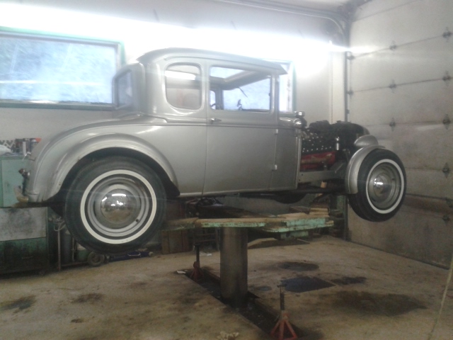

    And here is how the new tire looks with the "cycle" fender

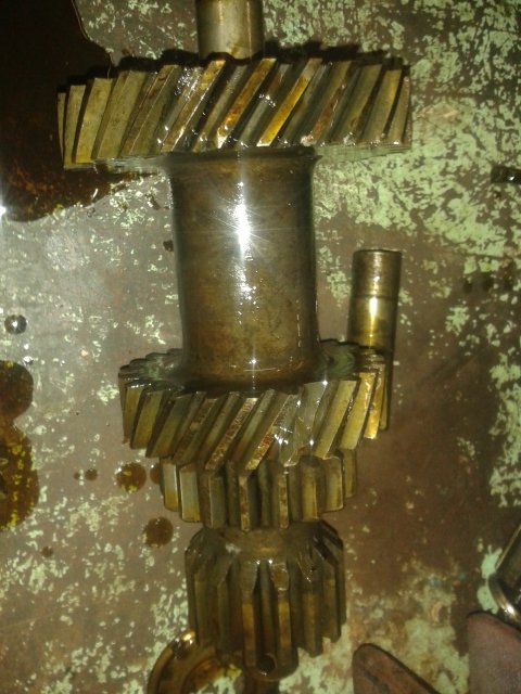

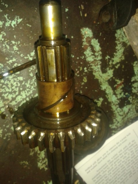

  23. The picture you see must have caught the gears "good side" unfortunately there is some chipped & even one missing tooth ! Removing the transmission was a bear, like I mention above, I drilled 2 1" access holes (actually 3 but 1 was my screw up) to get to the mount nuts, then we used a long extension to get the 2 bottom bolts off of the torque tube/ujoint flange (it was impossible to get the sandwich clamp bolts out) but the top 2 bolts for the torque tube/ u joint flange were near impossible to reach with tools, so my buddy noticed if we opened up the torched out transmission opening by about an inch & half we could get at the nuts & bolts with spanners -out came the zip disc !!
    ***isting my buddy Chris removing transmission from Snewpee
    Do you see the missing tooth ?
    rounded off gear edge...
    chipped teeth...
    floor opening now 1.5" longer...
    I will be in contact with Marc Van Pelt today to formulate a plan... with this much damage to the internals I don't have a good feeling about it ...

    Can see the damage plain as day now.
    A few different ways you can go to fix the trans as I am sure Mr Vanpelt will tell you. Later gear sets can be used in the case with some mods to the synchro's I believe. And I think that you would need the wider shift forks as well.
    He's the man with a plan when it comes to a trans..........:)
