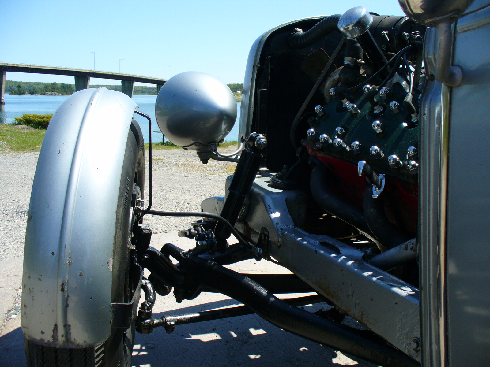

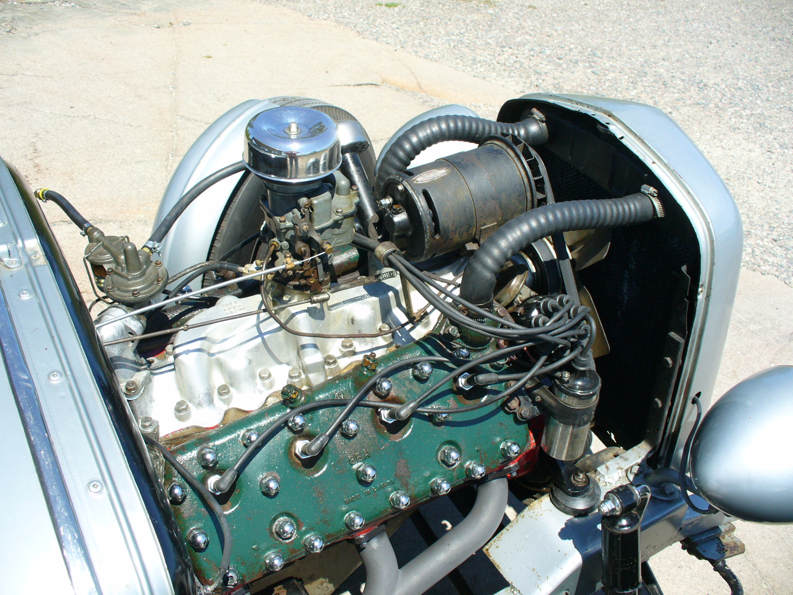

  1. Today I was walking up my father inlaws drive to take a few pics of the cleaned up motor & front suspension on Snewp's, as I walked up on the car I thought to myself "Damn that thing looks cool head on !"
    So here is the degreased engine & you can kinda see the cleaned up front suspension as well - the other day I took an old snowbrush, cut the worn out end off & then sprayed citrus degreaser on the engine & started scrubbin (high tech eh ? ha ha ) Then I fired up the father in laws pressure washer & cleaned the dirt & grease off the front suspension (didn't use it on the motor - didn't want to blow all the engine paint off), weather was finally nice enough to do these 2 jobs - Didn't appreciate how grimy everything was until I got it cleaned up.

    There was some bare metal under some of the grime so I had a part rattle can of clear coat in the garage, just gave it a quick shot so it's sealed up.
    It's running so nice after the new intake gasket - beauty, out for a run with my buddy the other night (his 2nd ride) & he said "I still can't get over how this thing works together, it's far from a high tech build, solid but not pretty construction, but the stupid thing works great, I can't get over it", I have to admit, this is my 1st hot rod but I was prepared for a much more tempormental ride etc. for a car that was cobbled together by a couple teenagers in the early 60's with a torch & stick welder, I just laugh & shake my head, crazy thing -

    Hey I like the cleaned up look. It does occur to me though that the front anti-roll bar is doing exactly nothing. You can leave it like that as a conversation piece (as long as you can tell people you know it's useless) or remove it completely. You won't feel any difference.
    Mart.

    I questioned that too. What if the pivot point closest to the bar was locked solid? That would make it function, yes?

    Looks like stock 40 roll bar--can you move the locating bkts back so the links are vertical-then it will function
    Weezy1930 and volvobrynk like this.
  6. Thanks all, yes my Buddy's Dad pointed that out the day I hauled it home late last August - I didn't think it would do much the way it is :) I will have to check - the panhard bar also mounts to the sway bar bracket, but I might be able to slide the whole assembly back... it rides fine for me, but if it's a simple fix - why not ? I wonder if they did that originally because of the front brake line routing/exhaust clearance issue on the left side & needed the link to be horizontal for clearance... not an issue now with the new exhaust..

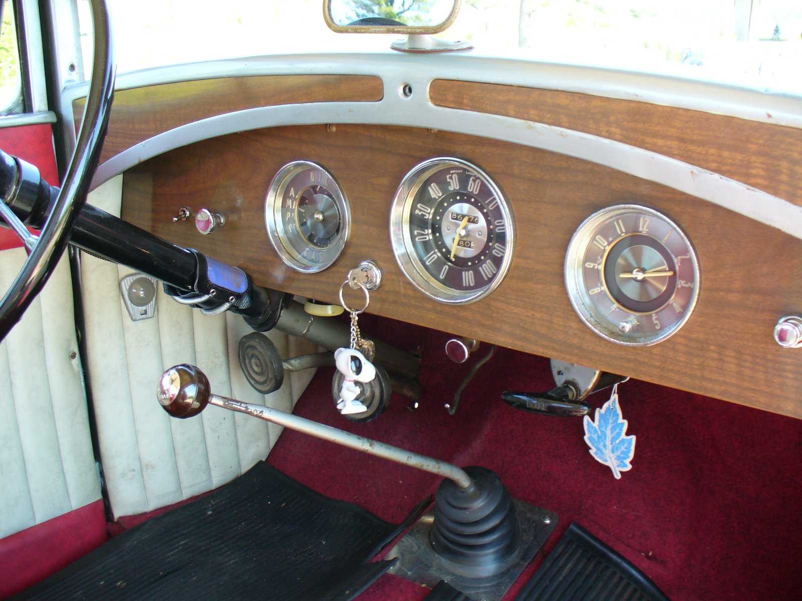

    On another note, I got the dash clock working - ha ha I know many of you were probably wondering if that clock worked, because we all know that is a critical option for a proper Hot Rod :p Had a couple hours the other day & decided to pop it out & see if it was a simple fix, just needed the contacts cleaned up & little "love" to get the main shaft spining again - Now it ticks away & "ker-thunks" every once in awhile to keep it tickin - I knew it was an early 50's Buick style gauges in the dash, the clock had "April 53" on the case so I would assume a 53 or 54 Buick Special donated it's gauges... I love finding little clues like that :)

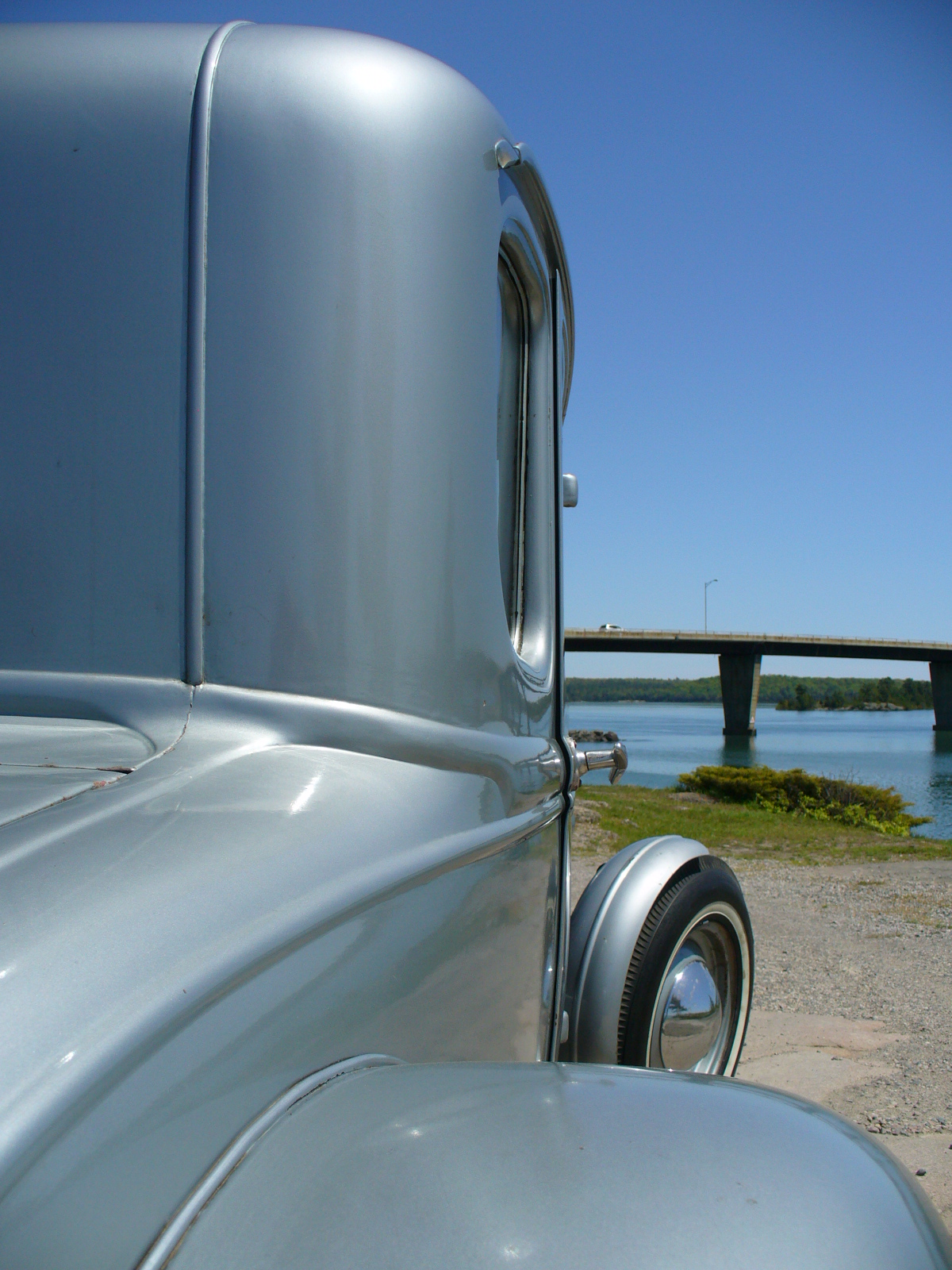

    Everyone says they like pictures - Here we go !

    OUTSTANDING, your pics and your hot rod intent is GREAT. Gary:D
