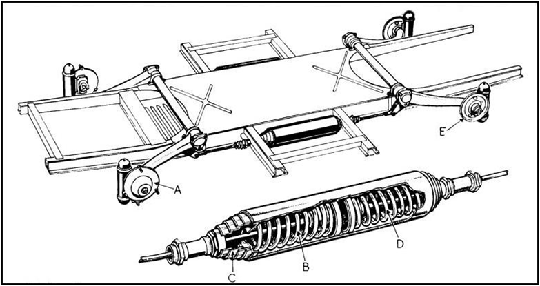

    @Ned, you're absolutely right (easy, you're an expert!).
    @noboD, rather than a long explanation, here's an drawing that perfectly illustrates how the 2CV's suspension works (here in a version with friction dampers - not visible - located at the ends of the front and rear arms and the 4 "bumpers").

    To clarify, the key element of the system is that the tube containing the springs (pot in 2CVese) isn't attached to the frame but is free to move fore and aft a short distance. Due to the rather severe motion ratio of the suspension arms, that small distance translates to a fairly substantial wheel travel. The fore-aft movement of the pots is resisted by steel volute springs in the early versions, as shown in the drawing, or rubber springs in later versions.
    The motion ratios make the system tricky to damp, and early 2CVs had inertia dampers: the vertical canisters at the ends of the suspension arms. They were basically a weight carried on a spring inside a hydraulic damper, and were of limited use. Later 2CVs had telescopic dampers mounted horizontally between the short arms of the suspension arms and the frame, where they partly defeated the object of the interconnection, as do the dampers on the Seidlitz.
    An effective way to damp the system properly would be to turn the entire pot into a hydraulic damper, making use of the large piston area to counteract the short stroke resulting from the motion ratio. I tried something on that principle here: https://www.jalopyjournal.com/forum/threads/interconnected-suspension.1325027/page-3#post-15781051

    Nedou're absolutely right (easy, you're an expert!).
    **, rather than a long explanation, here's an image that perfectly illustrates how the 2CV's suspension works (here in a version with friction dampers - not shown in the drawing - located at the ends of the front and rear arms).
