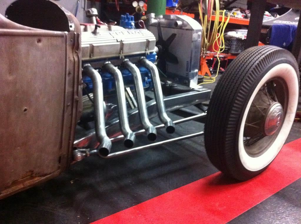

    so after dropping 5 and a half large :mad: on a hairpin kit to replace my wishbone on my sedan i get home and get everything torn apart and put back together i realize my hew expensive hairpins look like a flaming bag of poo i am kind of stuck in a rock and a hard place i cant move them up to the top of the frame rail because of the exhaust and i the car is channelled so the cowl is in the way of running them through the frame i dont know if these are the "32" or "model a" hairpins but if you look you can see the hole where my split bones mounted maybe i will just return them but i did like the thought of integrated shock mounts thanks guys

  2. Move them up , mount them to the rail and put a proper exhaust on it , ***uming you want to drive this thing on the street ?

    I second that 4t6ford......... thats actually a pretty nice lookin ride build some mounts for those hair pins and call it a day

    proper exhaust ???? lol i've got like 16 hours in those lol

    as cool as those zoomies look AND THEY DO LOOK COOL, whats the decibel count inside the sedan?

    i have no clue i have never fired them up i was looking forward to it ohh and thanks for the compliment they were my second attempt at making them maybe i will just run lakesters like everyone else
