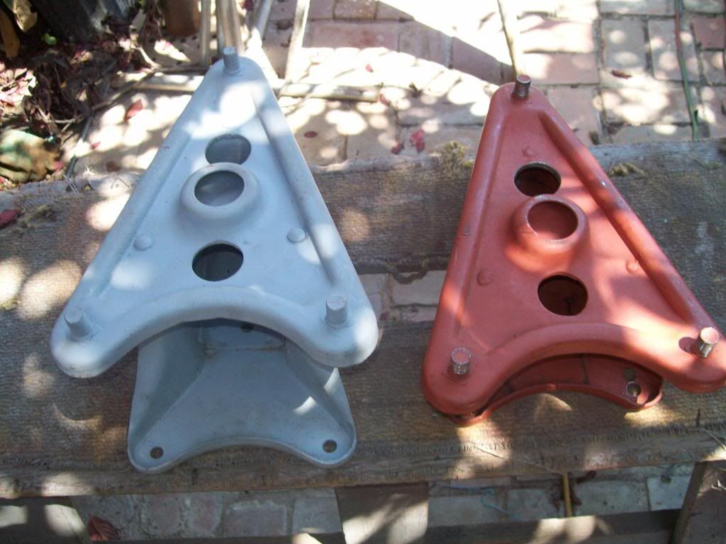

  16. I lowered and tucked in the spare by cutting it apart slicing it and welding it back together. Then I redrilled the mounting holes to get it about 2 1/2 inches lower total. The grey one is stock...

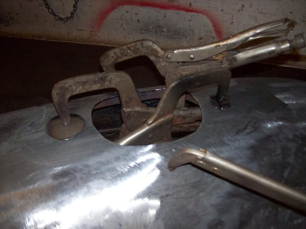

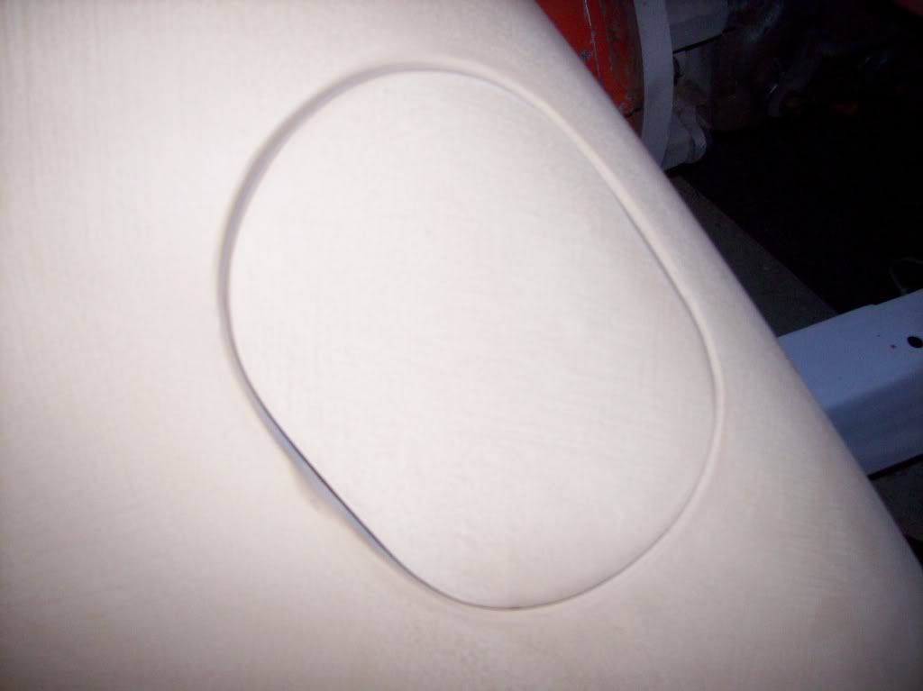

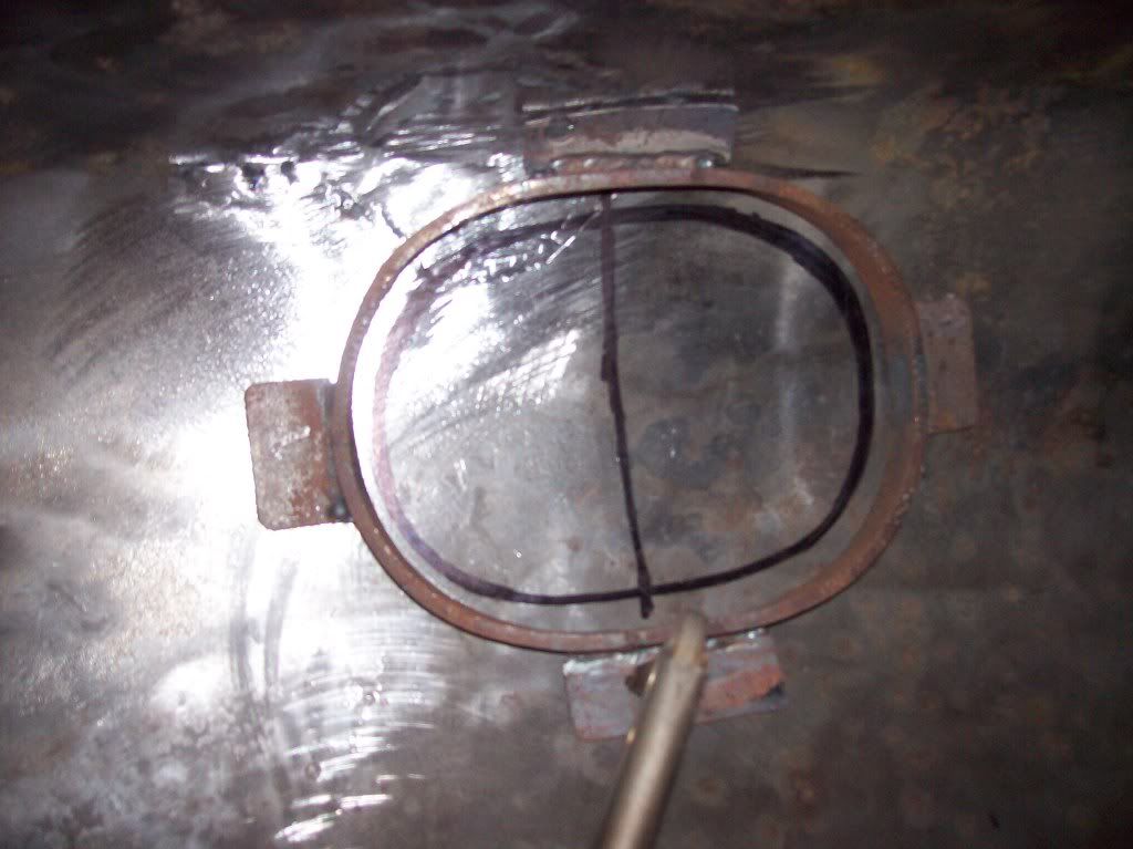

  17. Here's how I did the '41 Ford gas door... First I made a fixture to form the opening...
    After filling the holes in the fender I decided where I wanted the door...
    clamped securely after cutting out the opening...
    Work edge over slowly...
    Test fit and hammer and dollie till the fit is perfect...
    I used a late model headlight bucket to fill in the void...
    [​IMG][/QUOTE]
    Very clever - it gives it a nice "factory" look. Awesome build. vic

    Looking great. nice work on the filler door. Is it on the left rear fender?
  21. I tried to position it so the original filler tube could be used after shortening...
