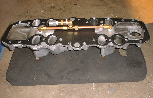

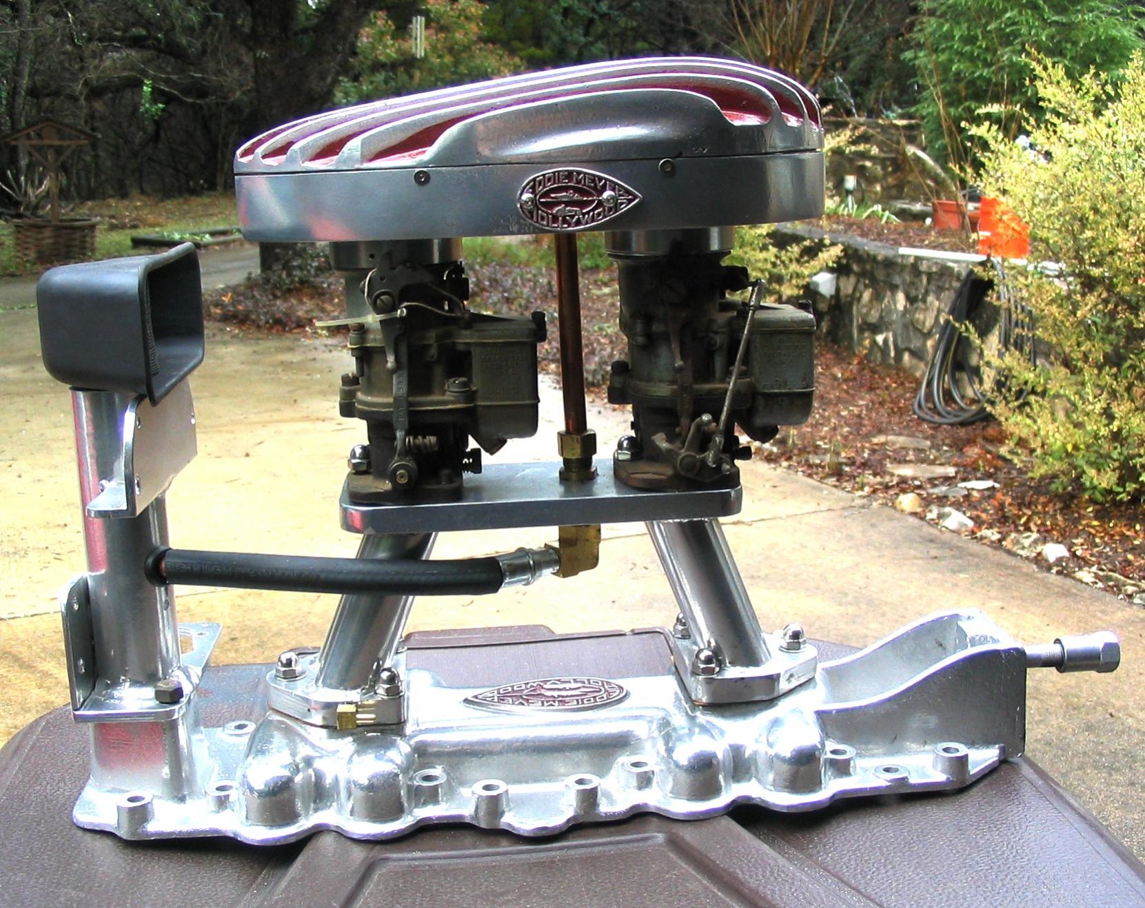

    Mine (see pix). The motor is actually an 8BA decked out to look like a 59A. I'm running an early style intake so I pulled the lifter valley tube and plumbed this under the manifold with a NAPA CRB29255 PCV valve that is designed to work horizontally (Borg Warner PCV255 designed for vertical but works horizontal. Fits 1990 V6 Isuzu trooper II (1993 Isuzu has ****** on both ends). 1965-66 Caddy 429 (California) uses a horizontal valve and calls for the PCV255). Clean and out of sight. The valve is pointed forward so it doesn't just **** the makeup air from the stock breather on the fuel pump stand.
    There was a discussion a while back about ****ing too much oil if you hook the PCV directly to the 8BA oil fill pipe:
    http://www.jalopyjournal.com/forum/showthread.php?t=36438&highlight=adjust+clutc
    h

    Gashog, Way cool.... Wish I'd seen this about 6 years ago,.....

    I mocked this up but never went with it due to the fact that the PCV is a controlled vacuum leak and all the air is added to one cylinder which will probably lean out that one cylinder. All factory PCVs that I have ever seen are at the base of the carb so that the added air will be distributed to all the cylinders instead of only one. Be careful that you don't lean out a single cylinder with were you locate the vacuum source.

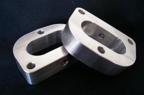

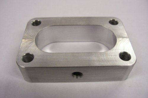

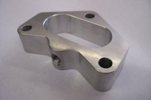

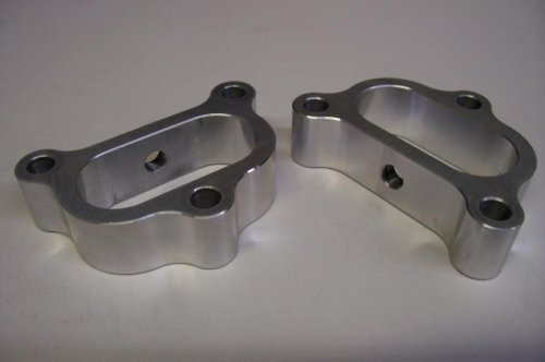

    We have a few different styles to match the three bolt intakes, such as the Stromberg 97 and Holley 94 standard base shapes. Also the Edmund's / Thickstun / Tattersfield shape. We do have the WW / Carter / and small Rochester 2G vacuum riser as well. If you don't see it let me know.
    Dashman's Hot Rod & Speed Parts
    www.dashman.net
