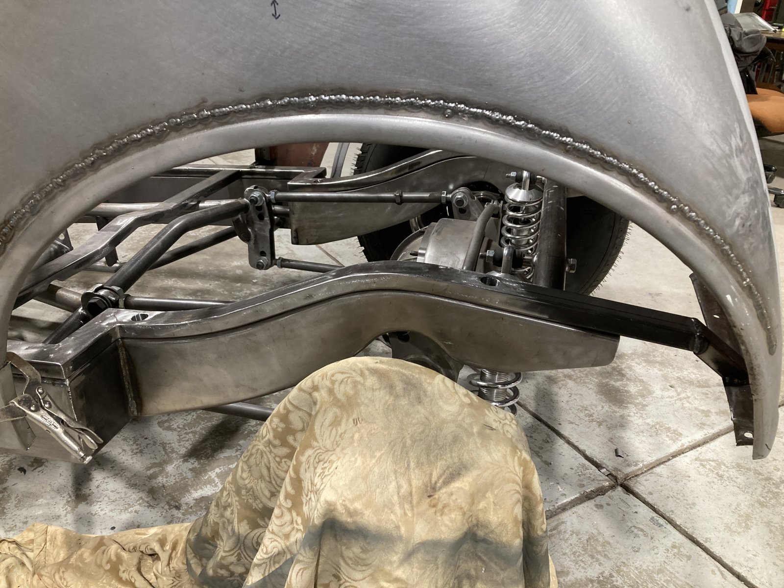

    If all those lines visible are your fit-up - excellent work. It’s a shame to have to use MiG on that! That fit-up is far better than anything I’ve seen on fitzee videos. I’ve only seen a couple as he gets stuff done but it’s often not the right way. I’m sure he has content that is very helpful but I prefer inspiration from Wray Schelin and the like.
    I would agree that grinding highs around the welds is a trap. Since the bead shrinks, pulling in and down on the seam, the surrounding metal is more exposed. You will seldom get down to the toe of the weld for a perfect surface without severely thinning out the parent metal. Then repairing unforgivingly thin metal becomes your new problem. Far better to planish your welds, grind them down slowly and carefully, and bump the seams around to smooth them for putty. This way you aren’t thinning the surrounding sheet which actually now needs its own full thickness patch - not a MiG wire patch.

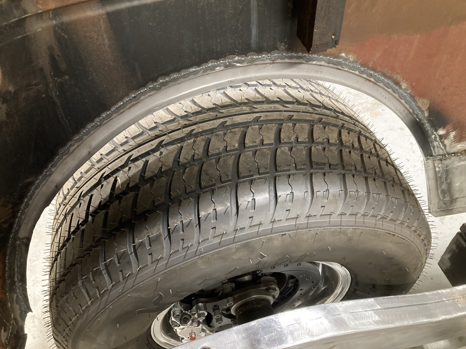

    1. Why are you quenching? Don't.
    2. After grinding/sanding, I can still see the interface of the two pieces. You're not getting fusion in these areas. Either you're missing the interface with your weld bead or your technique/parameters aren't sufficient to allow for penetration of the material, and all you're doing is sticking a bead on top. You need more practice dialing in parameters and hitting your target.

  7. I don't quench, but I do keep a damp rag close by if I need to cool something. Like multiple have already said in one way or another, you can **** up a lot with the same grinder that you're trying to use to make things better lol. If you're trying to master metal finishing, lay down the grinder and grab a body file, practice your hammer and dolly techniques, and post a picture of your welds prior to grinding, maybe you can get a little more heat in there and create less work on yourself ...

    Welding requires good technique and patience but grinding of welds requires the same. I don’t know what kind of grinder you are using but in my opinion a side grinder with grinding wheel or flapper disc doesn’t give you enough control and results in removing too much metal from the surrounding area. Those grinders and cutting wheels are great for removing heavy weld on thick steel but not sheet metal.
    I like to use a die grinder with maybe a 2” RolLoc discs and concentrate on grinding the weld only until it almost flush with the surrounding area. Keep the sanding disc parallel to the surface and don’t use just the edge which a lot of folks seem to do. For practice try putting some masking tape on both sides of weld and grind weld without sanding off tape. Also very important to use new and sharp sanding disc so you are actually cutting the weld and not just creating heat. Once the weld is almost flush with surrounding metal you can switch to a larger diameter disc to blend to surrounding area without excessively removing too much sheet metal and thinning it. Your mileage may vary.

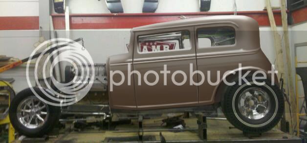

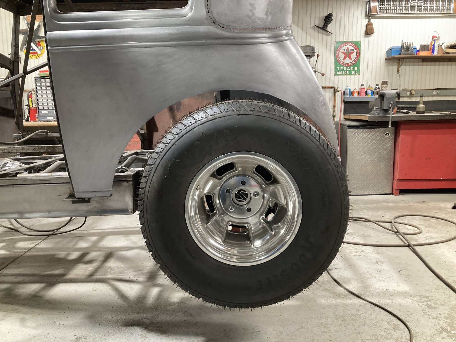

  23. Is that a Vicky body with raised wheel arches?
  24. milwscruffy
    Joined: Aug 29, 2006
    Posts: 4,255
    milwscruffy
    Yes Sir ! It's my Profile photo also.
  25. Nice !
    And that’s not easy to do either
    milwscruffy likes this.

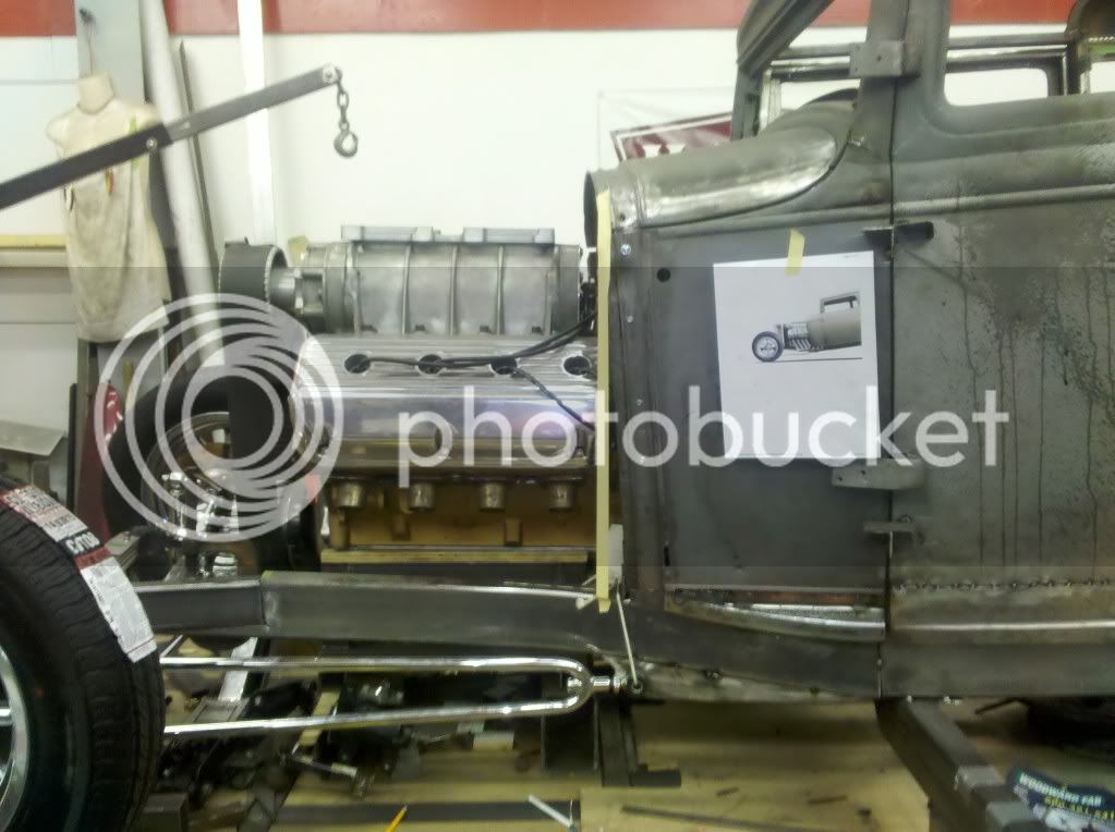

  29. milwscruffy
    Posts: 4,255
    milwscruffy

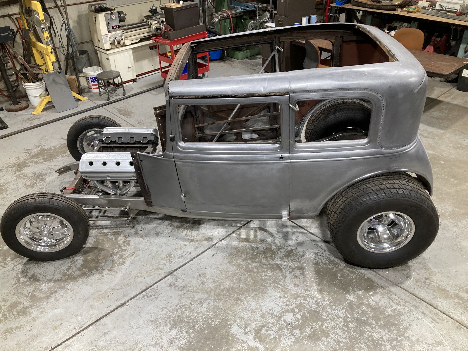

    Thanks, it was necessary because I channeled the body 2" over the frame. Took my time and plodded it out, hardest part was making the first cut because there was no turning back after that. Also when I decided to channel the body I had to move it forward 1 3/8" to clear the frame comfortably. So it was twofold, up and rearward. I wanted to maintain the wheelbase as is, so you have to do, what you have to do ! The end goal was to make it subtle enough so that many won't really even notice it and not make it look off . Glad that part is done ! Don't want to hi-jack this thread so I'll stop while I'm behind... IMG_1098.JPG IMG_1090.JPG IMG_1008.JPG
  30. That’s hi jack is ok I think.
    I went thru the same mental gymnastics with mine. Obviously it’s doable as you did but I couldn’t get my head around the cut and how to bring it all back together. Matter of fact talking about that cut and reaching out for help is how I met a friend, a very good friend.
    I chickened out and took a different approach and added 2” to the bottom. Custom built the frame following 33-34 profiles, with model A top view.
    Funny I never used photo bucket Lol
