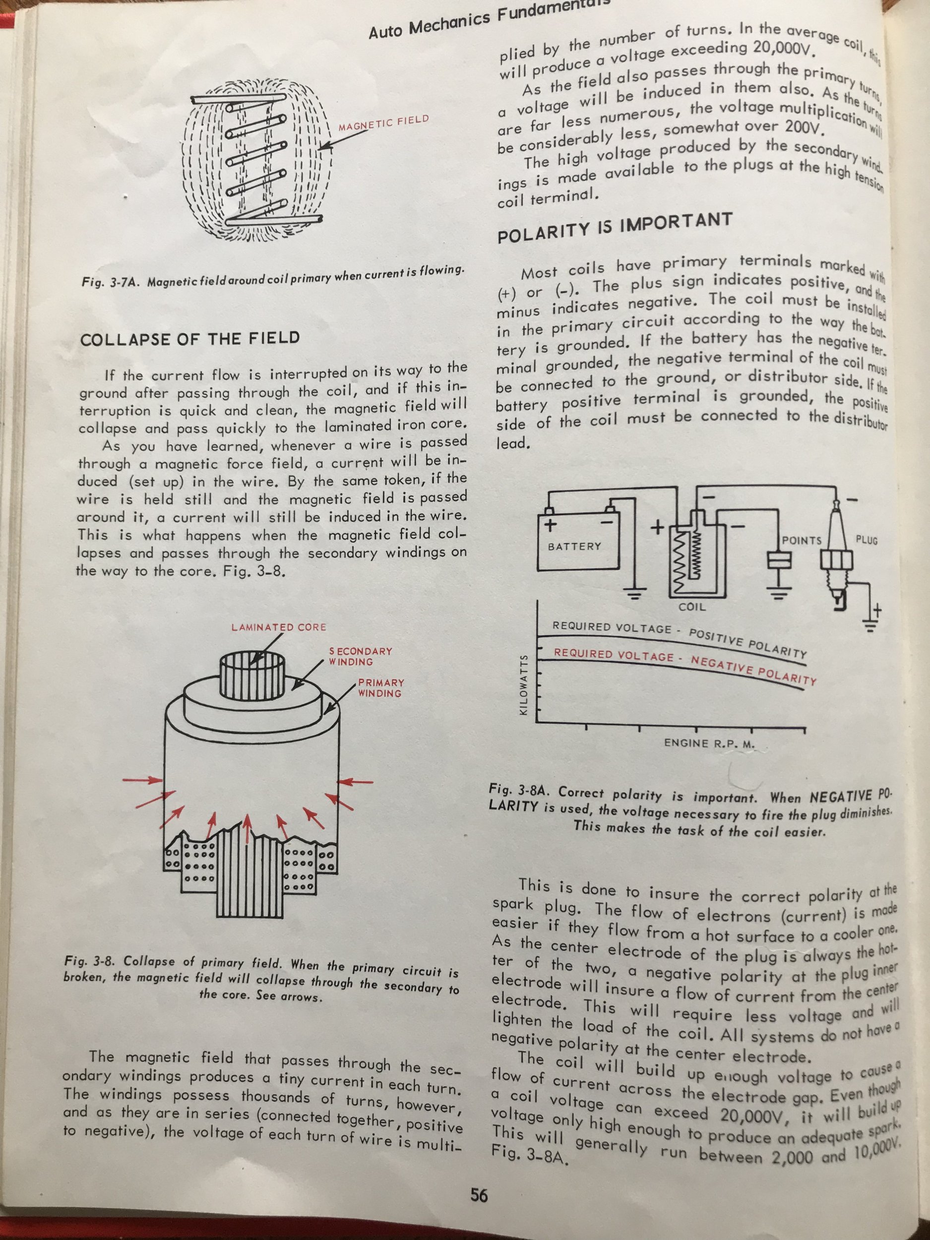

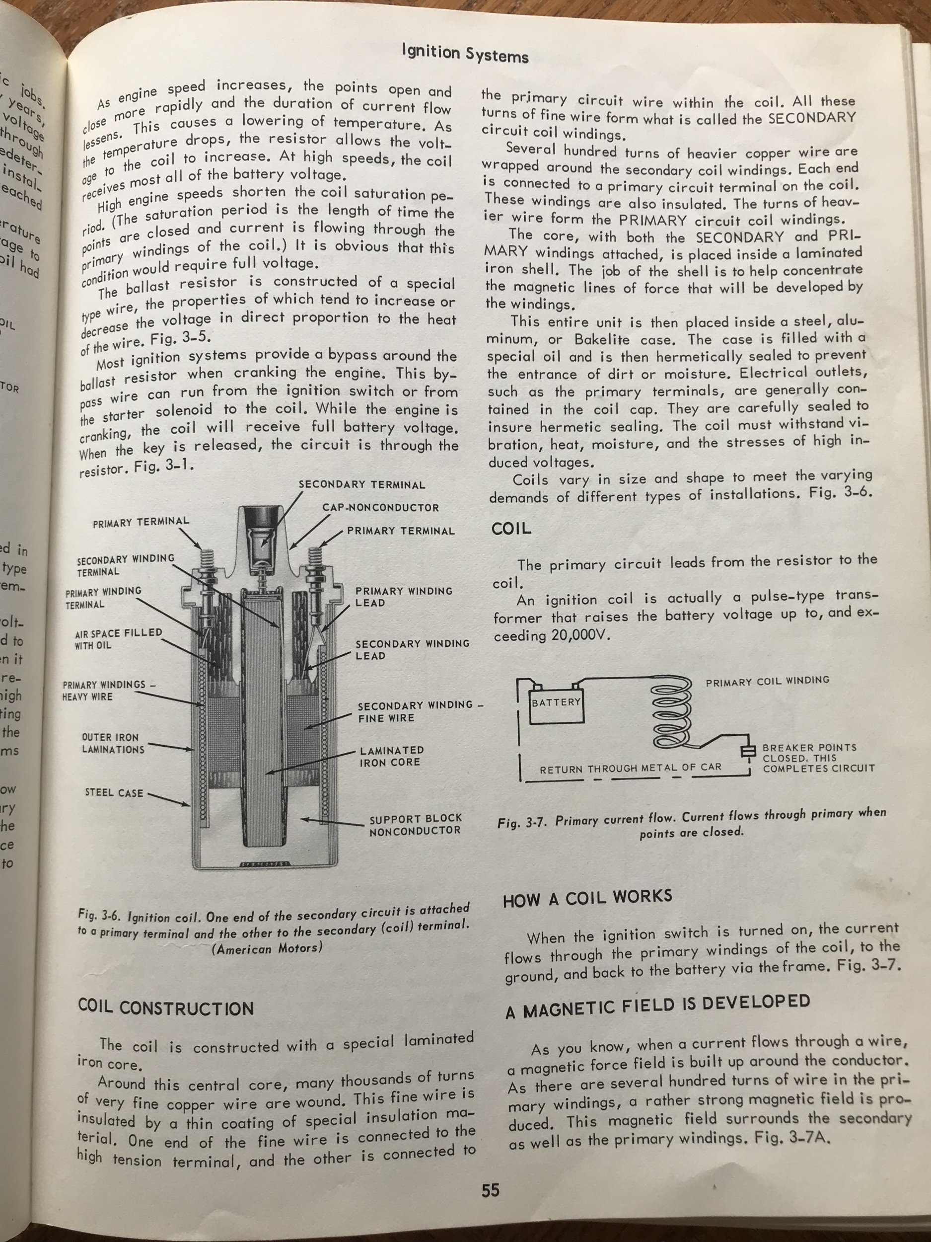

    56DDF5B9-947F-4C61-99D6-495207A685BA.jpeg F5EC8F79-4E6B-4E47-8CC5-875F3A0A04AF.jpeg 9A148E35-C4C6-4113-A313-CD41B78AE591.jpeg
    46international likes this.
  24. Wanderlust
    Joined: Oct 27, 2019
    Posts: 1,123
    Wanderlust
  25. Let's see if I can clarify this...
    Look carefully at the diagram...
    Power comes in on the positive terminal, goes through the primary coil, and when the points are closed, out to ground via the negative coil terminal and points. This is when the magnetic field in the primary coil is made. A complete circuit. But the secondary side of the coil is also connected to that same 'grounded' negative terminal and the other end of it is 'open' (no power applied) so no voltage/current can flow.
    The points open. Now both coil windings no longer have a ground through the points. The magnetic field in the primary collapses, inducing voltage in the secondary winding. This high voltage seeks a ground as it's still being 'pushed' by the power coming in at the positive terminal. It squirts out to the spark plug and jumps the gap. Once the magnetic field fully collapses, voltage drops off and the spark dies. When the points close again, the process starts over...
