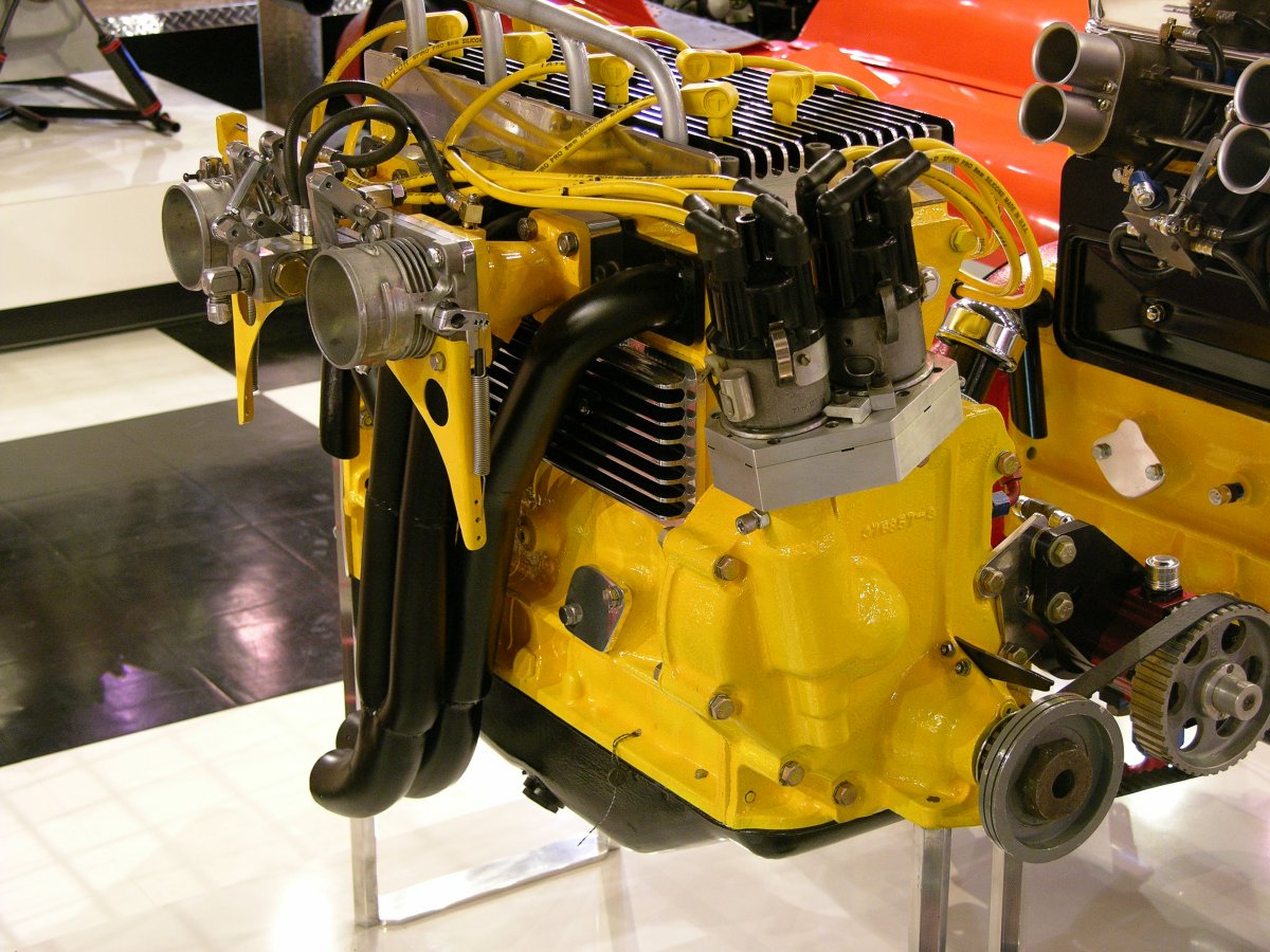

    DSCN8335.JPG v4.JPG Guys that have hopped up new direct injection engines, have put another nozzle in the intake runner. So far no way to work with the inchamber nozzle. As far as throttle bodies, These came from a 4.6 Ford SOHC of around '02 or so. Many, many of these things out there. These are on the Plymouth. I have a bunch and would sell you 2 for $20 apiece + shipping. But you can probably find some cheaper at a junk yard. A Potvin blown Hemi in a Model A sedan would look way cool.

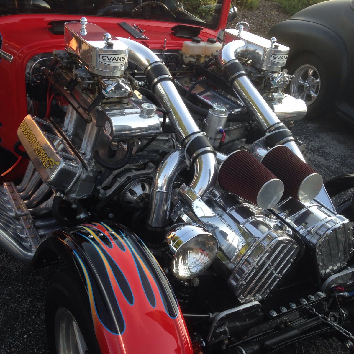

    I stole this from the 2015 street rod nat. thread. Some interesting stuff going on, no idea if or how it runs. ImageUploadedByH.A.M.B.1439681697.799998.jpg

    I was noticing the blow through carbs, not really seeing any fuel into the top of the blowers. No idea what the little tank mounted in front of the carb is for.
  17. That little tank is water, no doubt some sort of a surge tank for the cooling system.

    I happened to be standing next to that right now, he's local and it does run.Let image.jpg

    That's Leroy Holler's Hudson Coupe, He builds some really Wild stuff here is a pic of the other twin big block piclup he built a few years back.

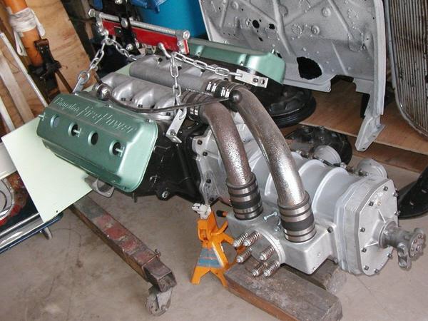

  22. The intakes on that hemi where they used with fuel injection in some ether application?
    It appears to have bosses in the correct spots on the runner for injectors?
    Maybe they are for laughing gas?
    In this photo if you look at the intake runners are bumps in the middle of each of them
    About the perfect spot for an injector
    So i guess my point is that these manifold may have been used or designed to be used with injection?
    And these manifolds seam to be specifically designed for use with a front mount supercharger?
    Also if you had the superchargers internals coated like the m62 eaton buick used on the 3800v6 in I think the 1995 riviera would that stop scoring

    OK. I squinted enough to see the bosses cast in to the intake logs. I would guess that that is a place where you could put port nozzles. When Chuck Potvin first made these kits a lot of people used carburetors mounted on the blower intake. This particular one has the throttle plates and nozzles on the inlet side of the blower. The Eaton blower is a different animal from the GMC and it's clones. The GMC builds heat by friction of the air flowing back over the lobe trying to push it in the engine. I know that several people have thought they didn't need fuel in the blower. The ones I know, have decided they were wrong. And I don't see what the advantage would be. You beat up the fuel droplets that much and they are bound to be better atomized.

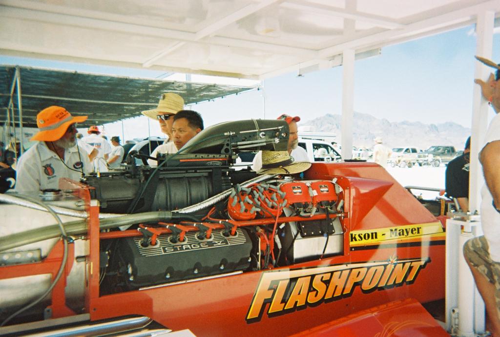

    Now here is the current way of mounting a blower.. No sissy 6:71 here. 18:71 for these guys. This engine runs no water any where. 60 PSI boost from just off the start to the 5. All most all the fuel runs through the blower. But it has down nozzles under the valve covers to each intake. What do you think ******? R1-07918-015A_zps03172ad1.jpg

    Makes one hell of a racket when you fire it up, too!

    Should be louder this year. 525 inch motor replacing the 498. And Bob bought Nitro. If he gets to run. Hoping for WoS or the Cook meet now.

    Crazy. Should get up and go pretty well with that setup.
    Now, if nature cooperates.
