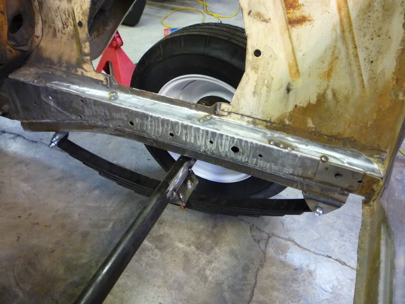

    So 20170111_171759.jpg 20170111_171943.jpg 20170111_171933.jpg I got the outside pieces cut out for the frame, just need to clean them up, weld them together and spot weld it on then on to the next. 20170111_171759.jpg 20170111_171759.jpg 20170111_171943.jpg

    Both pieces welded together and cleaned up. Im far from being a welder or metal fabricator but I must say this came out pretty damn good, I surprised even myself, lol. Drilling the holes for the spot welds tomorrow then will weld it in this weekend. 20170112_173701.jpg 20170112_173716.jpg

    Got all the holes drilled in the plating for the outside of the frame tonight. I know its not really a big deal but im pretty happy about the way it came out, even know its just holes, lol. The frame is just like new with absolutely NO ROT AT ALL and looks like new. Anyway, here are a couple of pics from tonight. 20170113_195210.jpg 20170113_195130.jpg

    Ok, I know I got outta hand with every little step pics but just a few more and I will stop. Now im not a welder by FAR but was pretty proud of my welds on the outside plate. 20170114_135429.jpg 20170114_142124.jpg 20170114_143547.jpg 20170114_143606.jpg
