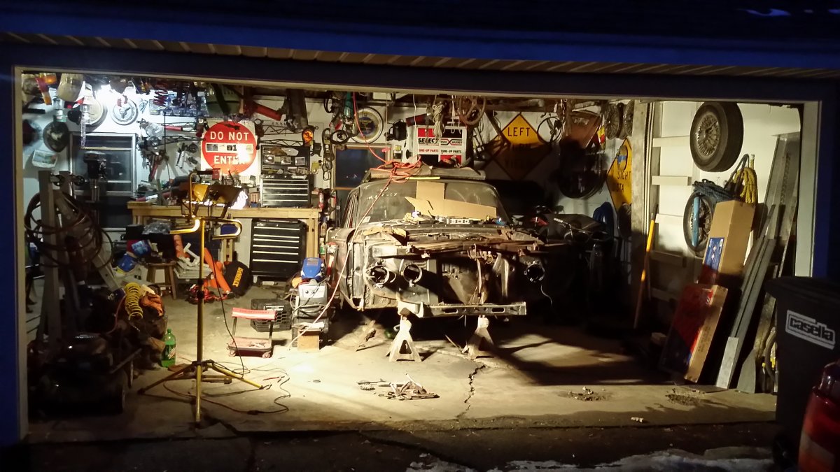

    Heres a night pic of my garage (Mess), with my work in progress 20170119_170504.jpg

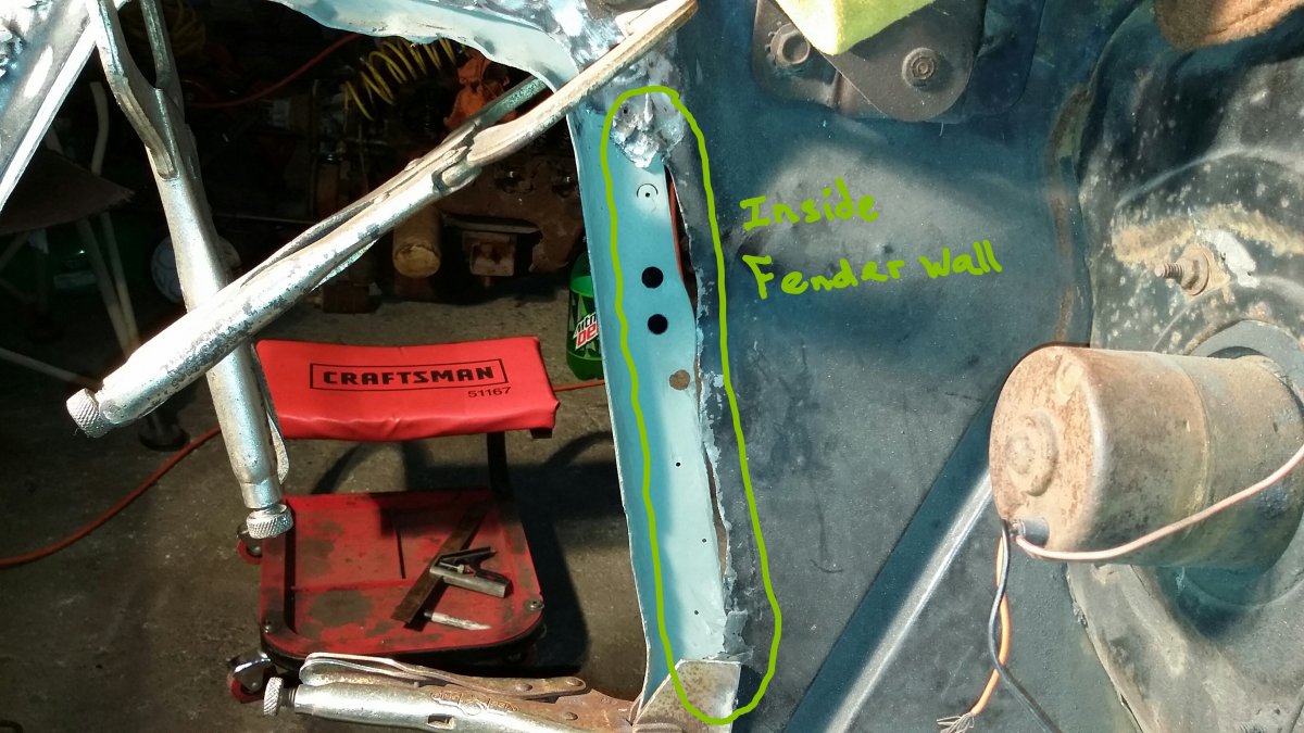

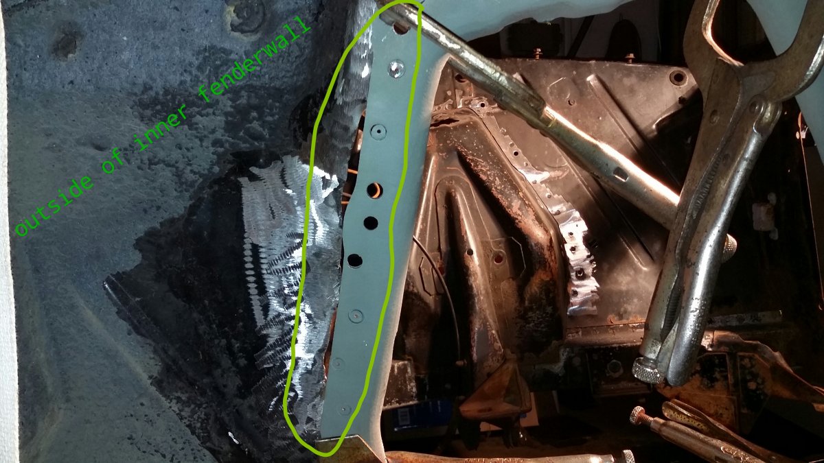

    Ok, now back to the program...... Can somebody please help me out on how I should repair the sheet metal that I ripped and cut out not thinking about how flimsy the fender wall is without the shock tower flange, so im going to try and work it back in but not sure what to do with the missing **** that I cut out so the hole in one area is now larger then the flange so it cant be welded back in. The largest area is near the 3 holes which is about 2in. Thanks with any help. photostudio_1484869166712.jpg photostudio_1484869429677.jpg

    Are you planning on running fenderwell headers (go through these panels), or ones that go between the rails?
    justadream likes this.
  9. Gammz
    Joined: May 10, 2015
    Posts: 806
    Gammz
    from Lincoln Ne
    What type of welder do you have? If your good you might be able to s***ch weld it back together. Paying very good attention to your heat. Or ya could cut some filler pieces out of the same gauge sheet metal for the really wide gaps.

  12. justadream
    Joined: Mar 2, 2009
    Posts: 147
    justadream
    from Vermont
    I am planning on running fenderwell headers.
  13. justadream
    Joined: Mar 2, 2009
    Posts: 147
    justadream
    from Vermont
    I just have a small Lincoln pro 125, but im no pro, haha. It has the settings A,B,C and D with wire speed 1 -10. I have only welded on thick stuff with the 1/8 plate being the smallest, never done any sheet metal, at least not yet.
