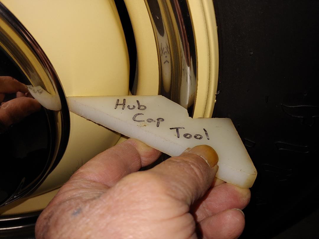

    I made up a couple of these from s**** nylon. Smack the end of it with a hammer to pop the caps off. Works very well and doesn't scratch the paint or the cap. Keep one in the shop and carry one in the heap.
