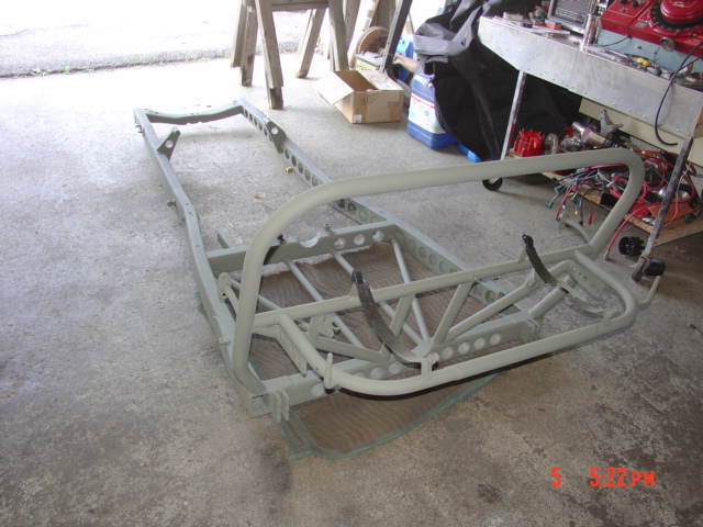

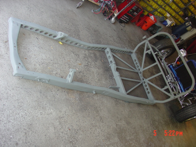

    This what you have in mind?
    A Model A frame reshaped to Model T bucket, front rails swept & pinched, frame reshaped so the seats have pockets and the rear suspension is quarter elipticals? This what you have in mind, a ch***is built so you can sit in the channeled bucket and look thru the windshield instead of over it? With hemi motormounts?
