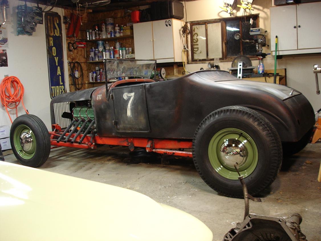

    Looking at the rear sweep of the frame, I presume this is a TT frame. It appears to be thicker in the mid section and taper more.

    I sure wish I was closer. I would start on it tonight( even though I am booked for a year). I just love the old pics of that T. Good luck, Larry.
