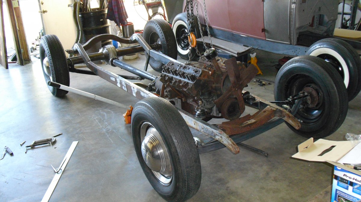

    here's some more pictures,
    food for thought..
    a stock frame, boxed and stretched front and rear,
    in front to fit the engine between the uncut firewall and radiator
    and rear to put the A spring behind the rear axle
    you'll have to imagine a pickup bed in place of the turtle deck..
    very simple and relatively quick to put together

    do you remember what the wheelbase was?
    *edit* I hit the wrong reply ****on...I don't care what the cat's wheelbase is

    Had to measure it myself, tried to get the cat to hold the dumb end of the tape and she looked at me like I was stupid
    About 108"
