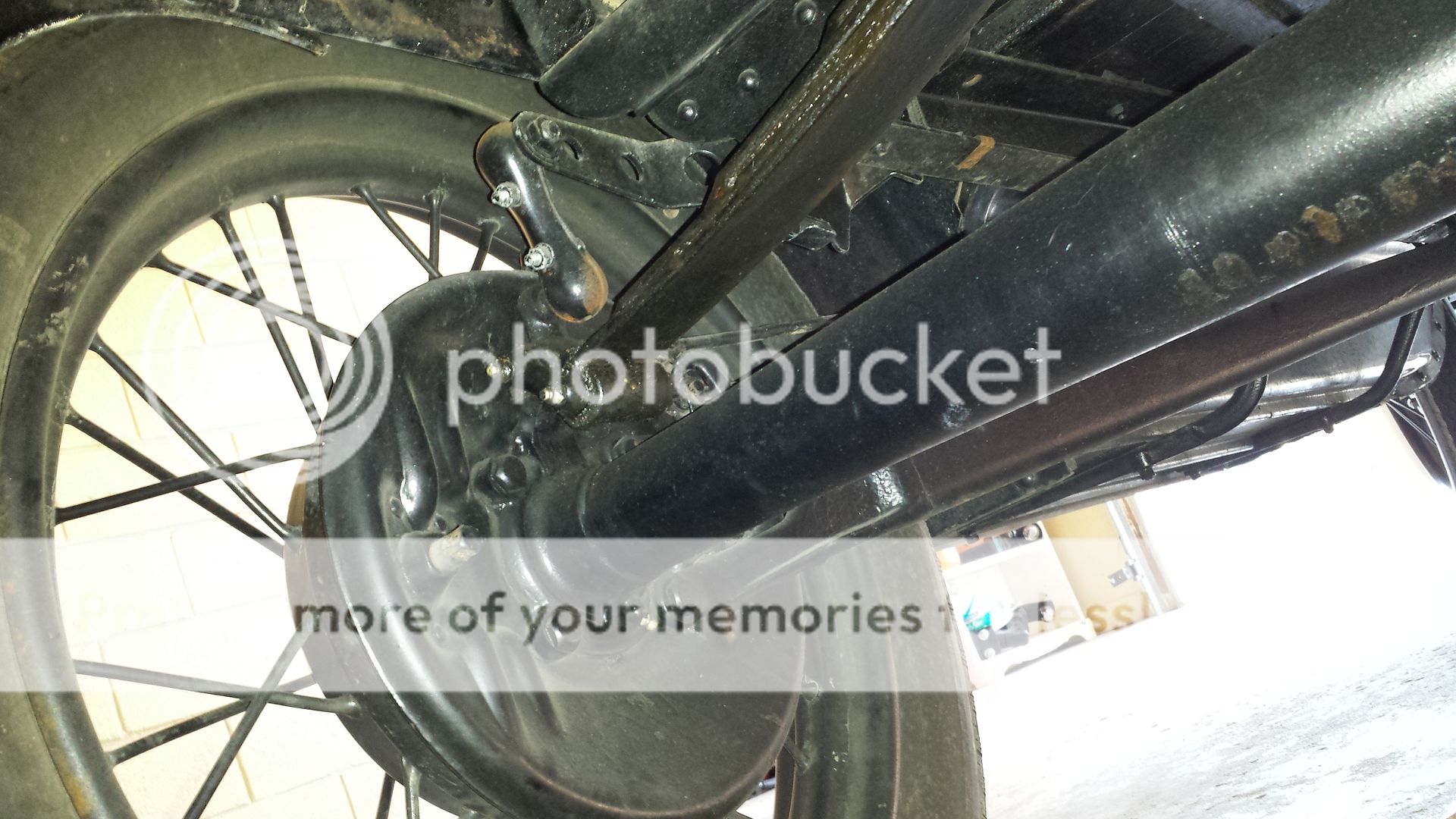

    Everyone keeps saying put juice brakes in it. Are the original brakes that bad? I know.....stupid question but this will be my first A.
  2. i have never gone out to my garage and stepped on the brakes and had my foot go to the floor on my mechanicals
    i have come up to a light and stomped on the brakes and almost gone through it
    but a few clocks of my ford wrench and boom new brakes
    really its up to you if you want to change them out, but mechanicals are reliable if you
    a) keep them adjusted
    b) inspect them tof wear
    tk

    If you are keeping it close to stock, meaning a hopped up banger, the stock brakes will do fine. Keep them adjusted, just like the early hydraulics, and they will be fine.
    I have one with mechanical and one with hydraulic.
    Neal

    Shane,
    I drive my original 30 coupe alot in the summer time. And to answer your question, Yes original A brakes are that bad!....By todays speed limits you have to really be on it to keep from getting run over in traffic. And those old brakes don't work worth a ****!...Regardless of what anyone tells you in todays traffic they are not very safe......You can only push that pedal so hard!...(hell you might as well be draging your feet..LOL) the link rods get out of whack which causes one brake to work better than others. Bottomline is guys do not go through all the work and put juice brakes on their model A's because they just don't have anything better to do....LOL. However I have not changed mine yet and have been driving the hell out of it.......But have had a few close calls and have had to stand on the pedal with both feet!...LOL

    Plus if you wanna put a dropped axle under it...juice brakes are almost a must. Elrod put one under his coupe and still used mechanicals, but it was a lot of fan and planning.

    Mechanical brakes *can* be just fine except it takes a mountain of work to keep them in that condition.
    Mechanical brakes are so unacceptable that the Antique Automobile Clubs will not deduct points if your perfectly restored car has hydraulic brakes.
    Lockheed brakes are not much better. Go with self adjusting Bendix brakes

    Drove my mechanical brake Model A cabriolet up and down the blueridge parkway with no problems at all. Stopped on a dime going down hill in a row of other antique cars. Mechanicals work great if the parts are not worn out and they are adjusted right. The reason why they don't work in peoples cars is that they are still using the worn out parts that were in the car in 1930. You put new mechanical parts in the brake system and your car will stop. One reason to find a local Model A restorers group and have them help you learn about your car. They also usually go on driving events with their cars rather than park all day in a parking lot shows.
    I've got both stock Model As and the Hotrod Model A. I usually do some modifications to the "stockers" like a 39 trans, overdrive, air conditioning, f1 steering, 12V, high compression heads, etc but I've always worked on the mechanicals until they worked.
    The hotrod got Lincoln brakes because that was the hot ticket in traditional rodding and I wanted to make the conversion.
    Ive always been surprised that hotrodders will go through all the trouble to make the conversion, but not spend less amount of time adjusting what is already there.
    Anyways, have fun with the car today! Feel free to reach out to me if you have any Model A questions! :)

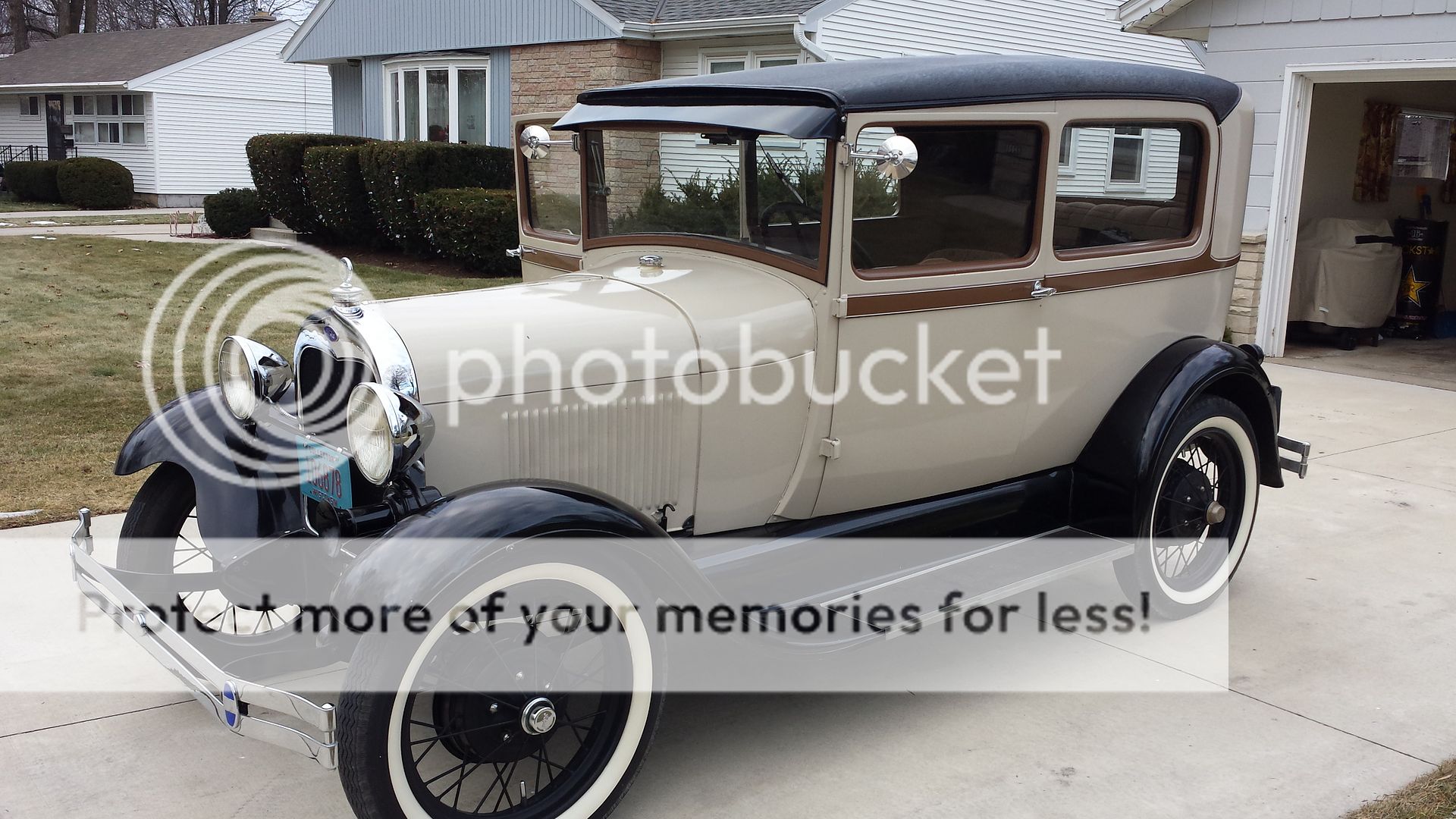

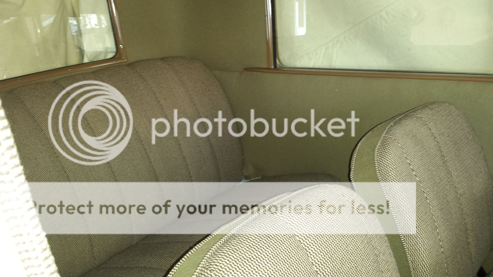

    I did it! I am an A owner!
    Just need to get that dam seat back about 6" ! :cool:

    Turn the seat legs 180 degrees...that will give you a couple more inches of leg room...or Mac's, maybe other A parts suppliers, have 2" off set legs available.
  20. FORDY 6
    Joined: Oct 8, 2002
    Posts: 1,570
    FORDY 6
    Could also fabricate a pair front seat legs...nice car!

    Thats a great little crate!

    Real clean Tudor. That thing is gonna rule!
