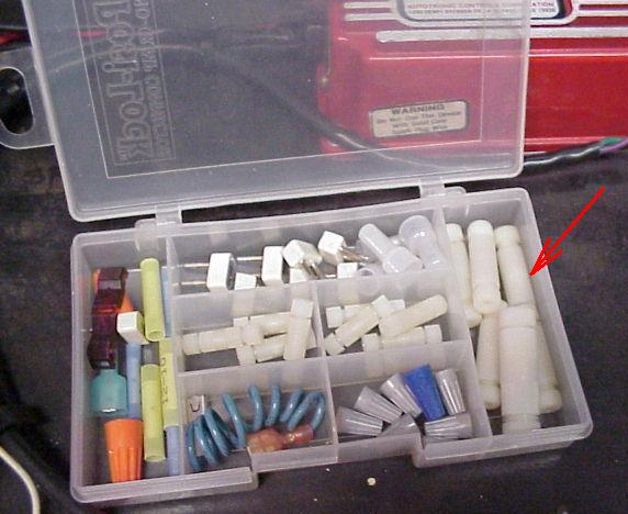

    Buy plenty of heat shrink. Soooo much nicer than seeing unfinished terminals and reduces the chance of electrical jumps. And remember to put the shrink on before terminating. [​IMG]
    And a neat trick, especially for those running SBC's. Put one of these little guy's on the small wire. Simply unscrew this instead of obliterating your hand trying to remove the small nut from the solenoid. Use anywhere you are removing the item constantly.
