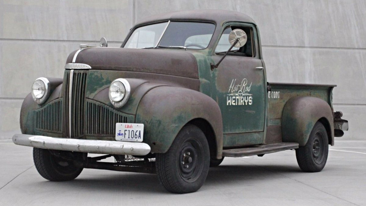

    Ill be picking it up in October on my way back from the grm challenge. Friend of mine in Florida is keeping it for me.
    Anyway, before i cut the thing up, is there any reason why not? Rarity, serious collector value, etc?
    If not....
    My plan is mostly traditional custom style. Which means a chopped top and channeling. I have to build a frame and floors anyway.
    Anyone have any info on lowering the lids on these? Having not seen one in person EVER, im not sure just how curved and involved the windows will be. Or metal. Dont want to build something that will never be completed due to gl***......

    I think they would look better sectioned in the middle instead of chopped. They look fat, top looks good. Maybe cut off the bottom below the door?

    Your gl*** is all flat(no need to sweat about "curves") These are Very lightweight vehicles : back when the CA DMV required weight to figure license fees, I took one across the scales at 2205lbs (no bumpers or spare, 5gals gas, but had a Y-block Ford & T-85 trans). With an aluminum engine/trans/aluminum wheels/radial tires/aluminum radiator/etc shouldn't be too hard to get one of these into the 1600/1700lb range(makes one HELL of a "Sleeper", especially when the sheet metal looks fairly "original"!)
    283john and osage orange like this.
  10. ^^^^^^^^^ Exactly! Swept windshield, lower top proportionate to the rest of the body, and a cavernous engine bay can make this a powerful sleeper. I like those '48ish Studes, and the year later, too, which is a totally different look. 128.JPG 129.JPG 129.JPG
