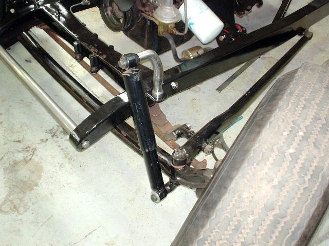

    So i took the bolt out of the other side and again, it was about three threads holding it...Wouldn't think this would have anything to do with it shearing but way too short....Replaced them both with one's a 1/2' longer.....Also, because the bones taper in towards the back, the bolt heads wouldn't sit flush on the bones....So i took a milling bit the diameter of the head of the bolt and milled out about a 1/16th on one side of the bolt hole so now the bolt sits square on the bone....Also, when trying to put the bolt back in i had to disconnect the rear of the bones and draglink and adjust it so the axle would move back at least 3/8"s of an inch just to get everthing lined up so it also had to be bound up {pushing foward}....Took it for a quick ride and it actually felt like it steered a little better, so maybe the axle was sitting in there a kittle ****eyed
    Now it's a lightweight car with the front axle at least a foot and half out in front of the crank pulley so i wouldn't think there is a lot of weight on it compared to if was sitting directly underneath the pulley but i could be wrong...

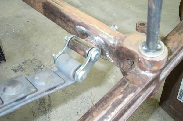

    I don't know if I'd trust that set-up once around the block. 1/2" bolt is pretty small there...would you trust a 1/2" diameter front spindle?...they're holding up the same weight. Then there is the issue with bolting through that wishbone, if there isn't a sleve in there it's just hollow and you can't be tightening that bolt nearly enough. Another problem I can see is that as the suspension moves up and down that shackle is going to want to turn a little to adjust for the caster change...which could cause that bolt to turn itself out.
    I'd redo it NOW. At the very least weld those hangers to the bones in addition to the bolt.

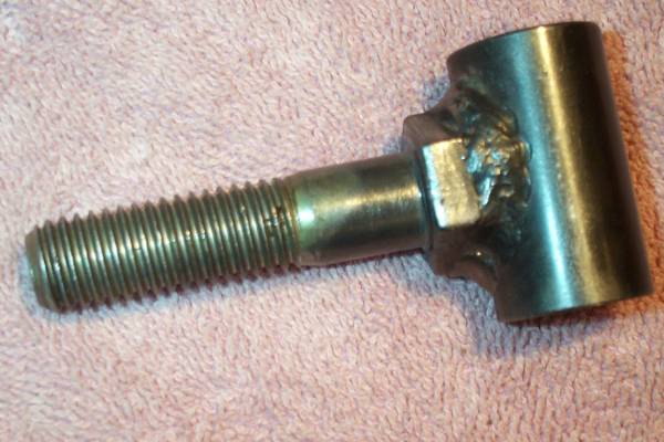

    RR Eddie, Loogy provided some good info. Also I believe that you have solved some of your problem with your spotface and also a longer bolt.
    If you can give me a couple real good pics of the fracture surface, I can try to give a metallurgical explanation of the failure.
    The biggest issue I see with your set-up is that your bolt is essentially in single shear with an added bending load. If you can provide some additional support like Flathead's, it will help tremendously.

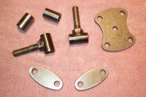

    EDDIE, What I did was machine a bung from 1" o.d. 1018 steel. It is long enough to go through the bone. It gets welded on both sides to ensure the bone is strong. It has 5/8 fine threads in it to receive a spring mount from Speedway Motors (the one you would use for spring behind axles with batwings). I use that with a jam nut. I have good thread engagement (the whole thing). I ran this set-up all summer and have about 1000 miles on it so far with no problems. And I don't drive like an old lady either. And I don't not go somewhere cause the roads are too rough. I live in central NJ, the roads ****. Looks like you could use my set-up with a little work and few $ in parts. If I had any brains I'd post pics. but I can't. It looks like your relying too much on the bolt head in your set-up. I could machine you set of bungs and mail them to you. or you could bring your bones down and I'll tig weld them in too. I'll PM you my phone #. MIKE.

    The hole is going through where the front piece of the bone is slid in and welded through the main section....It's going through both

    Ideally, since the bones move in an arc, the perch bolt (if it is going into the bone) needs to be able to pivot, since the spring eye can't turn in the same arc. Somethings' got to give!

  23. I had renowned hot rod fabricator, drag racer and fellow HAMB member Bob Hindman make up a set of perches for my Model T sedan project. They use 5/8" grade 8 bolts and run through sleeves in the wishbone. I put a lot of effort into ensuring the perches, shackles, and spring were in perfect alignment and free to rotate on axis.
    Bob does not charge much for them. Sometimes you need some help from a pro.

    Bob appears to do them right.
    The way the failed ones are made, any looseness in the ***embly will allow bending forces to overstress the threaded part of the bolt.
    A 1/2" bolt is only 1/2" in the shouldered area...not thru the threads.
    If maximum available strength is the requirement...then the failed one is fabbed backwards...causing the bolt thread itself to become a stressriser.

    BibOveralls, I hate to rain on your parade some, but the welding doen on that bolt to the sleeve has reduced your bolt down to less than grade 8. Or whatever it started as. The welding causes the heat treatment in the bolt to be messed up, it loses strength, because you are essentially tempering the bolt more.
    Wait for the metallurgy tech series on heat treating and this will mnake mroe sense.
    I am not saying that your parts won't work. Just that I have some concerns. In addition to your welding heat affects, I also see by your design that ALL of the load and stress is going through that weld on the sleeve. Hope you have good confidence in that weld, as it is holding everything up. Once again, I am simply making observations based on a small amount of pictures and data in your post.
