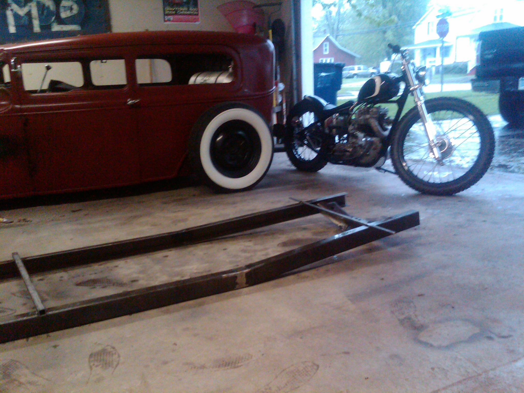

    I just started on a new chassis for my sedan. Right now the car has a 114" wheelbase and rides only 5" off the ground. I want to give it more of a hot rod look so I'm shortening the wheelbase to 106" and losing the 17" Z in the back. I will probably Z it only a foot or so to actually give the car a rake instead of sitting pool table flat.
    I'm also losing the 3" Z up front in favor of a sweep. Instead of a tubular front cross member and a spring perch I'm going to use a stock Model A crossmember. I plan on the chassis stopping at said cross member ala Doane Spencer/Rolling Bones setup and retaining the spring behind the axle setup I'm already running.
    Last night I pinched the 2X3 .125 rails to taper from the body width to the front cross member width. Then I made a .25" pie cut on top of the rails, behind the pinch which raised the front of the frame 3" off the ground which is pretty much what I wanted.
    Here's what I'm not sure of, do I make another pie cut on the bottom of the frame rails behind the cross member and bring that area down so the end of the rails where the cross member sits are parallel with the main, unswept rails? Or do you just leave it and not have to tip your cross member back so far to build in some caster? Or am I already in over my head and should probably scrap the whole project?:D
    Thanks, Scott

    Keep with what you're doing Scott, Since you plan on running with a rake instead of level, the differance in the sweep will be compansated. Same set-up I ran on my 36 Dodge roadster.

    Well I've had fun with it for three years and I'd like to change it up a bit and make it more drivable. Troy, are you saying leave it and don't do the second pie cut? Thanks, the bike is a 750 Triumph from Atom Bomb Custom in VA.

    yes.....dont do the second pie cut.....that would bring you back to level.

    I've see several that have the spring mount at an angle like that and I don't like it, it's just not a natural movement for the spring when it's all mounted up. I'd make the front cross member flat or 0˚ at ride level. Put the spring at 0˚ and adjust the mount to the bones to compensate for your 7˚-12˚ for the laid back axle so it'll track correctly.

    Correct...I guess the question is, Scott, how much rake to plan to run? My setup was 108" wb, 3" sweep with 6" of rack and the caster was within spec.
  15. Since you are not going to run frame horns, you may be able to get away without the
    the second pie cut; but I think it would look better with it. The crossmember would be
    mounted in a better relationship to the rails and it may help to alleviate some of the
    "broken" look of a swept frame. Just my opinion.

    What about leveling the end of the frame rails with a second pie cut. Then taking a little bit of material off the back of the cross member so I can tip it back inside the rails to build in some caster? Probably 6-8" higher at the rear of the frame as far as rake goes.
    Also, I don't want the front so low that I have to run the tie rod out fron like I'm currently doing on the sedan. I know figuring that out is quite a ways down the road but that's something I want to avoid.

  18. I just went thru this and it can get a bit mind bogging
    Set your frame at ride height, or at least the intended rake.
    That's going to put the front swept part closer to level
    Set your crossmember according to your spring perch arrangement.
    * If its spring on top with solid perch set it at 7*ish
    * if it has swivel perches (sot, or sbh) set CM at what looks and fits best.
    Pie cut it if think it looks better
    Both Spencer and bones use a stock 32-36 axle.
    If your going Spencer, there's a z at the front just before the radiator for the crossmember. Again depens on the spring arangement. You can put everting level, flat, or, 7*. That z can be flat w 7* crossmember or have 7* in the z and crossmember flush with tube.
    If you use batwings and spring behind with hairpins you sort of get the swivel perch because it bolts on.
    rolling bones do it a bit different with a big notch just before the radiator. That style crossmember is different also. That I can't really tell you much about other than swivel perches bolted thru on the wishbones makes that set easier.

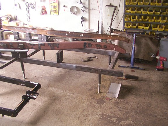

    Bring it back level. If you use a stock or aftermarket crossmember they have 5-7deg built into them so that when you set your axle at castor the spring won't bind. If you come back about 8" from the rearmost side rivet of the front crossmember and do your 2nd pie cut you'll have about 3.25" drop built into the frame (thats assuming you made the 1st cut near the firewall.
    I think this pic show one rail with that cut and the other uncut.
    Hope this helped. One thing i'd do is toss that 2X3 stuff and get an old model 'a' frame - theres bunches of them out there. They are a whole lot of work to get right but there ain't nothin better.
    Good luck, oj
