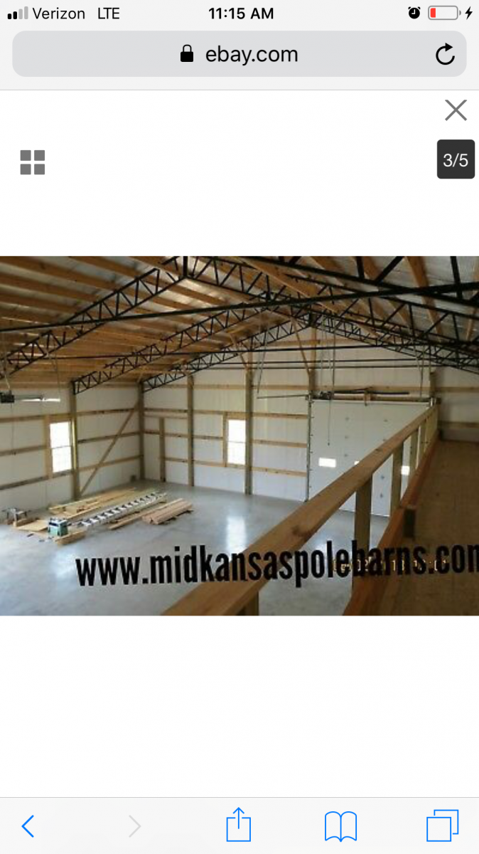

  4. Went thru a bunch of research on this not to long ago. While looking for property we found a place that had 8200 of building already up. So we bought that and I’m making it work.
    If I were building, I’d go with this style roof truss structure for sure.

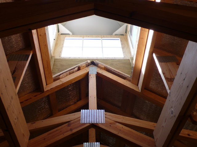

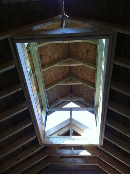

    Open and closing coupula. This was the antique form of AC . It Worked then and still works now, add a ceiling fan and it works better.
    6411CA95-863A-4F9A-91E7-1F920F9885C9.jpeg AF9A103E-B0D0-44D4-9F6D-29231056BB2E.jpeg
    Wide Doors on gable end are much easier and cheaper. You could open the whole damn wall. And if the trusses pictured above are used you can get a 16’ tall door into a 12’ tall building.

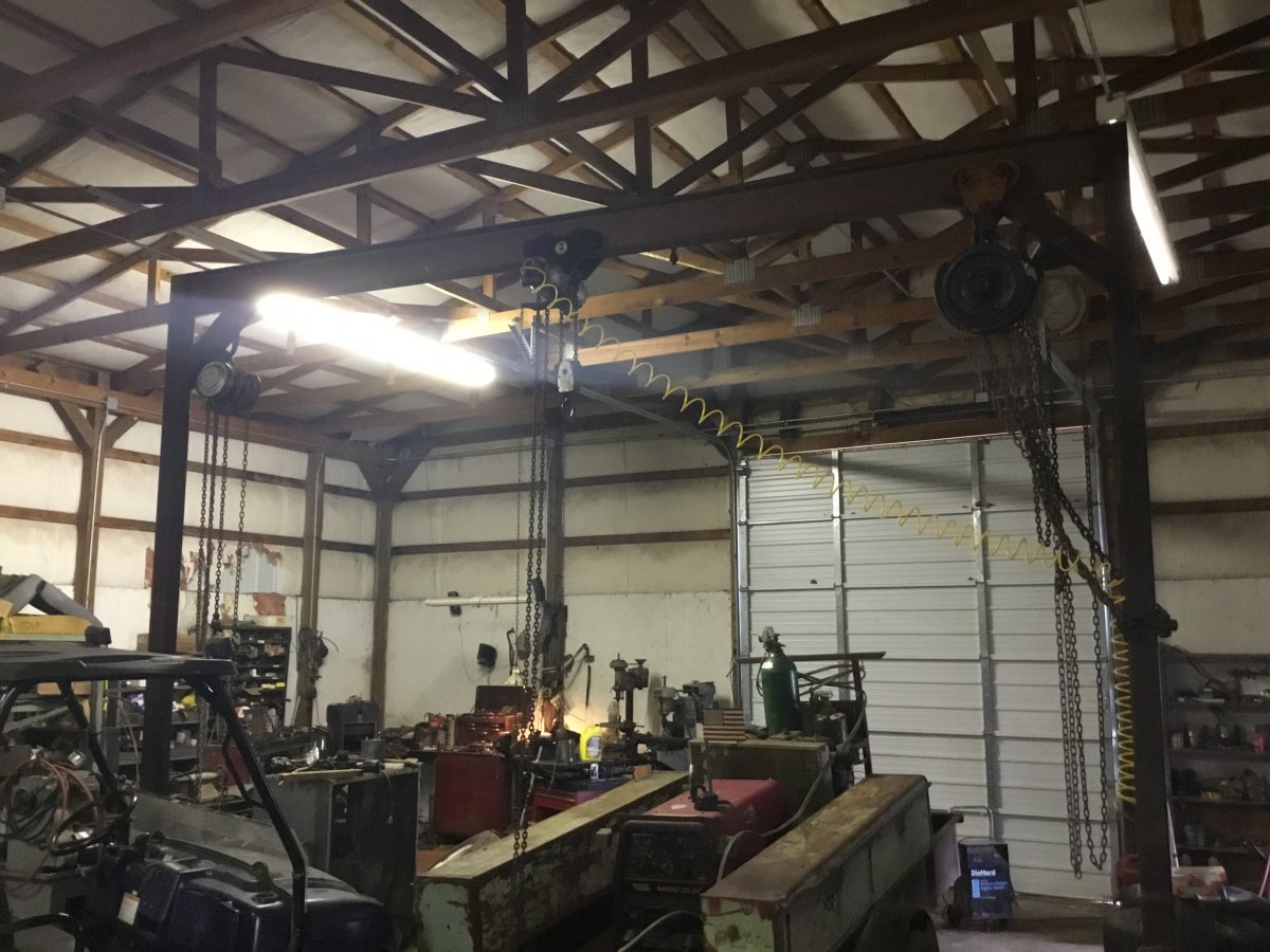

    Kinda like this, we also painted ours white to reflect light better, we went up eight feet. We did this years ago, kinda dirty now!
