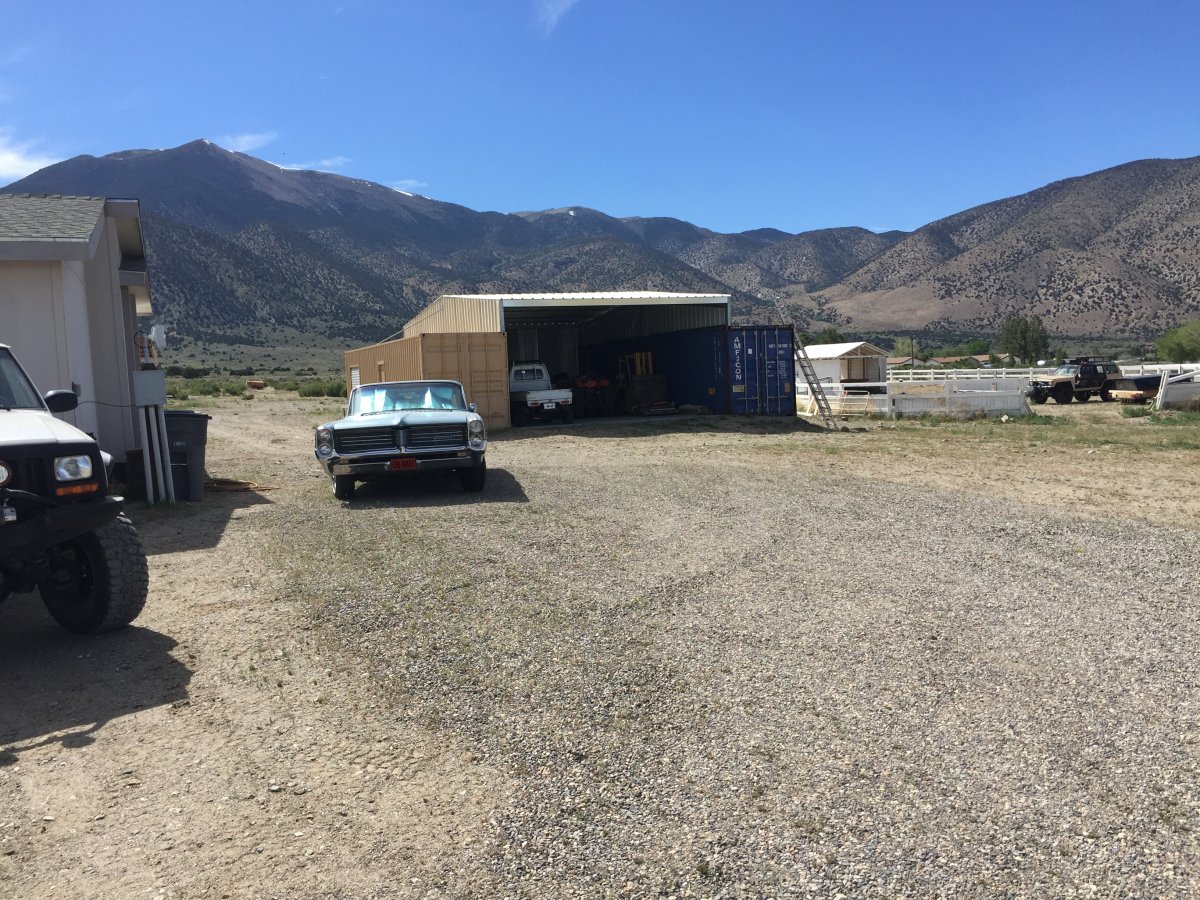

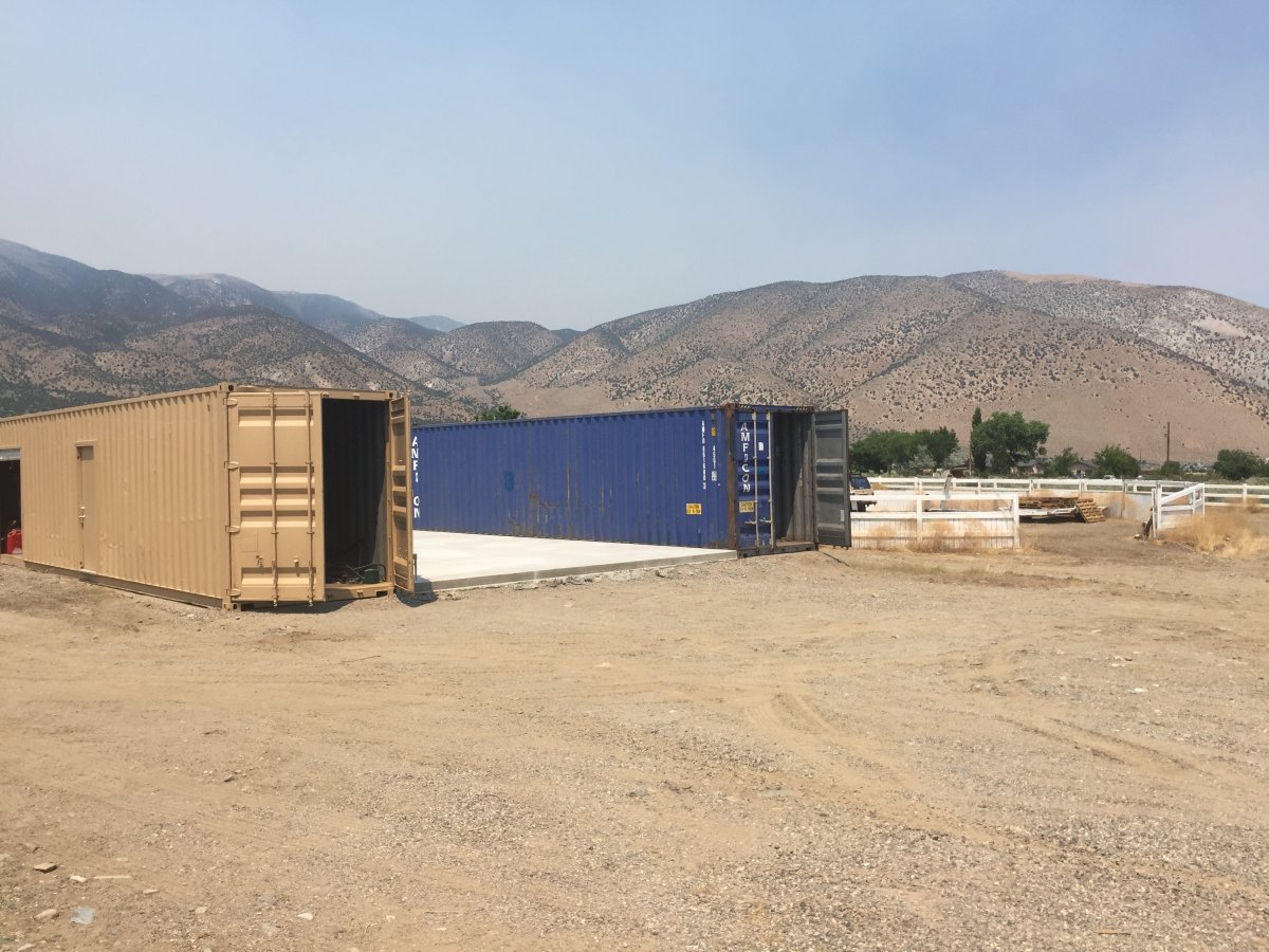

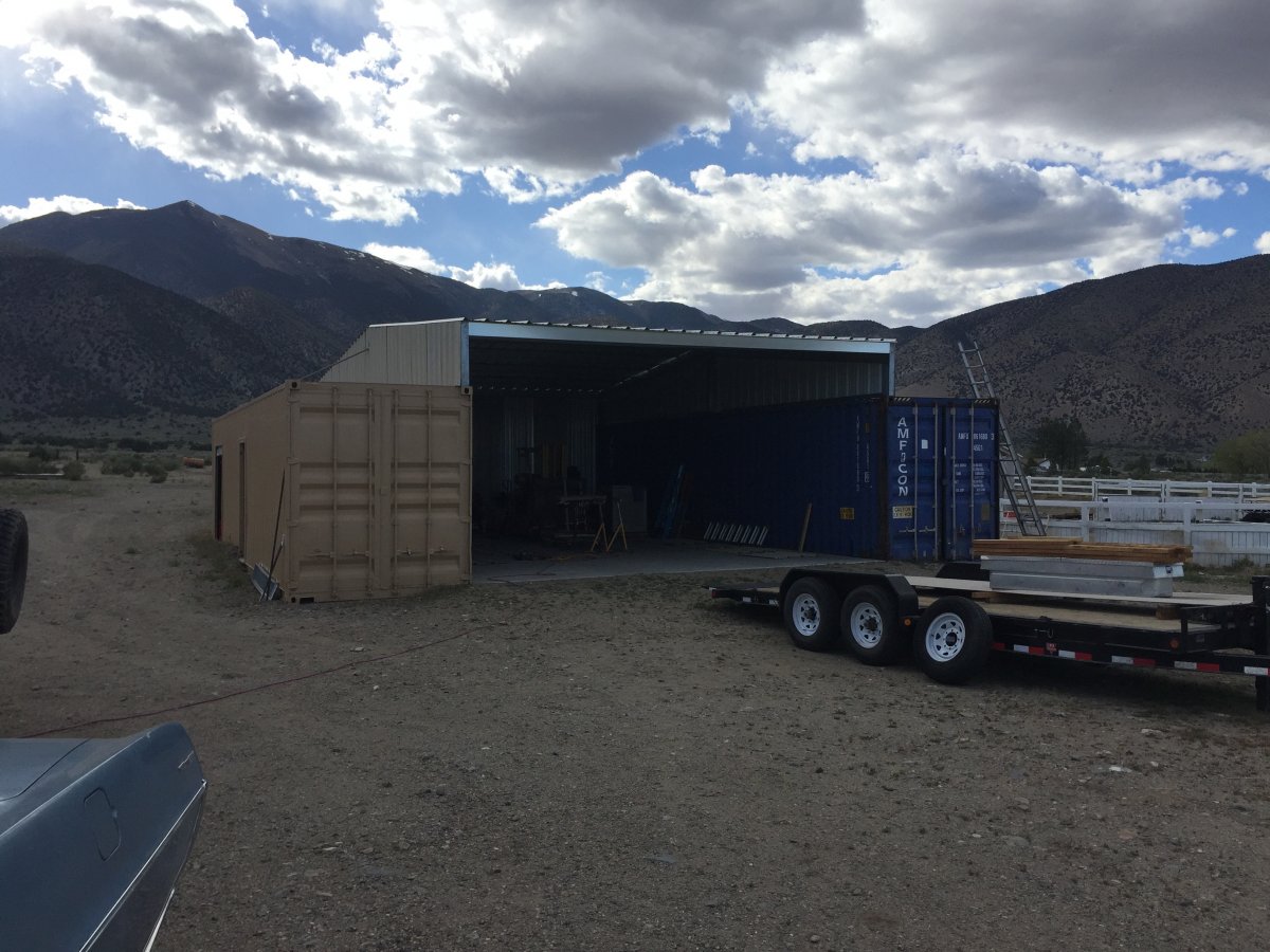

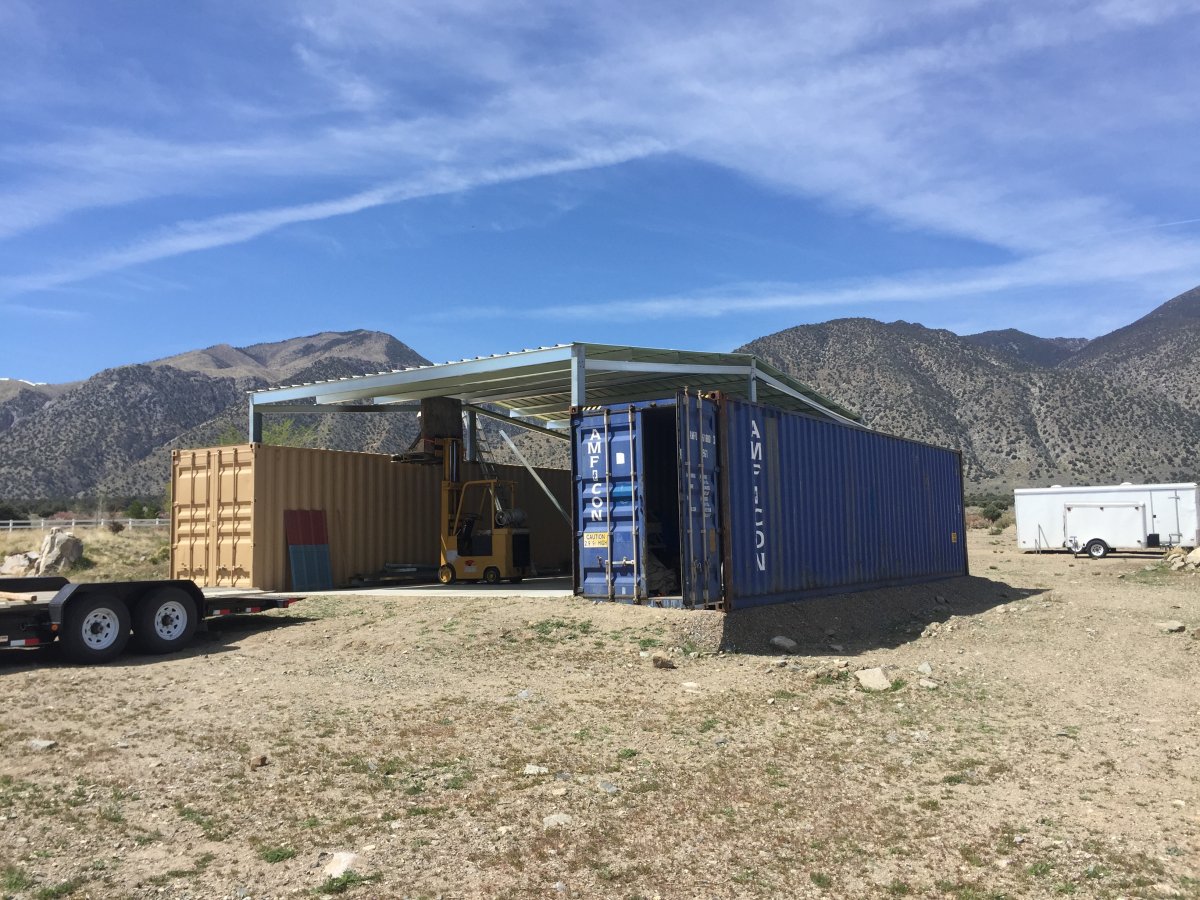

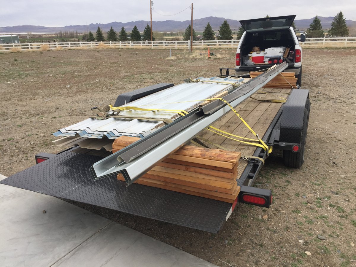

    When I retired I wanted to build my "garagemahal", a huge shop with all kinds of equipment. Then I realized I really didn't need that much and would rather spend money on cars than the shop.
    I bought a place on 5 acres with no garage at all so bought a couple shipping containers for temporary storage. Then decided to build this. Ground was prepped, containers set and a 6" slab (24' x 40') poured between them. The floor of the containers are even with the slab so I can roll stuff in and out. I've cut out a couple openings in the container but still have to cut out a couple more.
    I built another smaller garage just for parking cars and will build a few more small one car size building for completed cars so that way the shop is used only for working on stuff and not storage. I keep all tool boxes, equipment, work benches, parts shelving and other stuff in the containers and try to keep the slab open (hard to keep from cluttering it up though).
    I just picked up a QuickJack and will also be installing a two post lift. I'm debating the placement of the lift between in the center or to one side of the slab as well as the front door configuration. One single center 16' wide door (I'd like to do sliding barn doors) or tow smaller doors on each side. I'm leaning towards installing the lift all the way to one side so it will take up less room. If I do that then I'll probably go with two smaller doors (one 8' and one 12') so I can drive cars straight on the lift without have to jockey them around.

    How hot do the inside of the containers get in the summer? I ***ume you keep tools/equipment/parts and stuff in them? I like that :)
    I bet if you put a second roof over the entire thing, with a few feet of air gap inbetween that and the existing roof/containers, that would help out alot with heat :)

    Looks good! How did you address the rain runoff on the containers?

    The tan container on the south side is insulated on the inside with 2&1/2" polyiso rigid foam. I may build a sloped roof over the container though and extend it out over the edge about four feet for some extra shade.
    I have a swamp cooler for summer and wood stove for winter.

    Also,,,being in Nevada,,,and judging from those sp****ly covered hills in the background,,,probably not a ton of rain there I guess. ?
    Also,,,plenty of room to add more if needed.

    Thanks. The containers were set level so I get some pooling of water but because I'm in northern NV at almost 5K feet elevation it is very dry and sunny so it evaporates off pretty quickly. We don't get a lot of precipitation here. If I were to do it again I'd probably slope the containers an inch or two to the outside. Because I just use the containers for workbench and storage the slope wouldn't be noticeable.

    Yeah, not much rain/snow here. I removed the corral on the north side so I can expand from the blue container side.

    You could, when you are not doing anything ( insert laugh here) put the sloping roof on both containers and cut the existing side wall and create another place to store long skinny stuff, such as drive shafts, chrome trim, boards, stuff like that on top of the containers, while reducing the temperature!

    That was my thinking. I'd cut out a couple doors because the metal panels are actually structural.

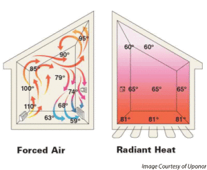

  26. Damn right it hotter up higher. And hot air kinda ****s.
    Rising heat needs to be dealt with. In the summer you want it to escape. Cupola or high Windows just under the rafters. Monitor style roof with windows on the barn is the old way as well. In the winter you want to capture the high level heat. That’s where the r49 ceiling insulation get mentioned.
    In my former shop 21 foot ceiling I had a nice Reznor heater that did well. At ear level the temp was 65, up stairs, or on a ladder it was well over 80 and on the mezzanine in the corner it was always 90 while the floor was 55 at best usually colder in a typical Ohio winter. We usually get a few weeks of double digit below zero and it never shut off. Ceiling fans helped some but I’d say minimally at best. That 80 plus temp costs money to make and is in the wrong place. It will go right out the roof without insulation and the greater difference in temp between inside and outside the faster it goes.
    If the temperature differential (delta T) is less then the heat transfer (escaping) is slower. The sun pounding on steel roof or siding will get it to over 125 surface temp. The hot air rising is stopping at the deck where it’s even hotter so it doesn’t rise anymore. The air gets heat soaked and stifling.
    Here’s the thing about insulation and heating, your goal is to capture the heat however any heat that’s escaping thru must be gotten rid of quickly once it’s beyond the insulation. In the summer you can condition the air and capture it while preventing radiant heat gain or simply allow the heat to escape via natural methods. Without an escape the heat will continue to gain. Without delta T the heat will stay put and with delta T the cooler side will **** the heat up.

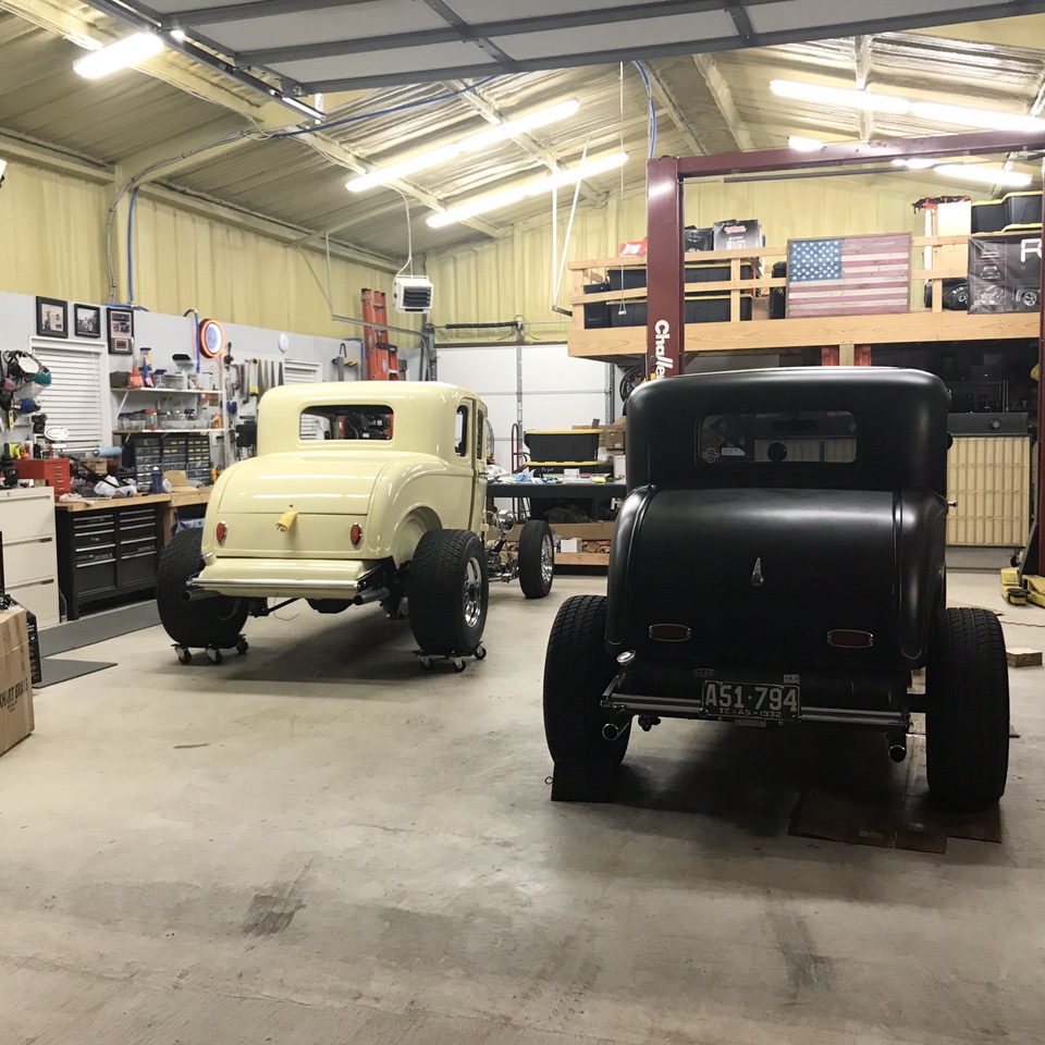

    You have had some awesome suggestions in the replies. I finished my shop about 1-1/2 years ago. Things I love, more outlets than you would ever need, bathroom with a “laundry tub” deep sink in vanity from Lowes, covered entrance over from main door, outside GFI outlets and water hose outlets, closed cell spray in insulation, roll up doors both ends, out back is a 30’x 8’ slab for dirty work and ventilation thru the shop. I agree with as much lighting as possible. My building is on 30X40 due to the HOA nazi’s but I love it. I put in a two post lift so as to not interfere with floor space, I did a loft with staircase for the wife’s stuff. I also mounted several of my dirty tools on a roll out work table to use out doors, built a large rolling work table with a carpet top when working on doors, or large body pieces. No 80” TV, but did do a 70” and awesome stereo system. Windows on 3 sides, security, automatic dead bolts on roll up doors than electrically lock when the door goes down, so I never forget. Mounted heaters from the ceiling to take the chill off( inexpensive Northern tool)
    Here’s some photos from south of you. IMG_2031.JPG IMG_6283.JPG IMG_2123.JPG Adjustments.JPG

    Heat rising to the ceiling was an issue in my shop with 14 foot ceilings in the Minnesota winter. Ceiling fans are a ****py solution in the winter. When it's cold out and your trying to warm yourself up, you don't want a breeze blowing on you. The solution is an airdrop. Get yourself a piece of duct 8 to 12 inch diameter, put a duct fan in it, and mount it vertically so it draws air off of the ceiling and blows it out on the floor. They work great to equalize the temperature from floor to ceiling. Without creating a significant breeze
