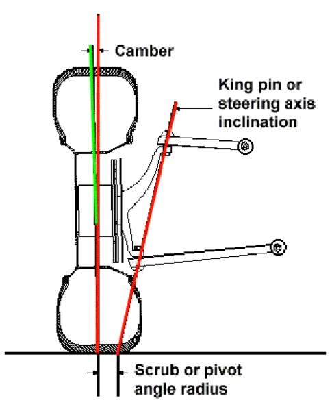

  11. How’s the geometry on your front end?
    I’m talking nit picky stuff. Roll centers, right toe, left toe, total toe, scrub radius, gross difference in shims, ??
    Shocks?
    So a wheel shake problem
    the shake starts at a very specific road speed.
    If doable the 1 2 3 gear makes no difference and
    Neutral makes no difference.
    Down hill coat with engine off creates shake at that road speed
    Once the spec start speed is reached going above that speed increases the shake frequency proportionately
    Maybe maybe not the shake goes away at a higher road speed.
    Some answers there will help.
    Going down the road wheels and tires do a lot.
    Wheels go around, so we check out of round. wheels go up and down, need good shocks.
    Wheels want to go side to side, so we set toe. Front and rear yes rear has a toe measurement.
    The tracking is important. front axle to rear axle as wholes and then getting nit picky there’s the left front to right front relationship.
    If tracking is off the tires will flex in the side walls then correct then flex and correct. That flex correct frequency can cause you vibrations. It’s a side ways movement and not what you’d normally expect tires to be doing.
    notably because of your interference at top ball joins right? Maybe you got the problem here . so the common sense correction is to fudge the offset to move the rim away from the ball joint. Doing that causes the scrub radius to move. The sweet spot on scrub radius is 2” and either positive or negative. The correct way to cure the wheel to ball joint interference is to manipulate the King pin inclination angle and that’s really hard to do with your spindles.
    winduptoy and VANDENPLAS like this.
