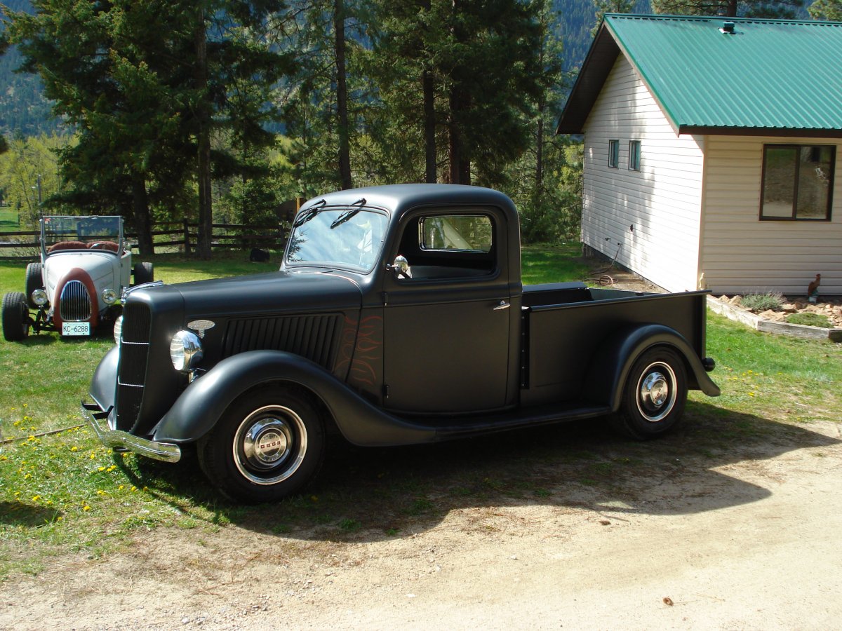

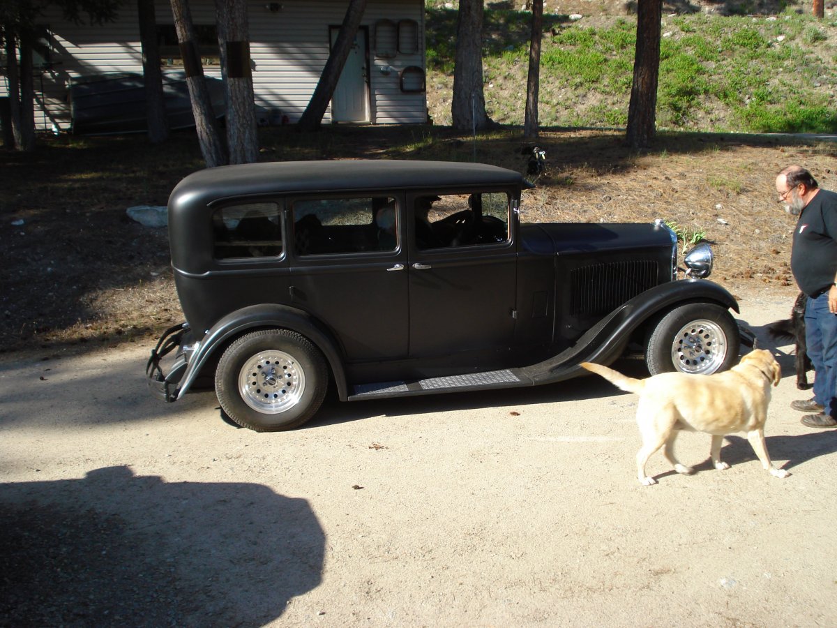

    DSC05918.JPG DSC05895.JPG OK boys and girls, an update. I CANNOT find it, but I'm re***ured that I'm not alone, its got to be a design issue with a stock pinto front end. As posted, I've checked everything, been to a reputable, full of hot rod guys, front end shop, they checked, as chronicled here, and to date have not found it.
    So, today, a friend and I pile into his car, a car I built five years ago, a 29 dodge fordor sedan. He has put 20,000 on this car, with zero issues. Went to Osoyoos, about 100 miles from princeton, where we both live, at varying speeds because the road is thinly populated and lends itself to herky jerking around if you want to.
    The car....stock frame rails, 360-torqueflight, 9 inch ford, pinto front end, bone stock right out of a pinto, non power rack. Very nice car to drive, somewhere around 3000 lbs, my italian friend calls it the lemonzine. He thinks it looks like a lemonzine, so....it is.
    He drove there, and I drove back, he drives with two hands, all the way there, the car was smooth, good drive, I drove home, sometime no hands, and found the shake, dead on at 60 miles per hour, two hands, no shake, one hand, slight shake, no hands very noticeable wheel shake. EXACTLY like my 36, EXACTLY the same results at the same speeds.
    I'm done, I'll live with it, he runs different wheels and tires, car is balanced similarly, both drive awesome, so....I'm stumped. Here is the car, and my old mary. P.S. I'm the ugly one.... View attachment 4811328 View attachment 4811330 View attachment 4811328 View attachment 4811330
