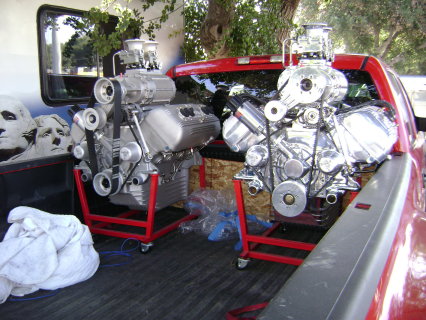

    Just for those that haven't seen this a million times
    The motor that goes in it is on the left
    And if you don't like Chopped 40's SO WHAT! Don't look at it :)

    Now THAT's a motor! Holy ****!
