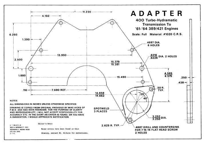

  7. BE AWARE:
    1961-1963 blocks require an adapter to bolt to anything but a 61-64 Pontiac bellhousing or transmission (slim-jim or dual-coupling hydro). 1964 doesn't because the ear for the block mount starter was added. Without this, there is no place to hang a starter when using a newer transmission.
    I don't know if you can scare up a scattershield that will work - the same problem presents, where do you bolt the starter?

    You can buy a starter mounting plate from Butler performance or have your own made with this blueprint. This applies to 61-63 blocks. I agree with carbking a stock 389 will be more than enough power especially for a truck.

  13. Intake manifold bolt pattern is 61-64 only, as well.
    64-up blocks have an ear on the left rear, 64 can have no holes, have holes but not be tapped, or be tapped for a starter. 27P does sound like an early 60s era code. Before mid-59 there is no stamped code, 1960 are two characters, and post 1964 most are two characters.
