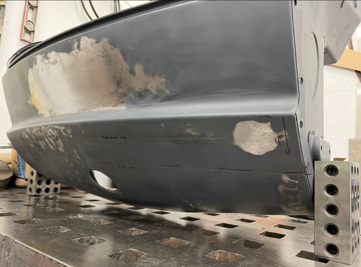

  2. The rear apron is done, and the replacement starts on the front apron.

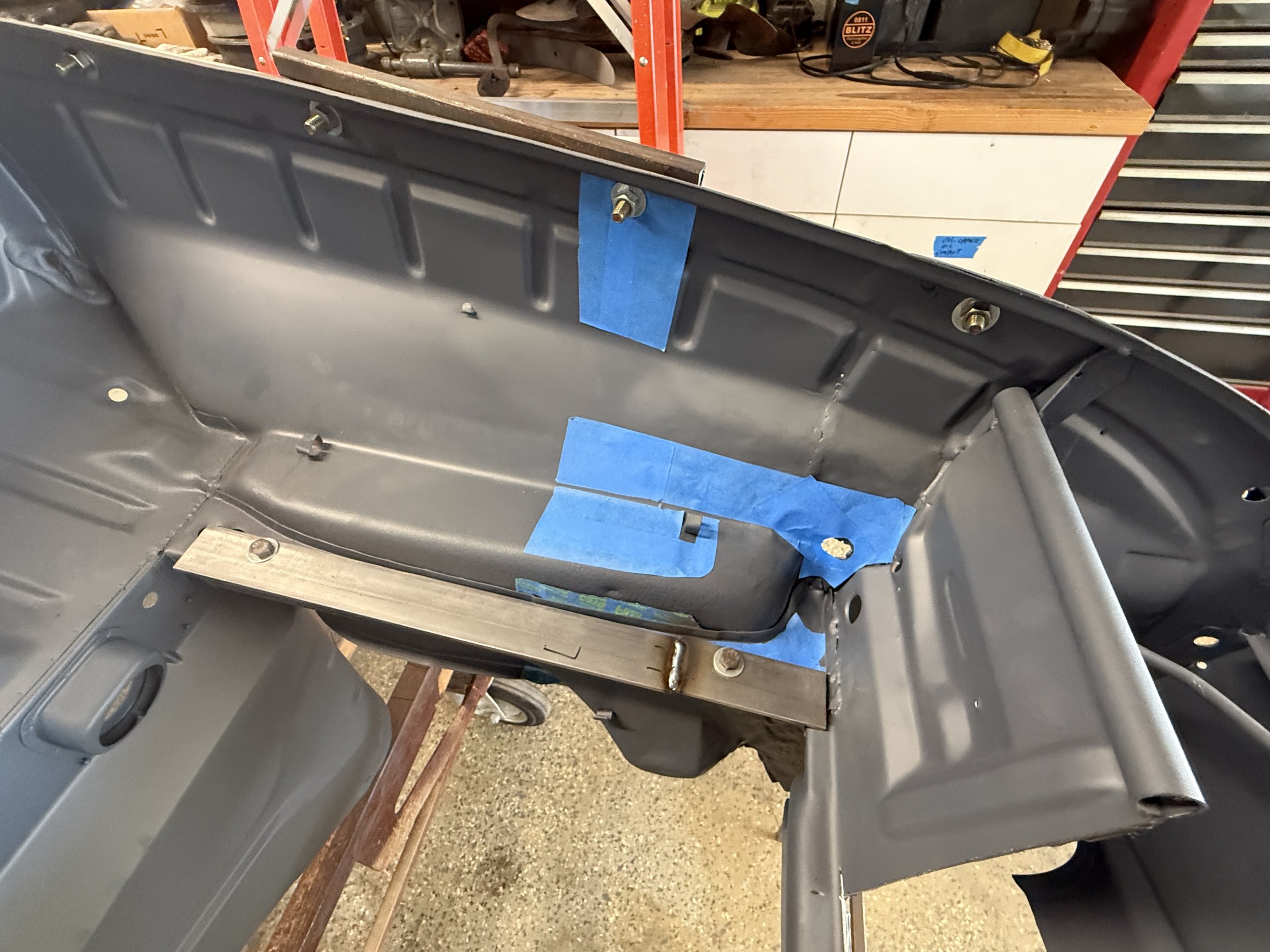

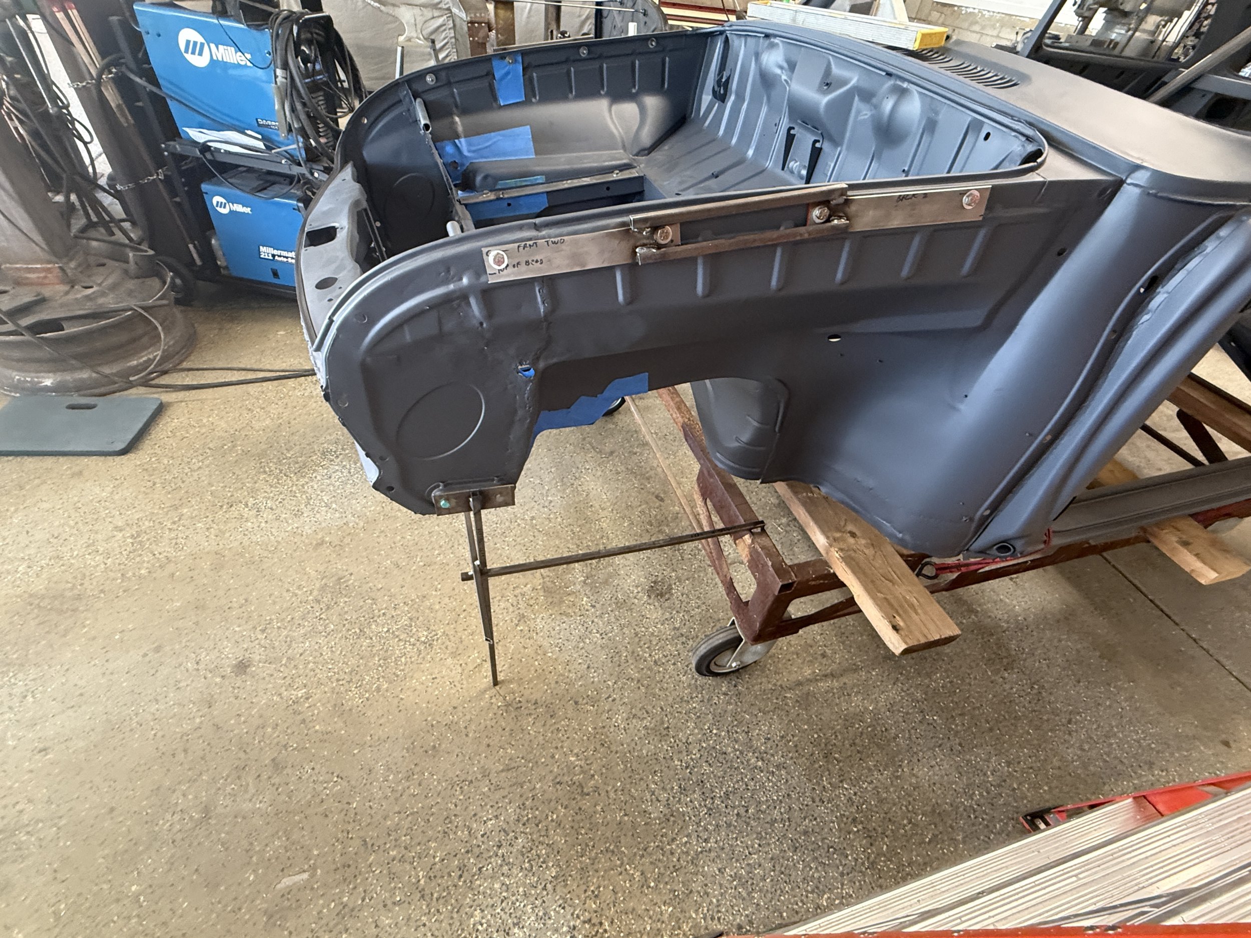

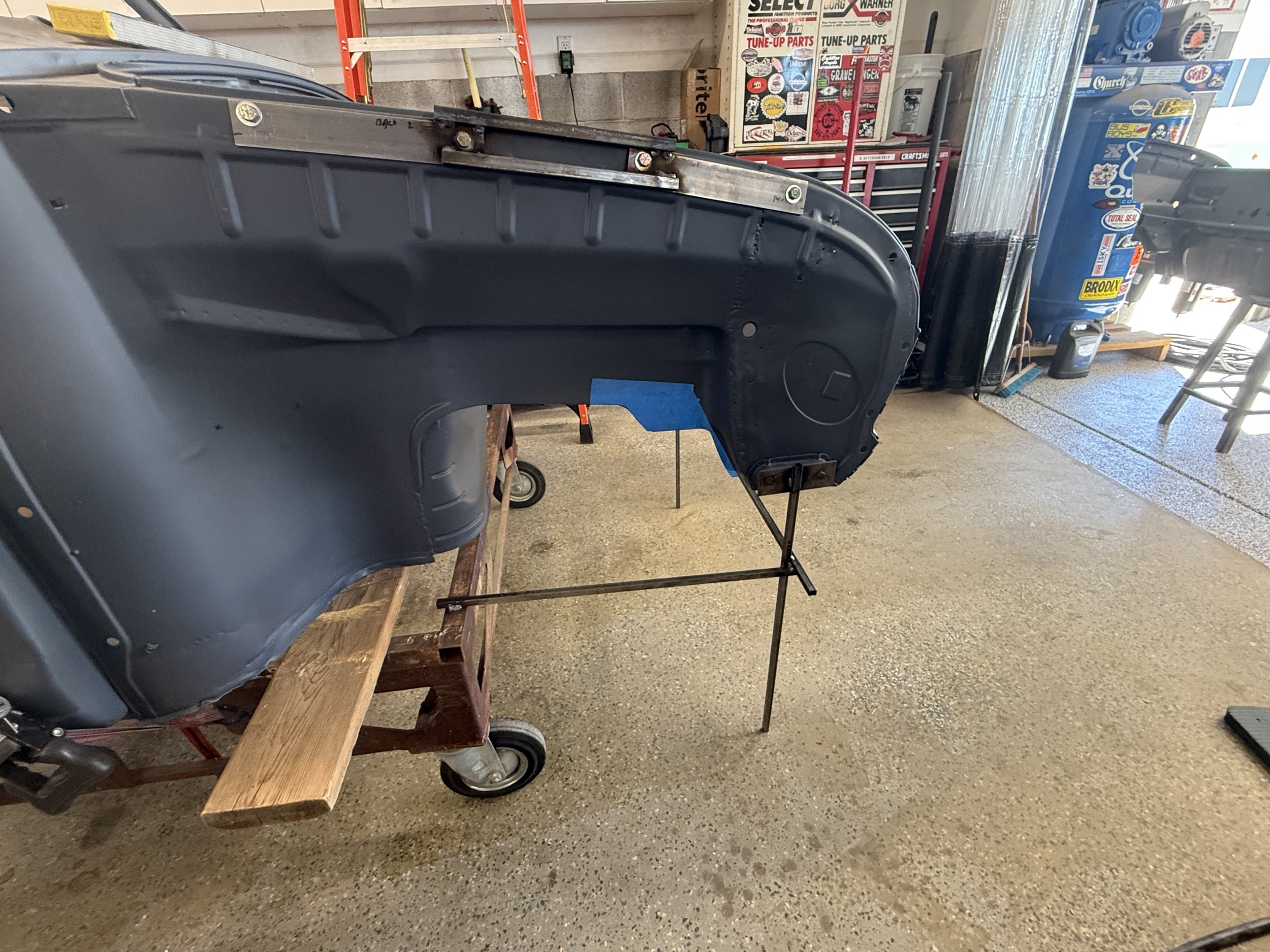

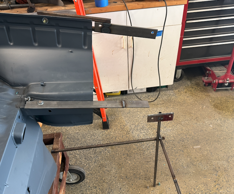

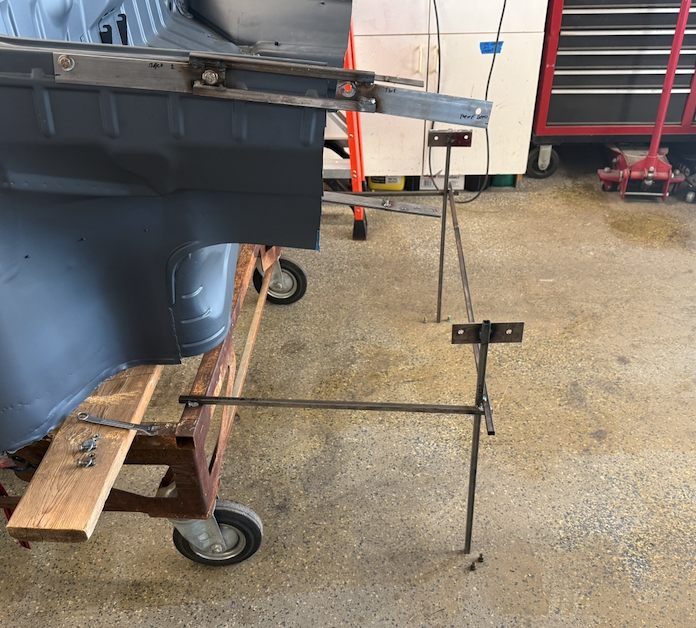

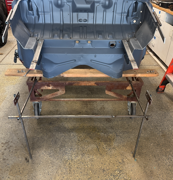

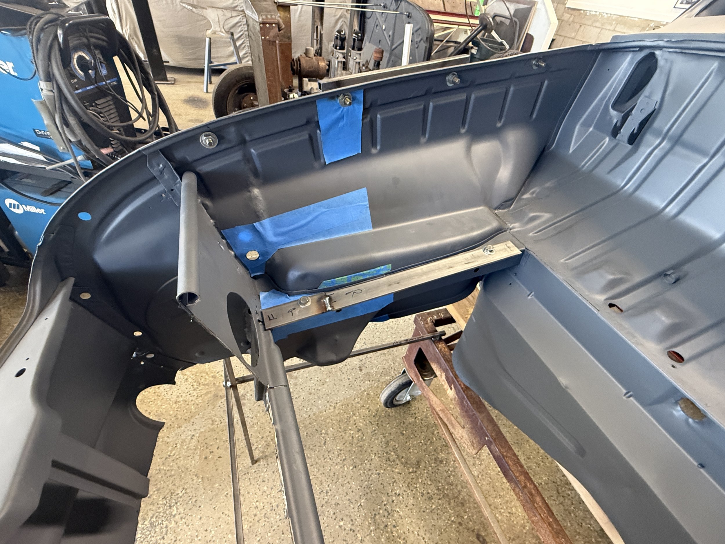

  6. Started on the front apron replacement. Built a jig to keep everything in line. More updates soon.

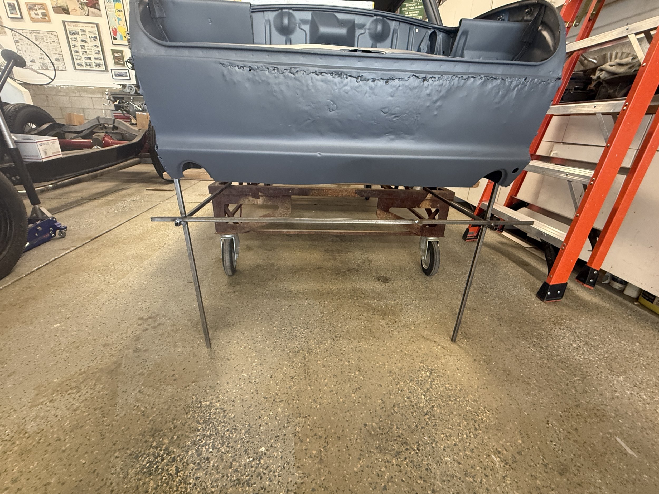

  8. The apron is welded in and finished, and most of the hammer and dollie work and sanding are done. Just about ready for body work. The jigs I made worked perfectly. More updates soon.
