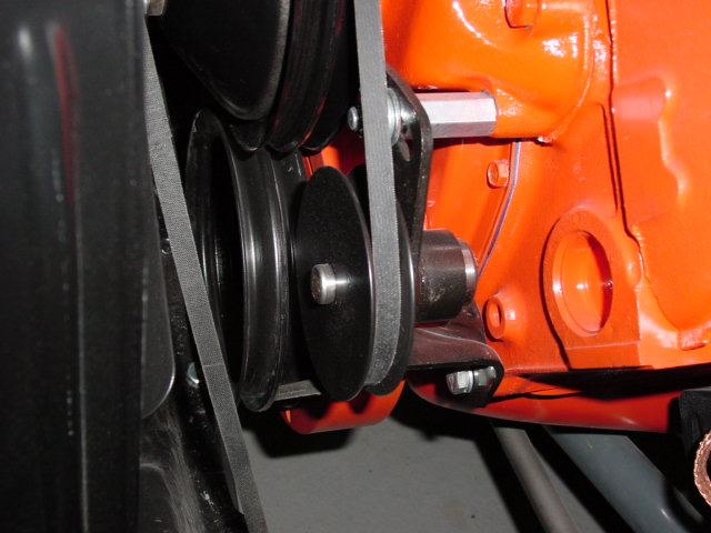

    If you are going Racing with a SBC you might want to consider this...
    idler pulley 1964 365HP - Corvette
    Find more info here..
    <CITE>(forums.corvetteforum.com )</CITE>
    <CITE></CITE>
    Idler pulley 1964 365HP C1 & C2 Corvettes. ... The idler pulley is on these cars to keep the belt from flying off at high RPM's.
