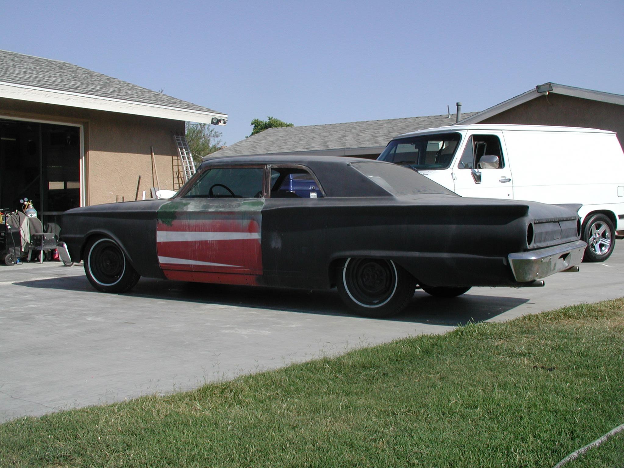

    Can you post a clean side shot of this chop?, I would like to see the profile.
    Nice chop
    Thanks

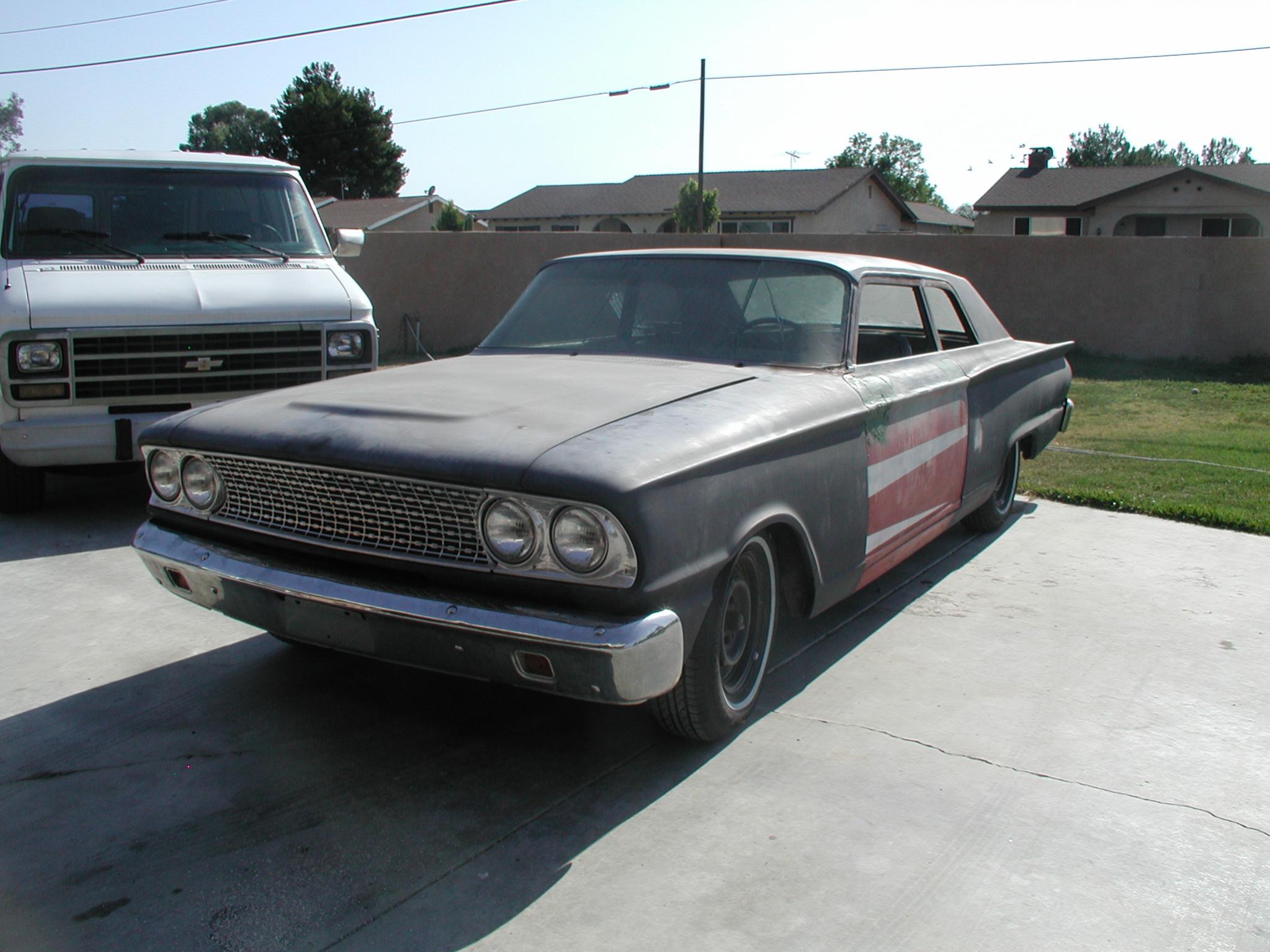

  21. Am I the only one concerned by this? I'd like to see some pictures. I hope I'm wrong, but that sounds like some serious hack work. FWIW chopping a unibody is not something that should be taken lightly. The A pillars & roof rails are critical to the structural integrity of the car. Far more so than in body over frame construction. I'd be looking this car over very carefully.
    And NO I'm not trying to piss in anyone's cornflakes. I like the car, and hope it turns out great. Just damn few people I'd trust to cut a unibody.
  22. pimpin paint
    Joined: May 31, 2005
    Posts: 4,937
    pimpin paint
    from so cal
    Hey Tin,
    This kinda '' slap & dash-blindfold anda dull hachet '' work is typical of '' showcar & movie car '' type builds!:eek: The spec for the build is drawn up, than the Director of Transportation for the studio shops a builder for a price that's in the director's budget. Usually the lowest bidder/biggest ********ter wins the day!:eek:
    It's fortunate that few '' showcar/moviecar '' builds ever make it to the street! What scares me is the numbers of **** welded A & B posts with no pretense of sleeving, I see on this site, as well as still being done in the collision repair today!:eek: Yeah, I wanna bet on a squirtgun weld made thru a sixty year old A Post, with 2/3ths of the weld's crown grownd off witha die grinder, then mudded over:eek::eek:
