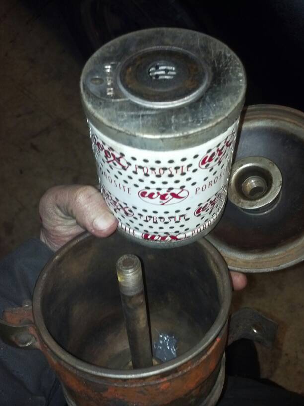

    These are the can that came with the engine. The last pic has a canister filter that came from the can I was going to use in the event the sock wouldn't work. I'd need the taller one, I'm sure.

    The first two pics are of the "alternate" can I was going to use if the sock wouldn't work. The orange Fram was one that came in a box with a Studebaker I once owned, but I've never had it hooked up.
