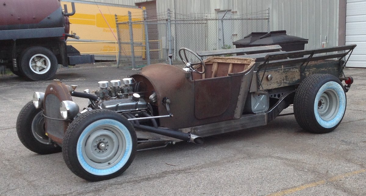

Projects Soft axle? What's going on here?

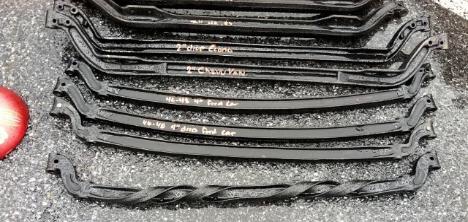

    Check out the bottom axle in this pic. If I'm not mistaken, it's one of those 1935 Worlds Fair jobs where they would twist them up and remount them to show how they still worked just fine. I don't worry about Henry steel flexing, but I'd be worried about that axle. When it comes to concerns over important components that could kill you if it failed, why spend time and money to confirm crap isn't crap when you can swap it out and sleep at night? Didn't that fireman fellah that almost died here in Burbank last year have his Superbell crack in half in the freeway?

    That debate (ductile cast iron vs forged steel) can go on forever.
    After looking at my Magnum axle and not feeling good about it during my build, I just went and got a forged axle.
    Knowing what I do about metallurgy I feel a lot better about it.

    haven't seen one before , that's awesome.....I bought a forged axle, wouldn't trust one of those cast ones.

    The steering arm compounds the problem and the side steering is just all wrong . I have 75,000 miles with that set up and mine flexes when sitting still with a stock 32 axle. You can help the death wobble with a VW steering dampener.

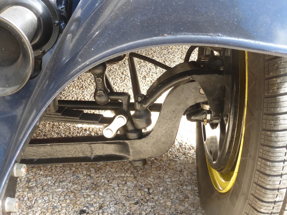

    This works fine. Original 32 axle with solid ends.The steering arm matches 32 geometry
    31Vicky with a hemi likes this.

    The axle ends are actually solid plate. I bought a axle with the ends messed up at a swap meet. Kept it for years. I had some axle ends from buying some brakes. I made a weld fixture and cut some goosenecks and welded it all up. One surprising thing is the perch bolt holes and the spindle bolt holes are parallel. I could use the holes for reference and it would all slide off.

    31Vick, those disc brake rotors push the wheels out a lot further than drums do.
    Stand in front of your tire and give it a good kick. Watch it flex back and forward.
    Changed to drums on mine and noted a huge change in stiffness.
  17. Super Bell axles are cast iron not forged. HRP
