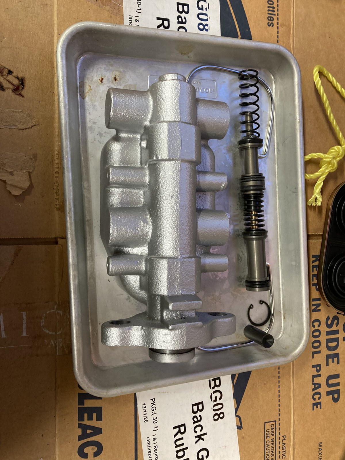

    There are two pretty stiff springs in there. Unlikely that either plunger would be stuck. Here is one I had apart recently to illustrate.
    Most likely, you have air in the master from having run it dry. You’ll need to start at the master. Bench bleed it off the car.
    Then reinstall and bleed the lines as usual. Try not to get any air in while installing, or at least as little as possible.
