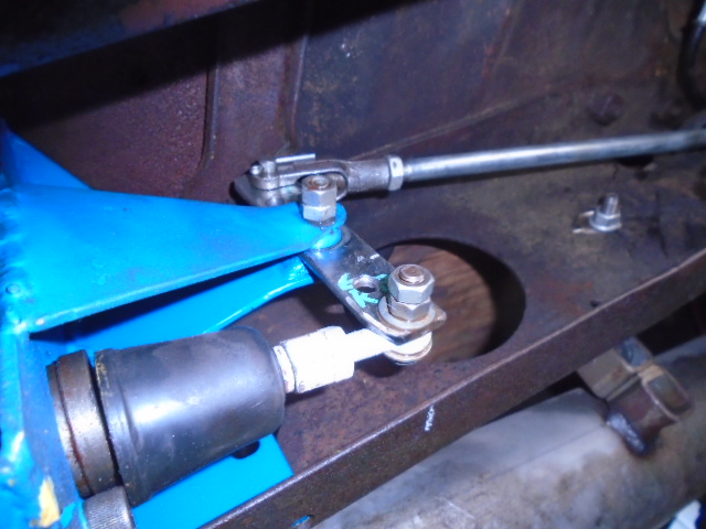

    OK, so I have a 1934 Ford that is using 1948 drums, backing plates and master cylinder. I made a mounting bracket (will try to add a pic) and have an arm that pivots to change the pull of the brake rod- to a push to work the master cylinder It is equally long above and below the pivot point. My pedal ratio is 6:1, using the stock ’34 brake pedal and clutch ***embly.
    I had always used DOT3 fluid but every few years, the wheel cylinders would start leaking and I got tired of replacing them, so when they started leaking this last time, I evacuated the system and switched to DOT5 fluid.
    I know exactly how to adjust the ’48 brake shoes and even as tight as I can comfortably set them, I cannot get a firm pedal. I can pump them until the cows come home and it still doesn’t give me the good solid pedal that I want/need and of course, it won’t stop the car worth a bag of beans.
    Question, did I mess up switching to DOT5?
    If so, how the heck do I keep from having to replace leaky wheel cylinders every few years?

    Sounds like there is air in the system. May need to pressure or vacuum bleed to get it out completely.
    The pushrod bolt should be done up in double shear, to be safe.

    First thing that comes to mind when looking at the picture is, is the push rod long enough? Is it one that came with the master cylinder or one that you fabbed up? Is there any adjustment to the length? If you don't get a firmer peddle when pumping them maybe the stroke is not long enough?
