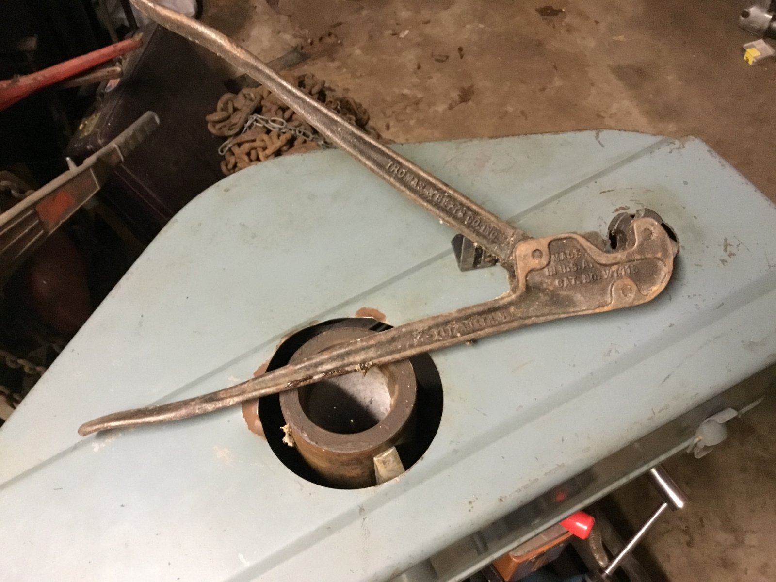

  5. I have used all three of the pictured crimpers. I have the HF kit, another hydraulic kit from eBay, and the hammer type. I’ve used the large handle type too, that’s what we have at work. Here is my perspective as a professional truck technician. The large handle type crimpers work fine, IF, you have room to swing the handles, like if you are repairing cables on the truck. The hammer type works great if you have the cable out and have a good surface to beat on, bench, anvil, floor, etc. The hydraulic ones work great in tight spaces if you have dies that are large enough for the job, at times we ran into 4/0 cable at work.

    That is a nice crimper, the old **** is the best! On the other hand I have made hundreds of quality crimps with the other type hand crimper, maybe the truck shop was using terminals that didn't work well with the crimper? My experience has been that shops change hardware vendors often. We changed to Imperial Supply and they are awful in regards to quality (as are a lot of things these days). I also have used the "hit it with a BFH" type crimper too, just didn't like the looks of the crimp.

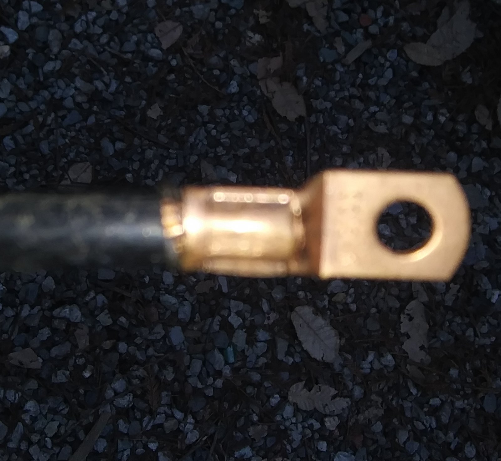

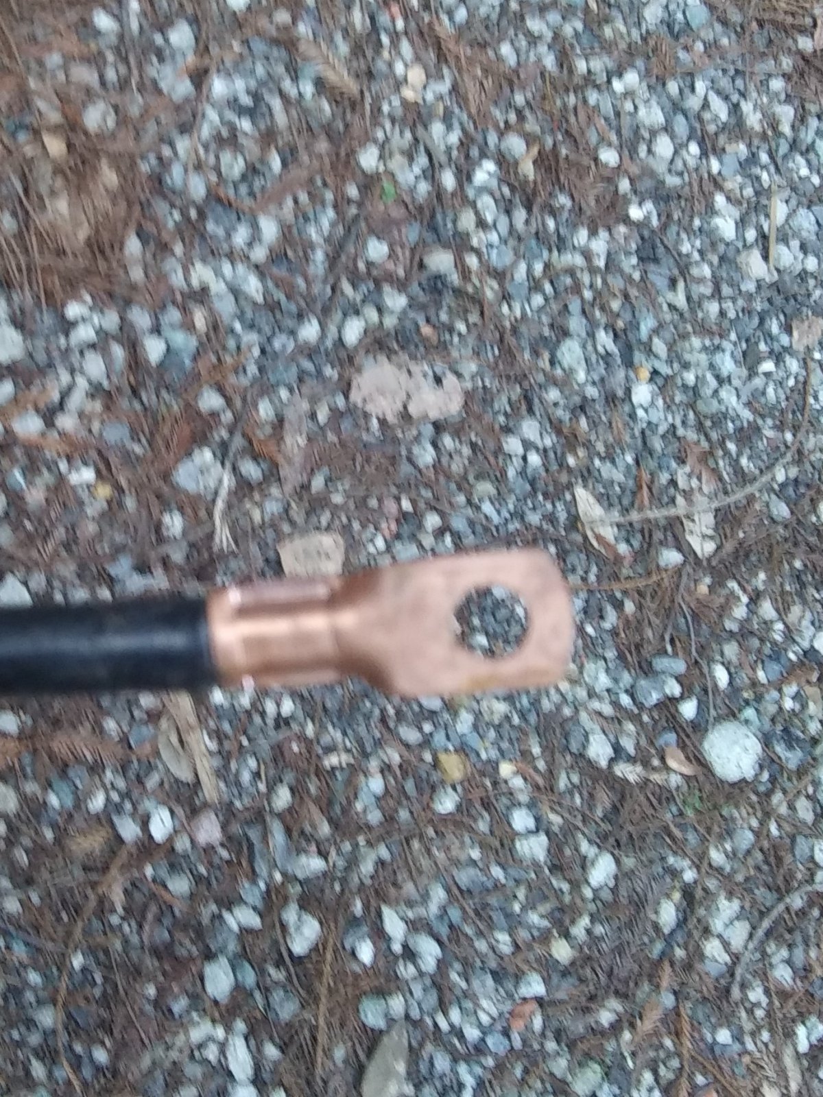

    My hydraulic crimper arrived a couple weeks ago, finally got a chance to try it yesterday. Just my golf cart batt cable, probably 4awg, good for a first test. The crimper does have the hex dies. The terminal was a tight fit on the cable, had to push it on, I could shake the cable without it coming off. The first dies I tried were too large, dies bottomed out without squeezing the terminal. The next size worked, here is the result. Is this what I should expect? Feels tight..
    Blurry photos, my specialty.

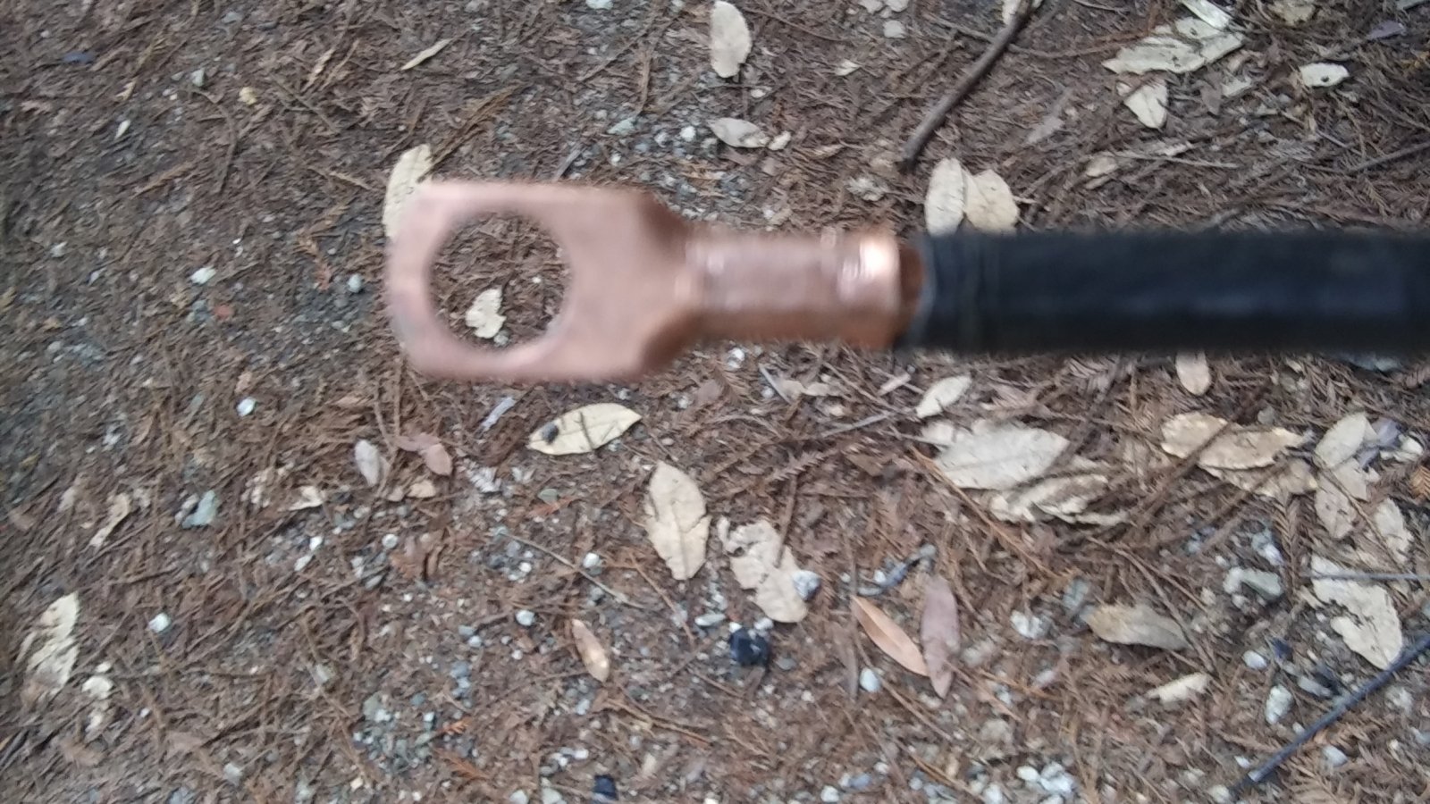

  16. I crimp about 2/3 then rotate the crimp in the die for the rest as that will eliminate the 'ears' you get doing it in one shot.

    I'll try that next one. Crimper works great. Only complaint is it takes two hands to pump it, so the cable needs to be held securely somehow. Just like most electrical work, you need three hands.:)

    Second try, earless. More better.
    Picture quality, no better..
