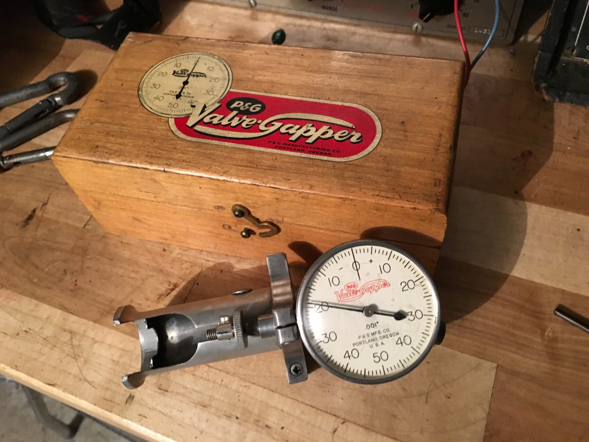

    These work slick, it doesn't take hardly any rocker arm face wear to interfere with accurate lash setting when using a flat feeler gauge. If everything is new it's not a problem using a feeler gauge. I thought I had 'em set at .019 but they were quite a bit wider than that after checking with this. Getting the lash consistent across all cylinders, smooths everything out too.
    A vacuum gauge is useful when setting the lash. Let's say your motor always pulls 19", if the lash is too tight the valves start hanging open and the gauge will drop off quite a bit, and valves need to hang around on the valve seat for a little while to cool off, it may burn a valve. Too loose, and everything in the valve train gets completely hammered.

  26. DDDenny
    Posts: 22,877
    Proudly made in Portland Oregon.
    Shifters too.

    Had forgotten about the P&G valve lash checker and may look into getting one.
