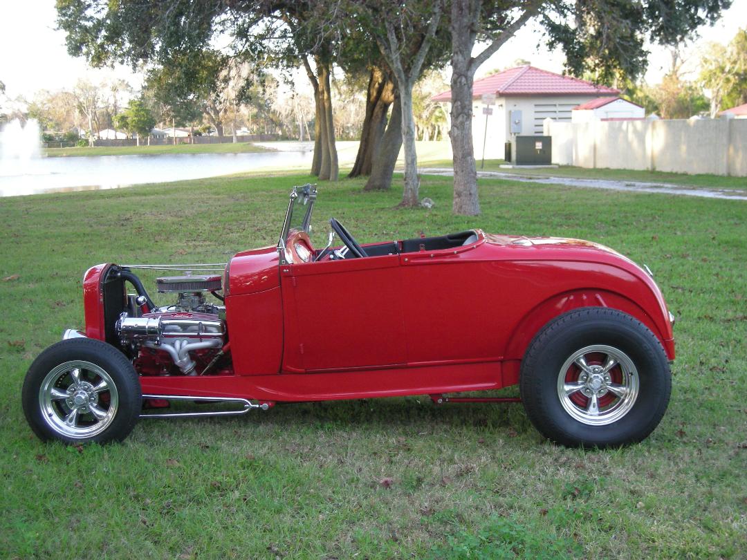

  20. Gregg Pellicer
    Joined: Aug 20, 2004
    Posts: 1,347
    Gregg Pellicer
