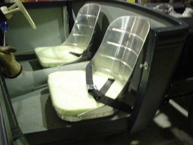

    I did my 'bomber' style seats with them, as explained, you use an air hammer/chisel with a concave ended head that matches the rivet head size and a bucking bar on the other end ,just a flat faced heavy piece of steel.
    the trick is keeping the bucking bar square to the panel and hard against the rivet while the hammer goes ratatatat.You really need a two people to do it and the one on the hammer has to be pretty sharp on the trigger.(i was lucky, my dad helped me and hes built rivet constructed aircraft)
    youll need to get some cleco's and cleco pliers too, to set it all up before you rivet.
    its a cool construction method for all sorts of suff.

    Thanks for the tips and rivet suppliers! Cool bomber seats lowsquire! Turned out nice and very cool you riveted them also.
