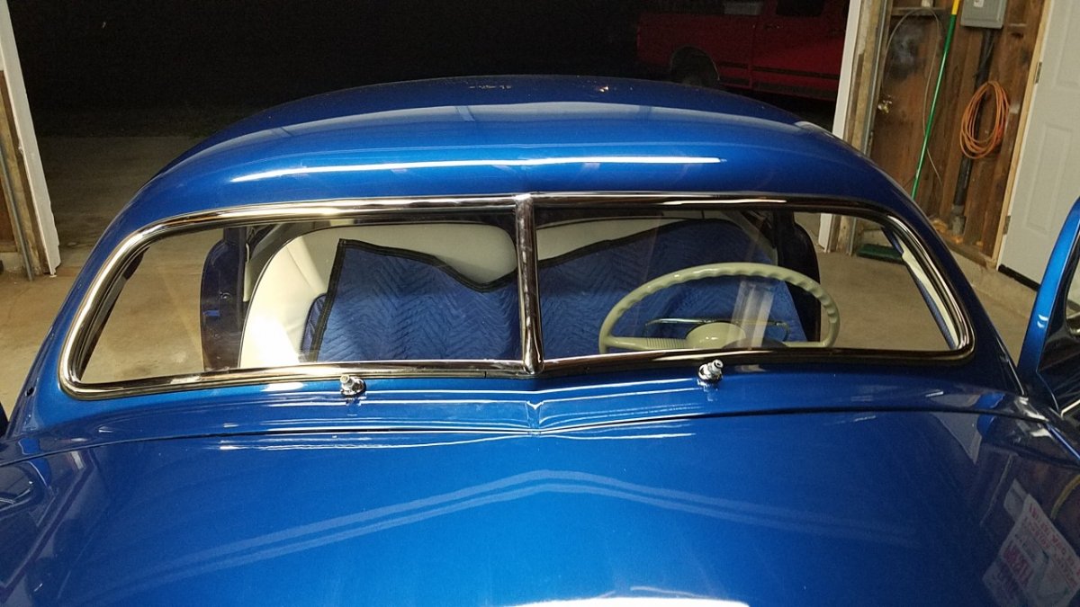

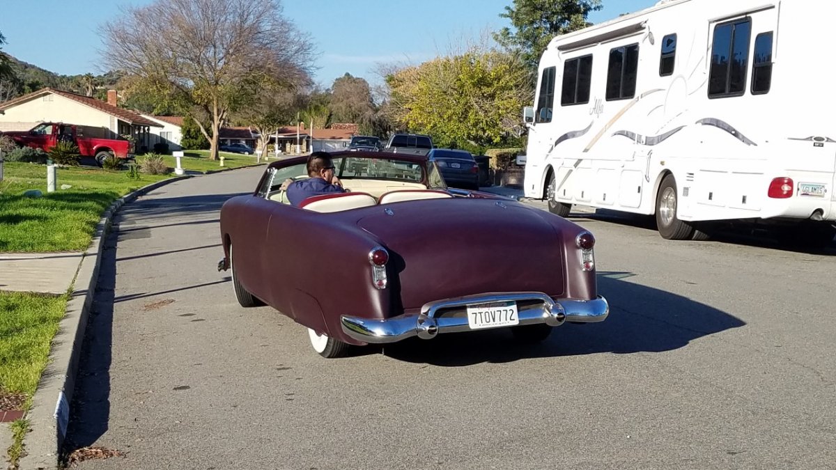

    HERE ARE SOME UPDATES :)

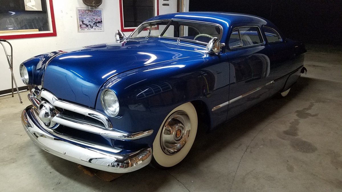

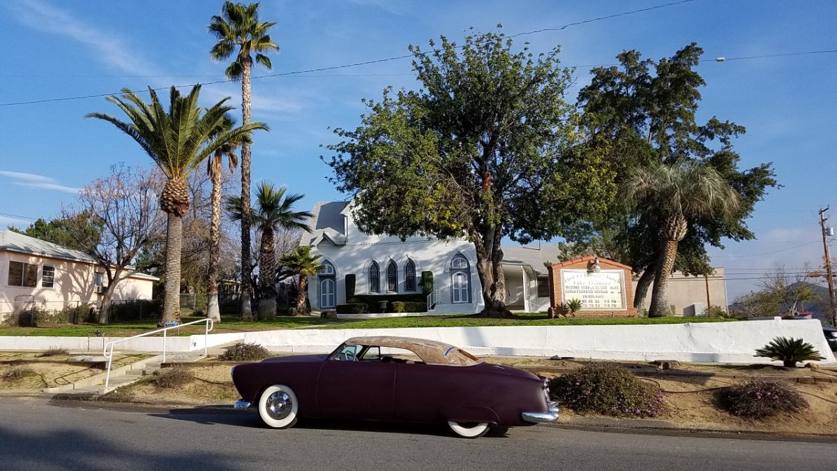

    Greg's '50 Ford hit the road for the first time last weekend...still some things to finish up, but it is almost there! This has been a bittersweet build completion because it is the last kustom to roll out of my parents' property where I have been doing this work for the past 14 years. My wife and I bought a house and I am now working at our place in Lake Elsinore on one project at a time.

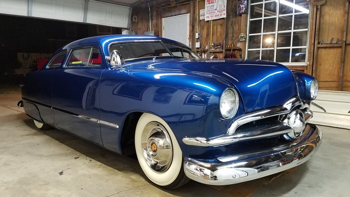

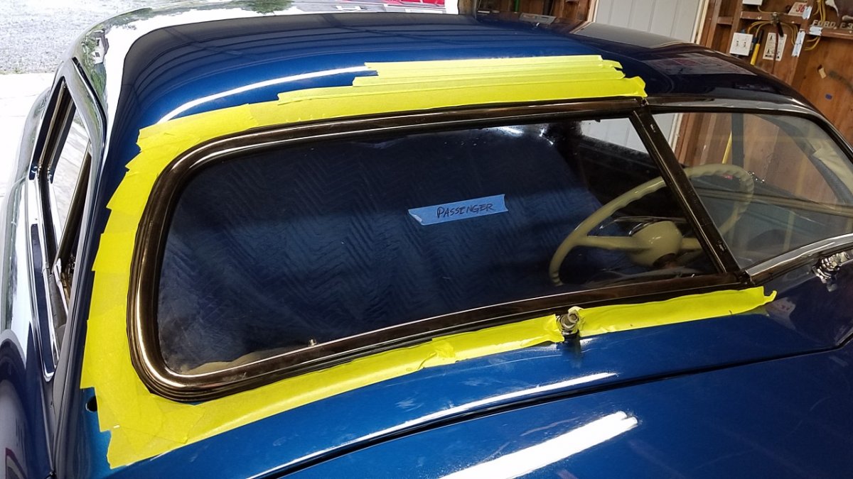

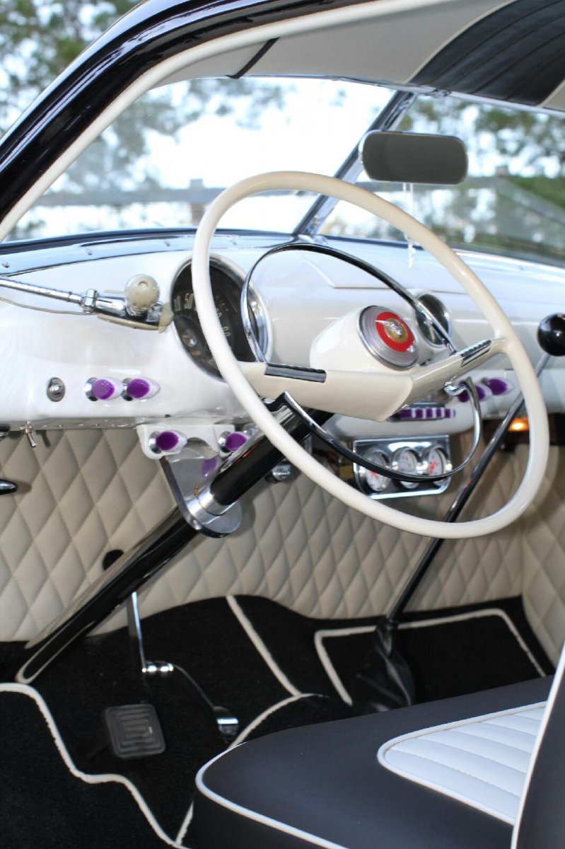

    I forgot to post these pictures of the first drive since completion of Greg's '50 Ford... done10.jpg done1.jpg done5.jpg done4.jpg

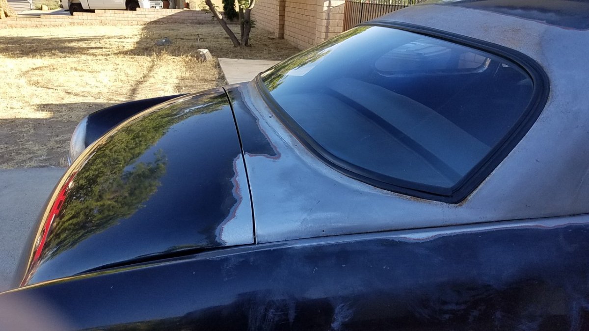

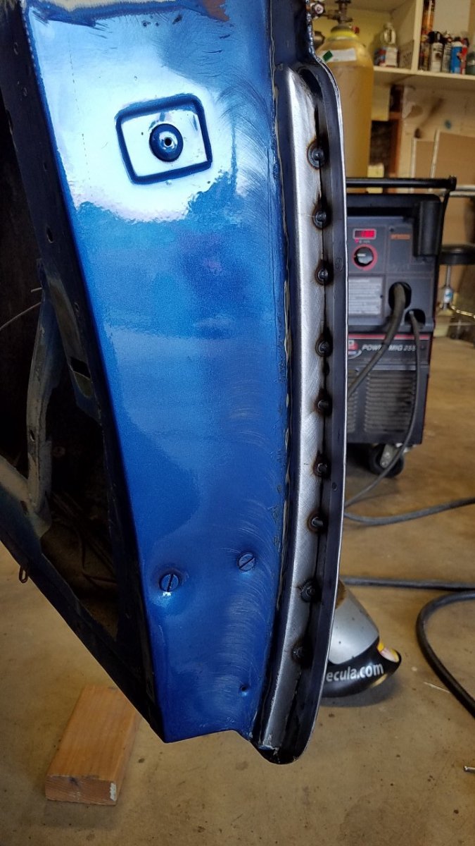

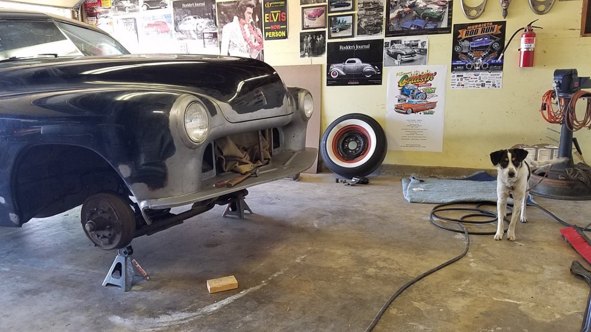

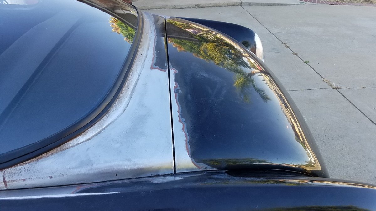

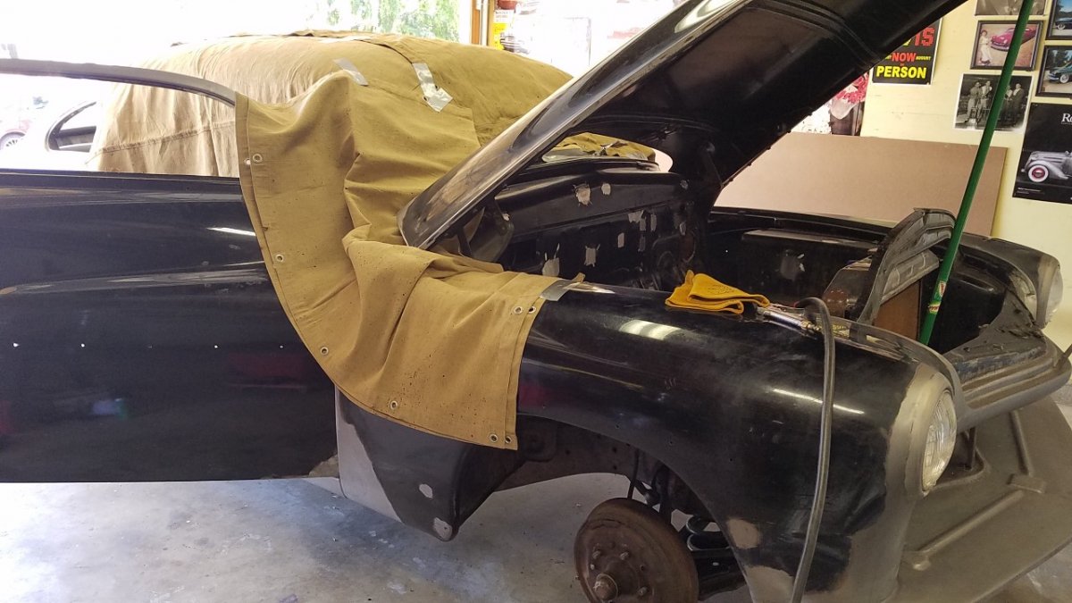

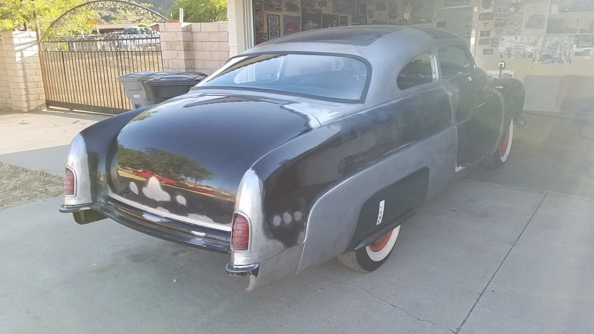

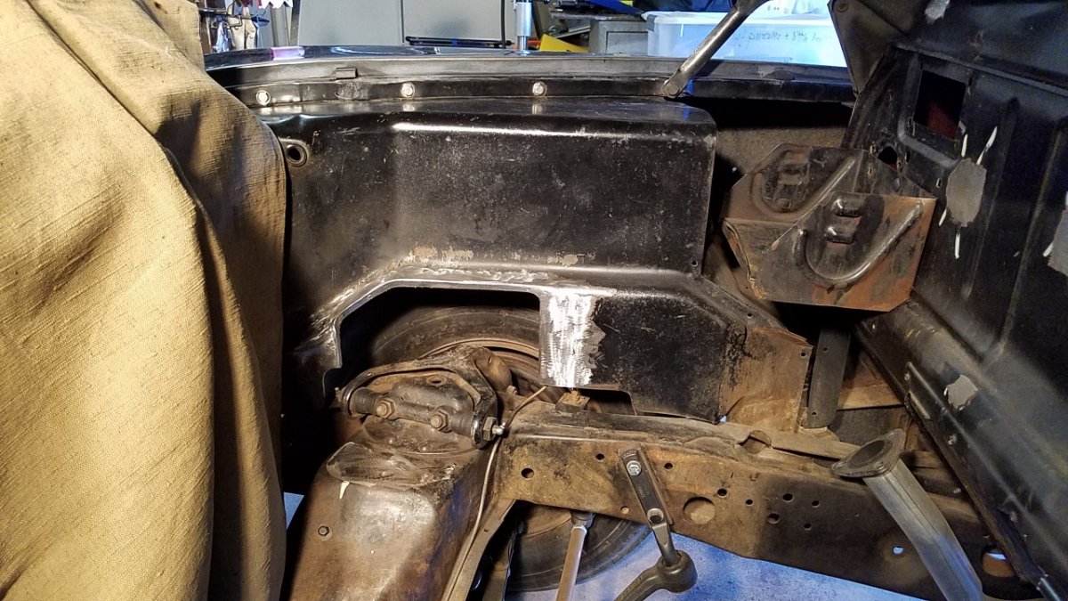

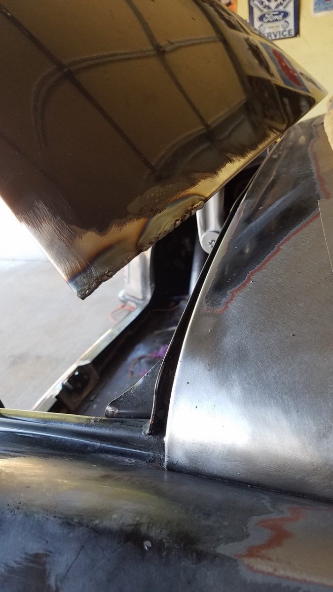

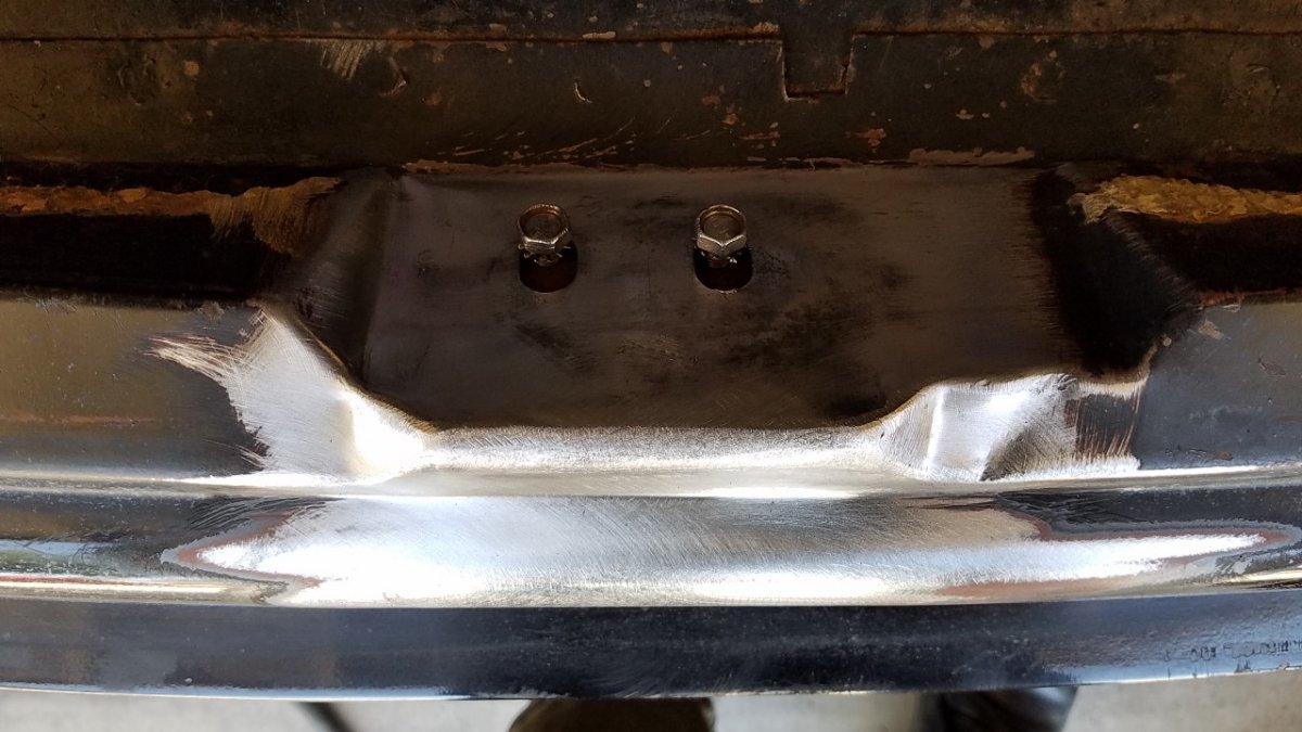

    Spent the last few weekends fitting the front sheetmetal on Jeff's '51 Merc. Had to cut and weld some gaps after I started with NOS hood hinges that Jeff provided. I didn't take a ton of pictures along the way but this one had all of the typical '49-'51 Merc fitment issues going on. I also added a lip and more metal to the edges of the opening that was cut out in the p***enger inner fender to clear the Cadillac generator. I also rounded the corners of the front valance to clear the front bumper better. The firewall was shaved as well. If you haven't seen the articles on the chop on this Merc, check out the last two issues of Kustoms Illustrated!

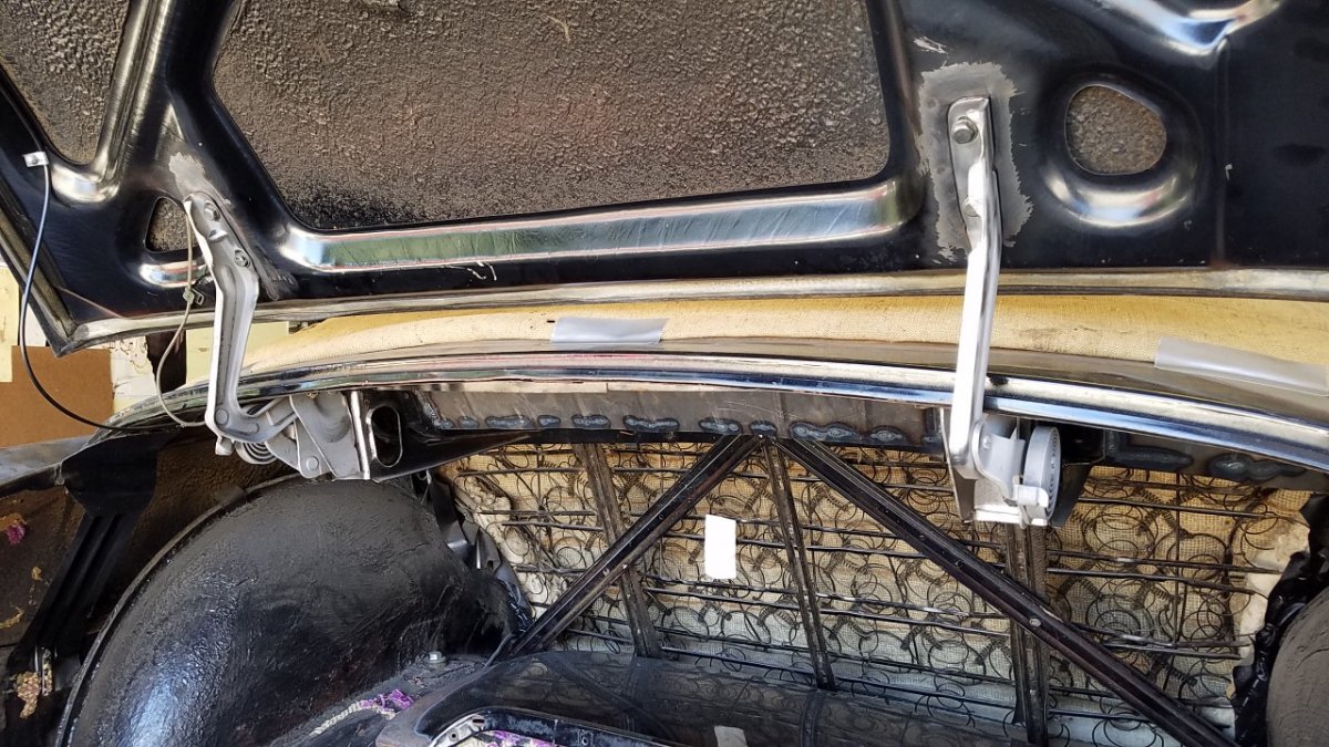

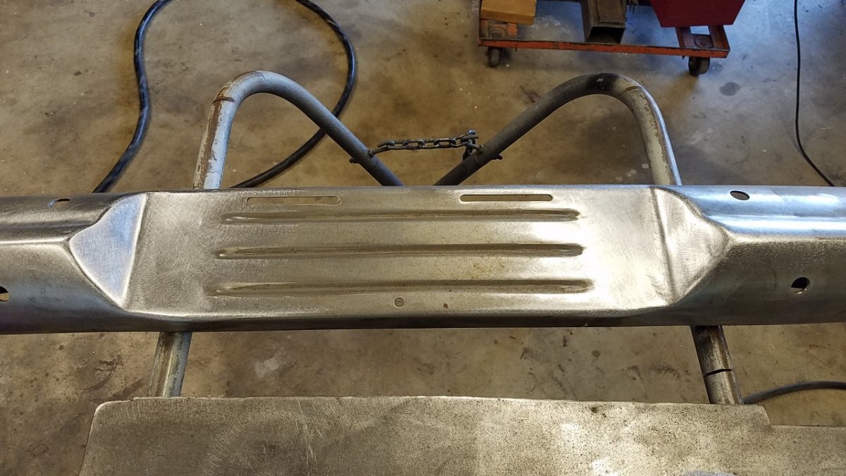

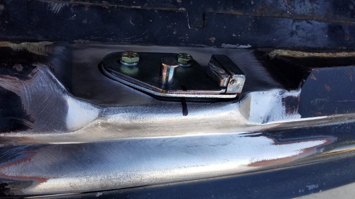

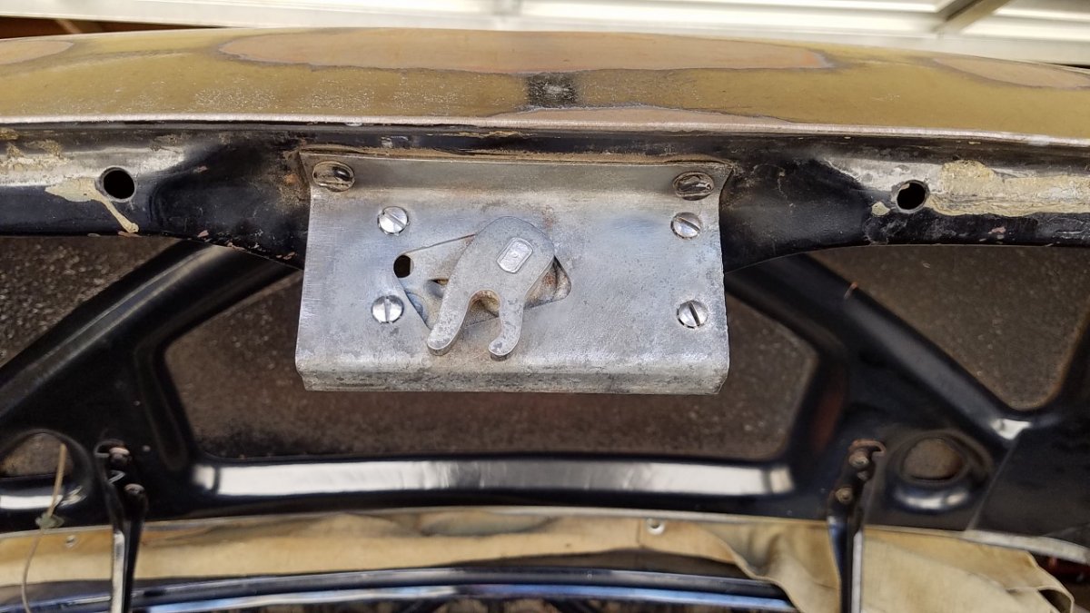

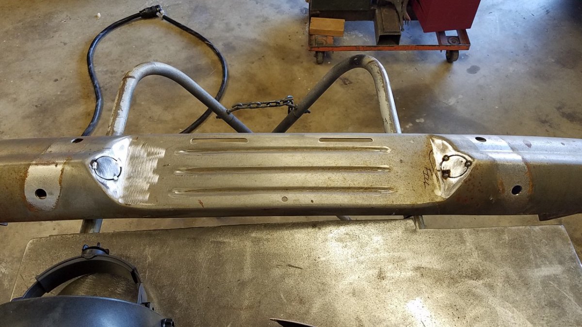

    Few more updates from this weekend- got the trunk completely dialed in. Jeff found some better condition trunk hinges (originals had a ton of play in them), Matt Townsend came to the rescue with a nearly NOS condition upper trunk latch, and I was able to weld the striker pin on the lower trunk latch. I had to weld up the cracked and pushed back lower trunk latch platform and re-thread the holes due to screws showed in to hold the latch. Once the trunk opened, closed, and fitted nicely I cut and welded the upper gap. The rear bumper guard holes on either side of the license plate also got welded up yesterday. Not much left on this one before body and paint! :)

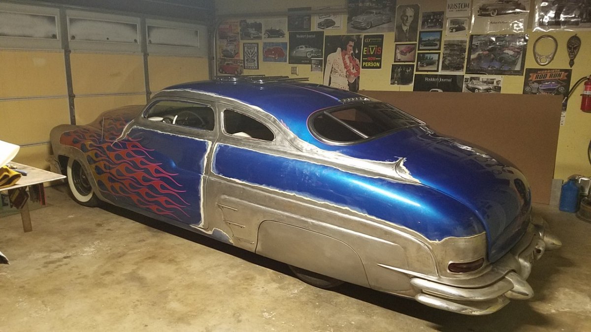

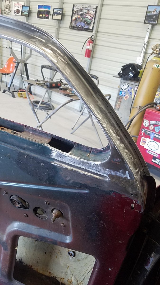

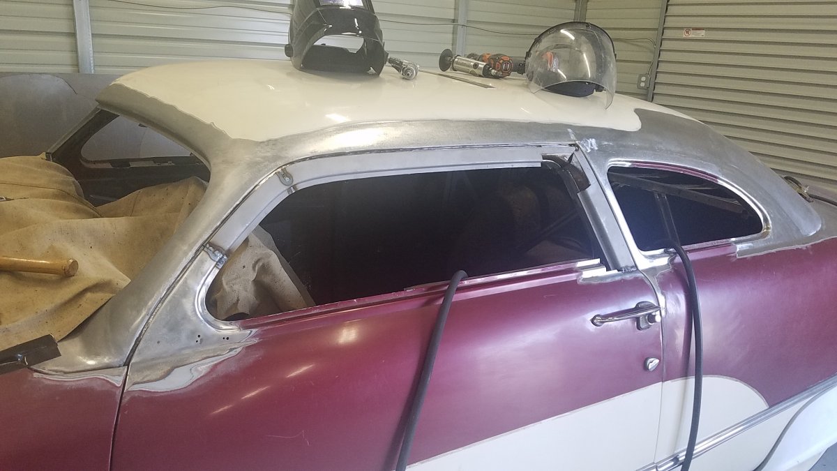

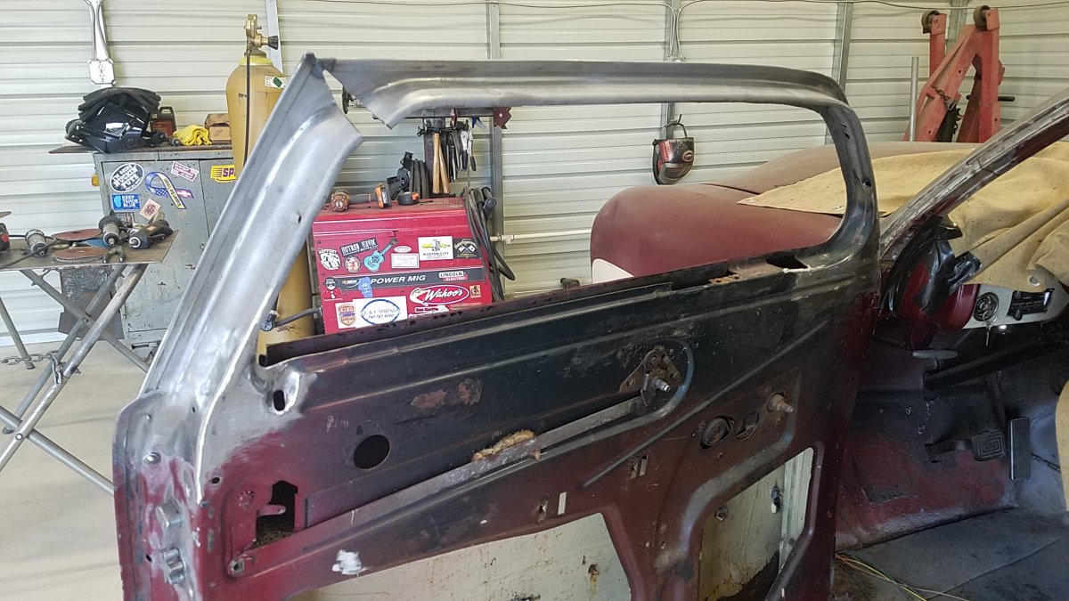

    Made some progress on the '51 chop...my schedule is crazy busy teaching high school full time and a welding cl*** on Tuesday and Thursday evenings at another high school. Summer is almost here so more progress soon! Chop is all done except for the door tops (and window frames/vent windows) but I will need to fit both doors quite a bit this coming weekend. Here is the inner rear window factory bracing after I flattened it for the new chopped roof shape and extended the ends to meet the C pillar. In these shots, you can also see the B pillar and quarter window areas completely finished with all inner structure and surfaces replaced. Temporary bracing used for the chop has also been removed. It's all downhill from this point :D
  30. shoebox1950
    Joined: Jul 17, 2008
    Posts: 1,221
    shoebox1950

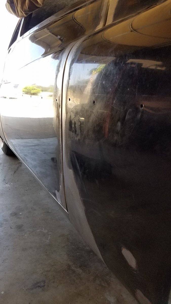

    Got some more work done...driver side door fitted and door top almost finished. Hard to get a lot done doing this one day a week, but my summer break is almost here and it will be full speed ahead :)
