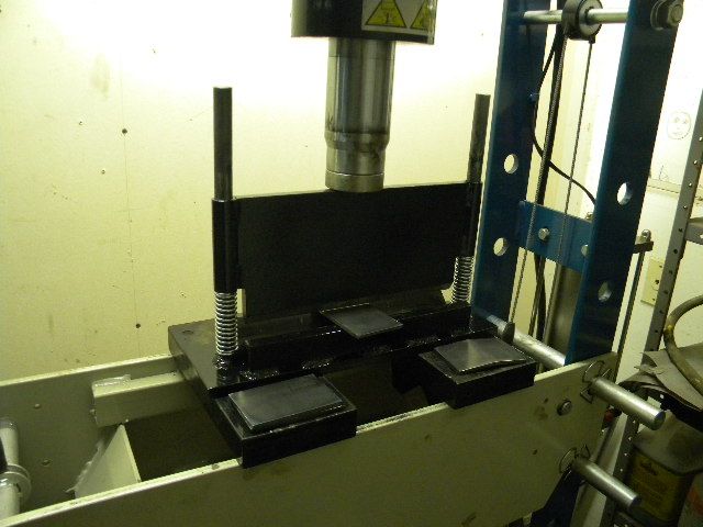

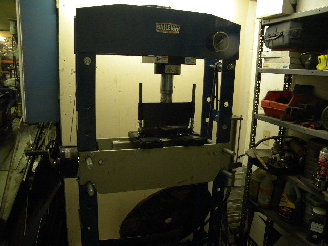

    in the rear for the kick up i like to use flat plate for the bottom to make it look like a bent rail. i also like to plate the splice on the inside ( internal shear load gusset). so i cut and bent these pieces of 3/16 plate to put on the inside.
    here is how i bent them, in my home made press brake tool for my 50 ton press
