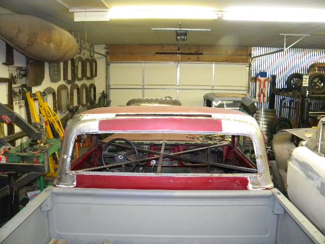

    been slammed at the shop lately, just not a ton of what i have been doing is picture worthy. lots of welding and grinding. here are a few of the more interesting things i have been doing
    this one is a little OT, but it is still cutting and grinding and some old school style work

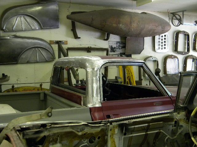

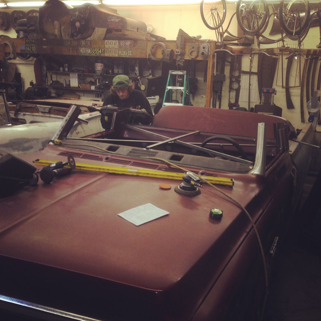

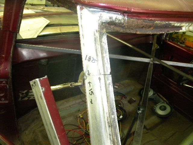

    truck in for a chop, laying out some cut marks
    top removed
    starting to put the top back on, has the cut the posts at the top and bottom to line things back up
    front of the roof all squared up and tacked on

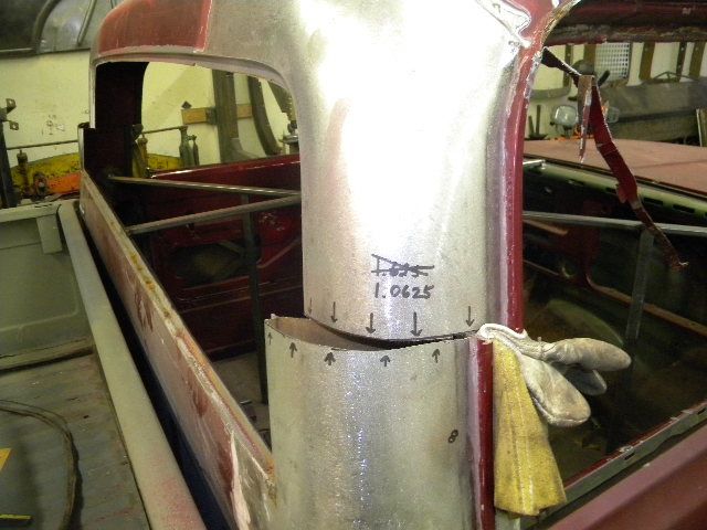

    going to have to split the roof to make things better in the rear. going to use this factor seam since the interior is metal and built into the truck. this should be fun
    split at the seam, doing some grinding to make the gaps right
    then cut the back part of the door jam out and slid it back
    then time to make the pieces bridge the gaps
    throw in some pie cuts to line the bottoms up
    starting to get some where
    had to add a piece to the door jam from where it was stretched, used a factory seam to make it look stock
    worked on fitting the door post back on the p***enger side as well

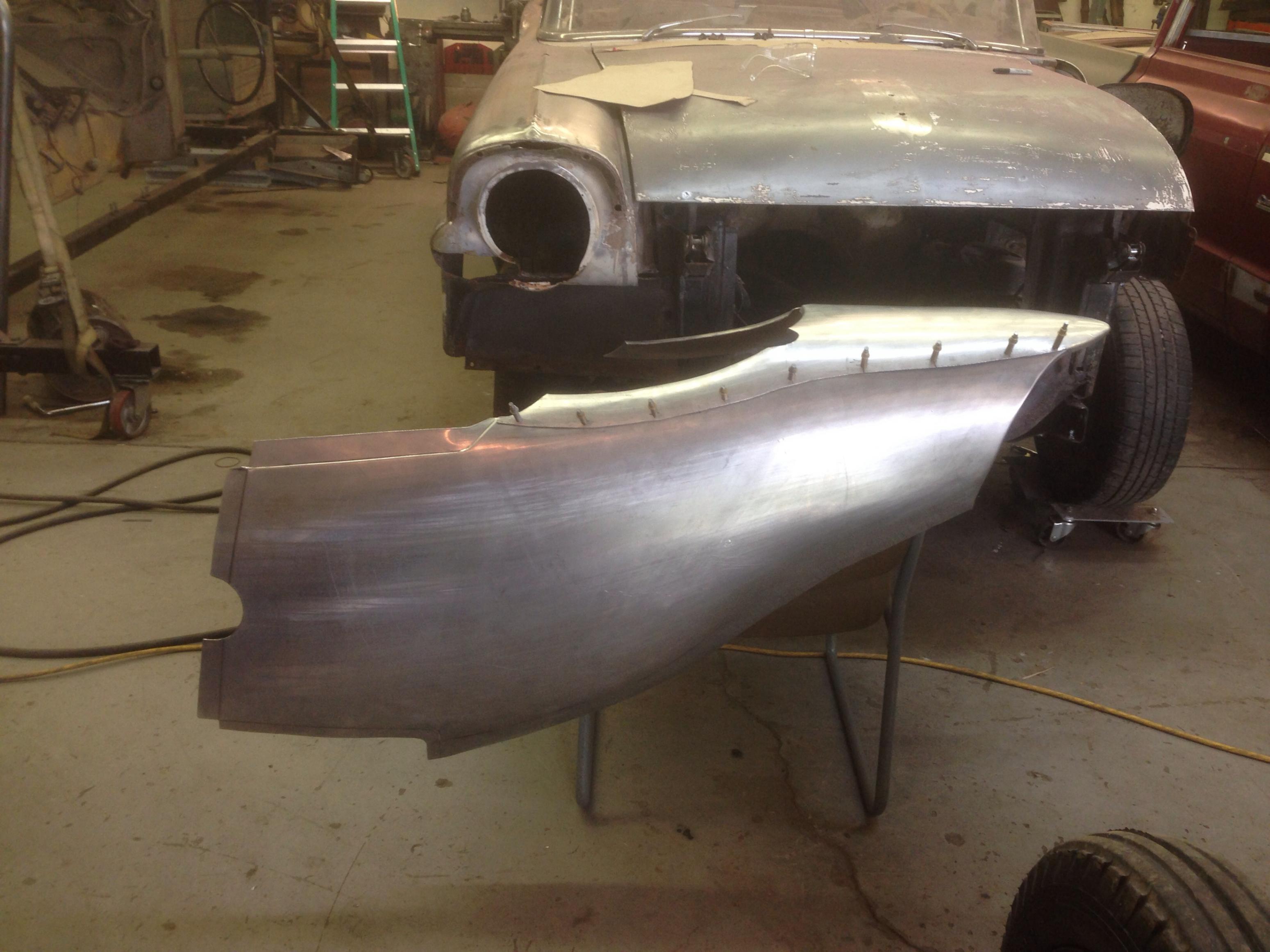

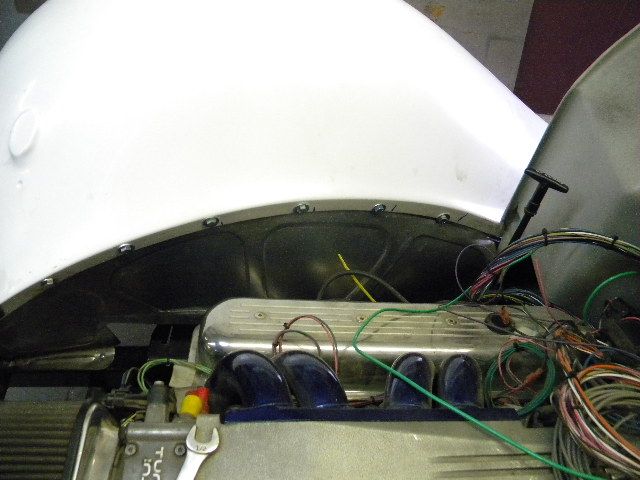

    also have a 35 ford truck in the shop. have to mount the fibergl*** front end, make a 4 pc hood, running boards and running board braces
    here are the inner fenders

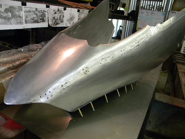

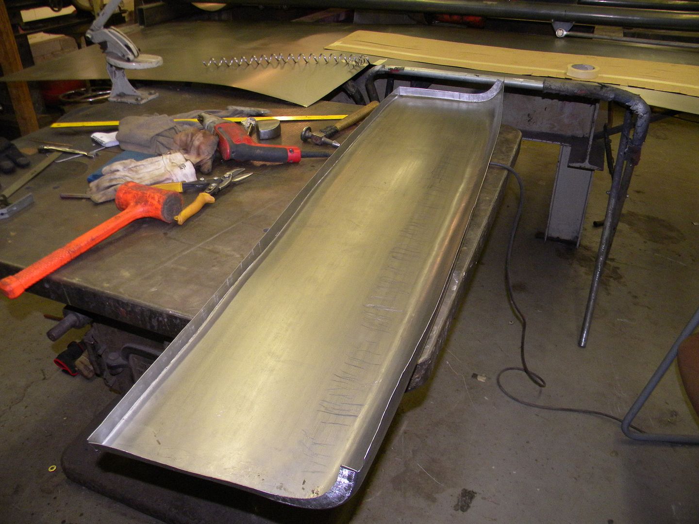

    Another project I am working on, .063 3003 alum. Chute body

    Awesome work. I hope I have welds like you in the future! I see you have a tubular X member here. What size of tube did you use and thickness. Im trying to figure out what I want to use in my 31 coupe.

    the front x member is 2 in od, .250 wall, the center k member is 1.75 od .125 wall

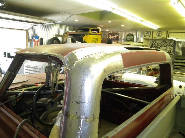

    a little update on the OT truck chop. made lots of head way while the site was down
    got the driver side door top welded back on

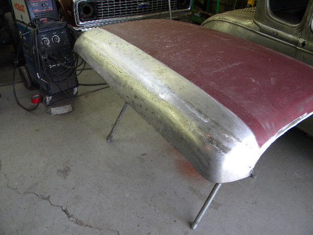

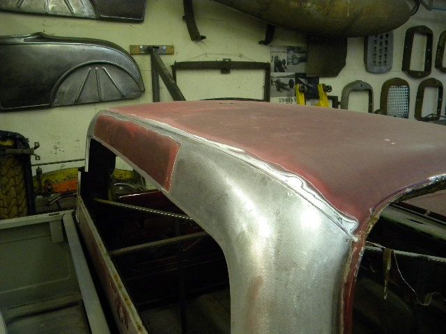

    then pulled the roof skin off to metal work the roof seam, and to make things easier to stretch the inner roof sheet metal
    welded up the roof skin, ground down and some hammer/ dollie time. i didnt get a pic of it but i ran it through the english wheel to smooth it out more
    then moved onto the fun part. the inner skin. i split it at the factory seam and made the new filler spot weld to the flange like it did from the factory. two reasons for that, 1 a lot less welding/ warping, 2 it looks like it was never chopped. filler panels made and clamped up. ****m used to help lay out the trim lines for the fillers
    all welded up and ground smooth inside and out, then some attention with hammer and dollie
    its not perfect but nothing some high built primmer or a skim coat of filler cant fix.

    made some more progress on the roof
    had to make a filler panel to replace where i slid the rear of the door frame back
    all fixed up
    then continued to weld and smooth out all the seams

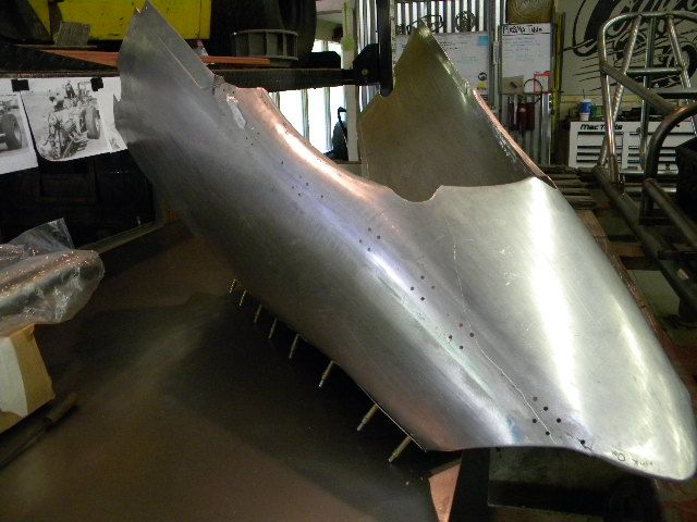

    got a little more done on my aluminum chute body i am making
    and have been working on finishing the hand made 4 piece hood for a 35 ford truck. hand made from scratch, hand rolled all the hinges with a hammer and dolly. still needs some fine tuning but it is all roughed in

    another shot of the chute body

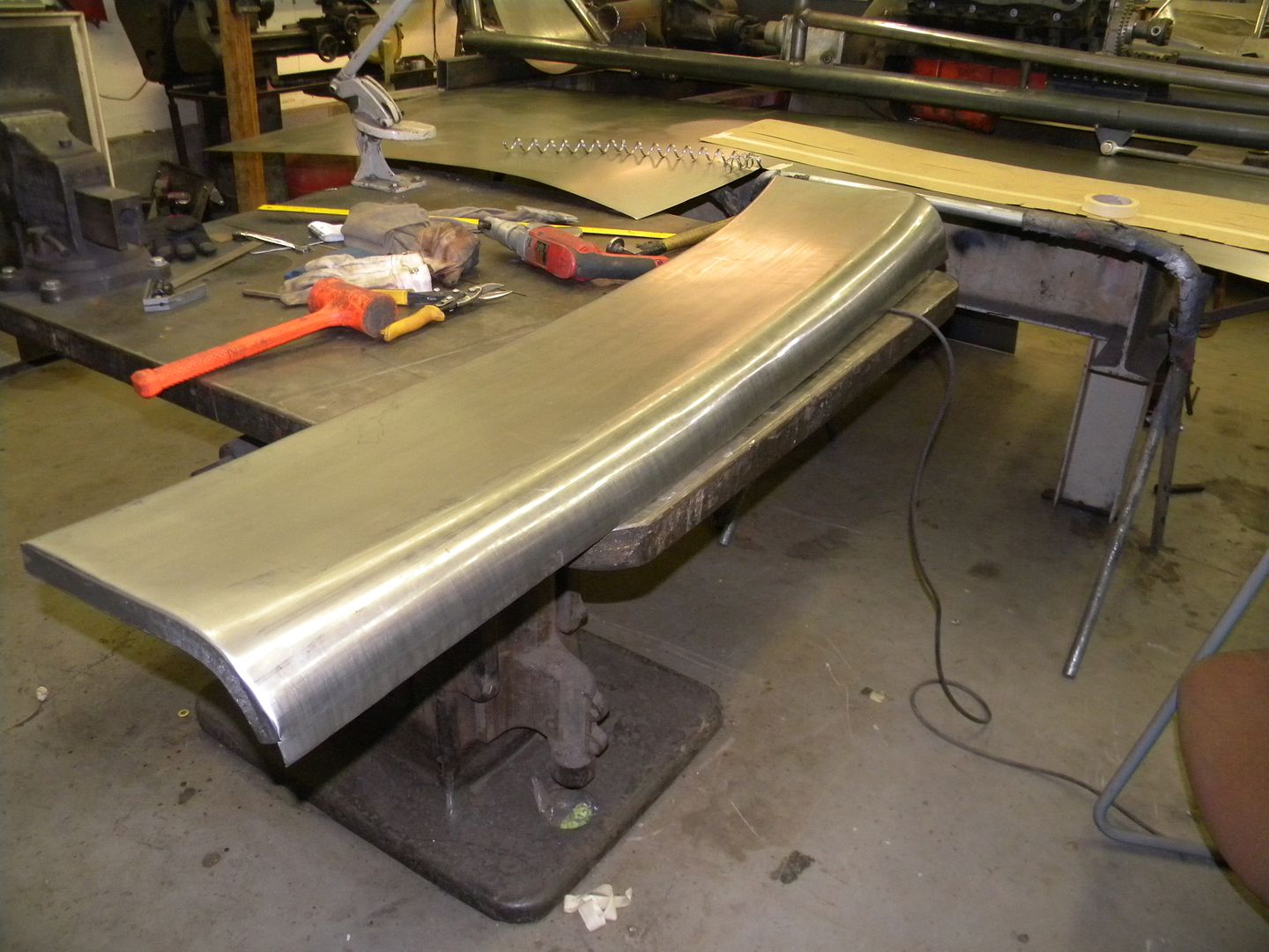

    also been working on shaping the custom stretched running boards on the 35 ford truck. these have been challenging with the curve in the boards that match the fenders.
    all the lines laid out for linear stretching
    ran through the power hammer a few times to stretch the edge and roll it over
    starting to smooth everything out with the english wheel
    starting to look like something
    more to come on the running boards as they progress.

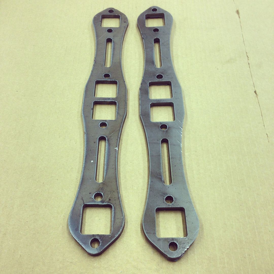

    and been working on more custom cut parts on the cnc plasma. SBC header flanges with or with out the block temp sensor cut outs, round or square ports

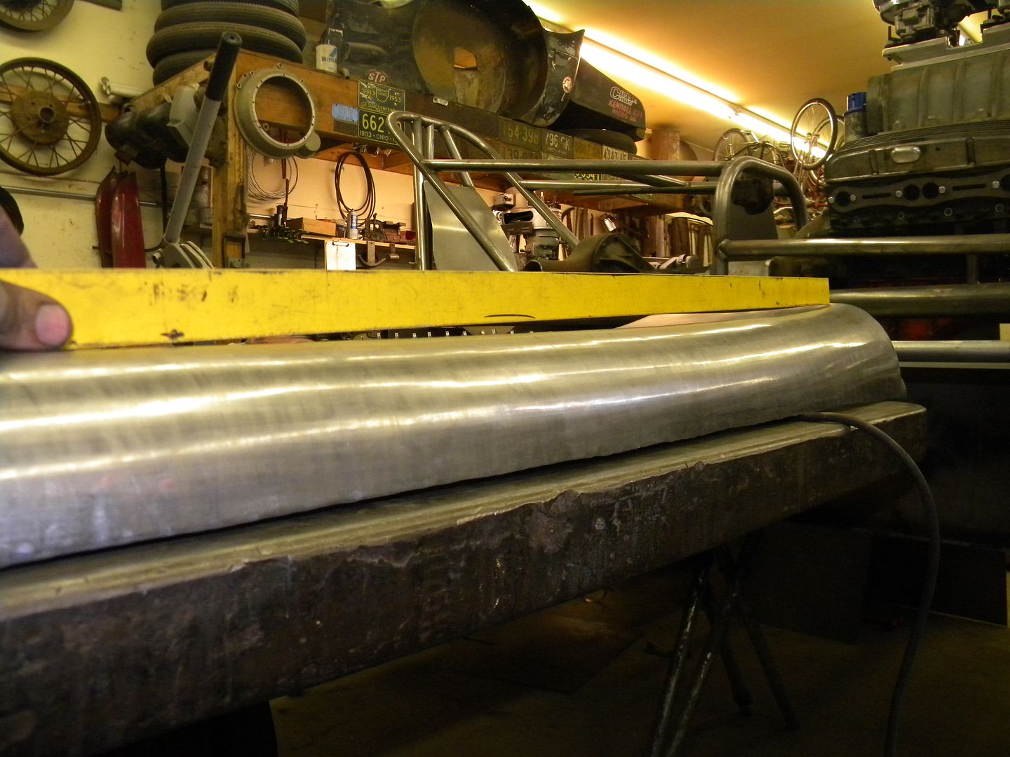

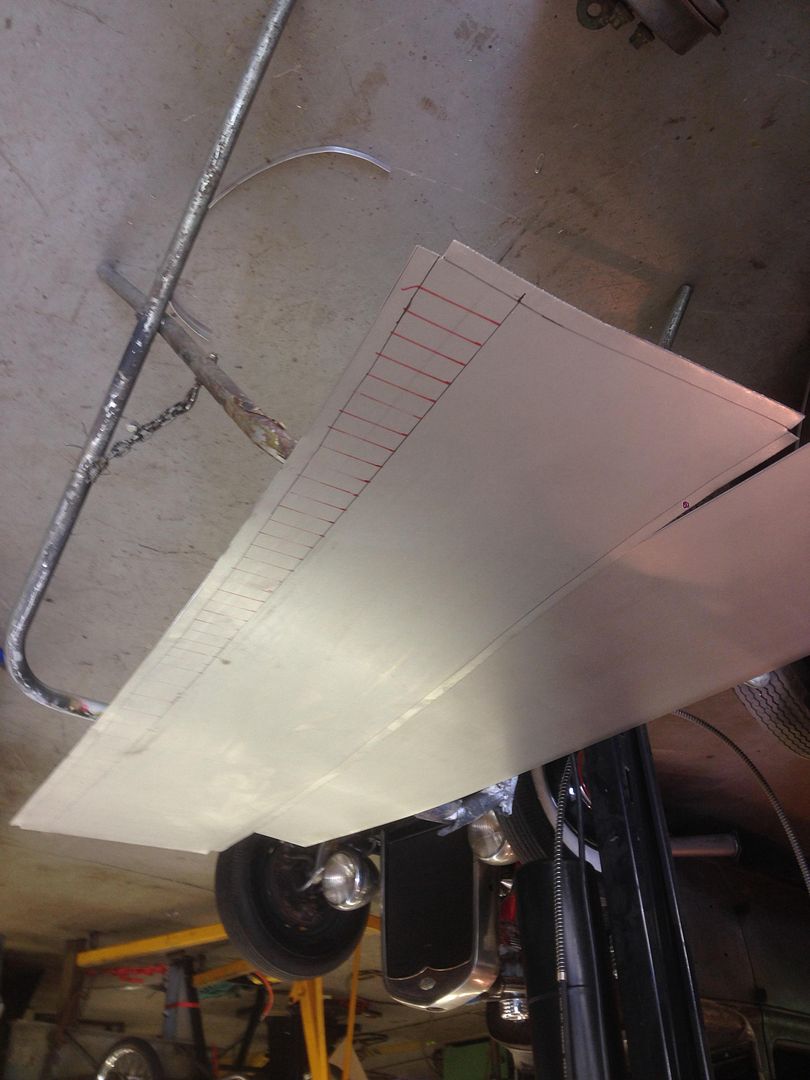

    more work on the 35 ford truck extended running boards
    using the same card board template as i did for the driver side, just flipped over to lay out for the panel
    panel cut out, high light line laid out, and marked every inch to use as guide when linear stretching
    linear stretch dies in the power hammer
    now it has to get ugly before it gets good
    one complete p***
    p*** two
    first trip through the english wheel
    started folding edges over on the bead roller with a tipping wheel
    when folding the edge in the radius this happens
    a little time with a hammer, dolly and some shrinking
    worked the edges up to a 90 and straightened them up a little with a hammer
    here it is roughed in, still need to do some work on the english wheel, roll the body line in the bottom, and turn the edge under the body line. but it is getting there.
    here you can see the curve of the running board and why it had to be stretched
