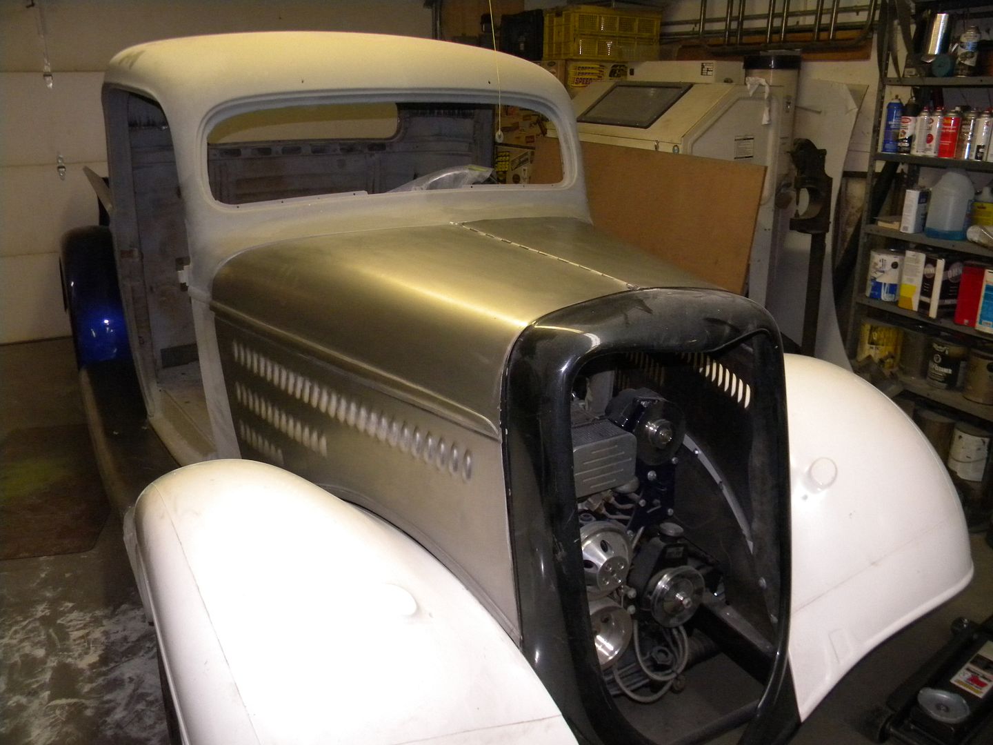

    had to pie cut the gl*** fender to get the p***enger side running board to fit and look right
    after getting the fender re gl***ed i finished fitting the hand made running board. now all my work i done. two custom running boards, and a 4 piece louvered hood. ready for pick up
