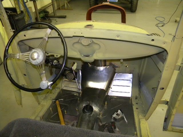

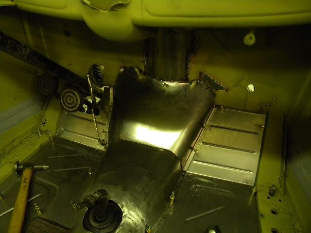

    we worked on the floors in my buddies coupe again yesterday and a couple hours today here is the progress.
    the trunk area with access hole for the u bolts
    more on the trans tunnel

    more work on the coupe floor. this panel goes under the seat

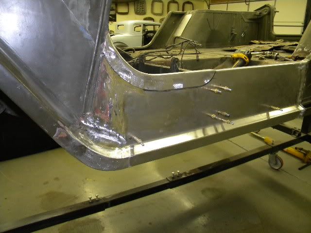

    an OT project i am working on for a guy, its an M151A1 military jeep. a lot of rust, sub rails were purchased floors, and other sheet metal parts were fabbed in house. more panels to come on this one

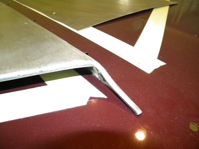

    How did you make the bead? Did you you draw it through the die or press every inch or so?

    the lower die holder is vertically adjustable so i can fine tune the gap between the dies for metal clearance
    when i moved shops the die was lost or misplaced but when i get around to making a new one i will post up some pics
