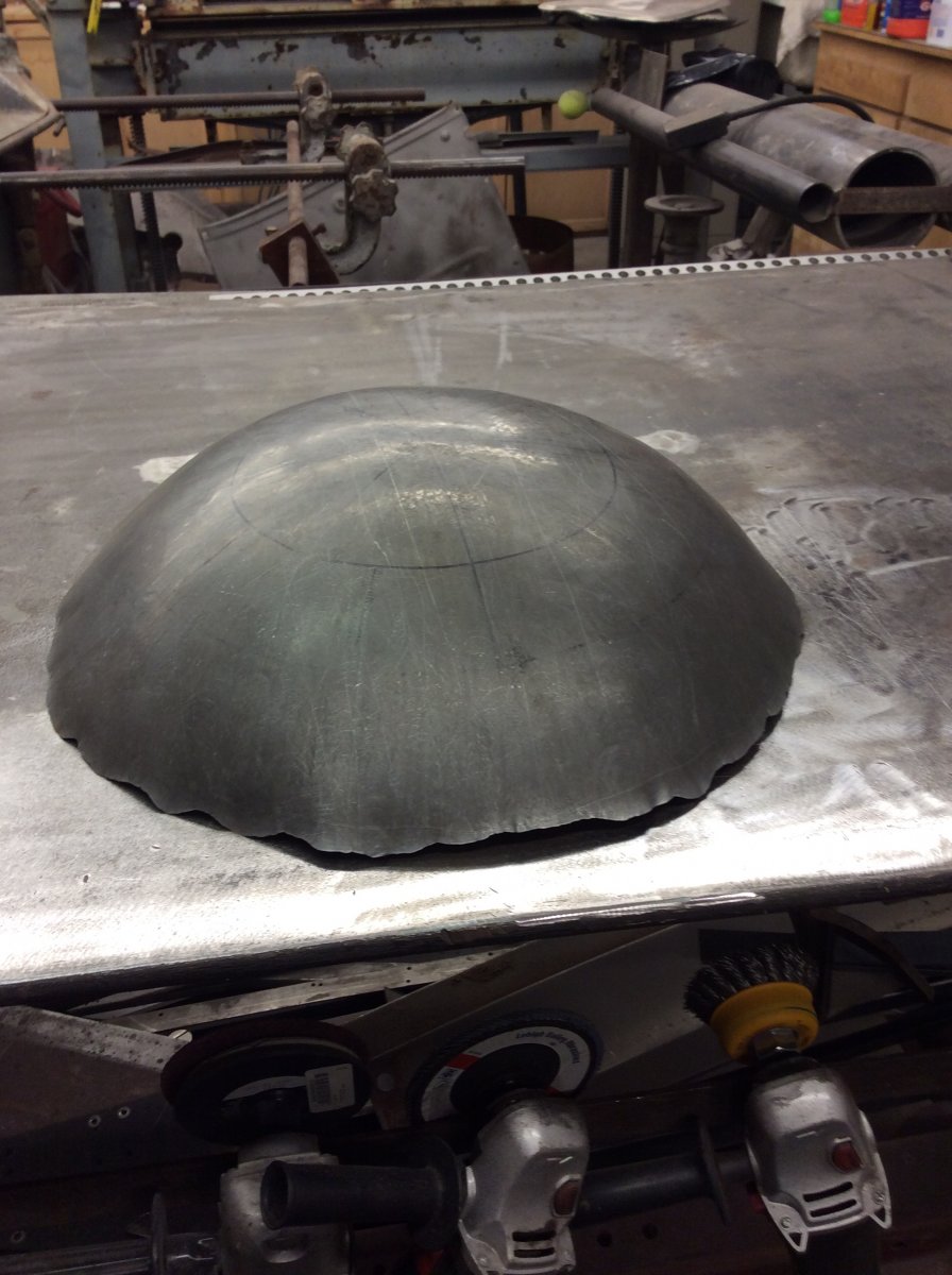

    Mike , since your teaching us about shrinking with thumb dies , I've been playing with mine and is it normal to get these pull outs on the edge . What's causing it and is there a cure ? Thanks in advance for the lessons . Blue
  25. cornfieldcustoms
    Joined: Feb 2, 2008
    Posts: 1,064
    cornfieldcustoms
    no, the areas at the end of the shrink you are getting is because you are hitting the edge of the panel to hard and causing the edge to stretch out. in effect you are stretching the end of your shrink fighting yourself. not sure what you are using to shrink ( power hammer or pullmax style machine), but you can either back off pedal and hot at the end to not over hit the edge, or not pull the panel so far out of the thumb on the dies that is hits on the edge in the flat of the dies causing the stretch. in the video if you watch it again i feather the pedal the end of the shrink and only pull panel out enough to close the tuck
