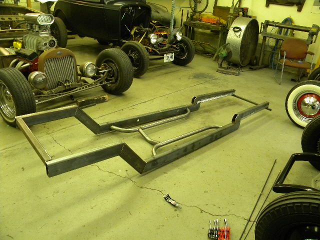

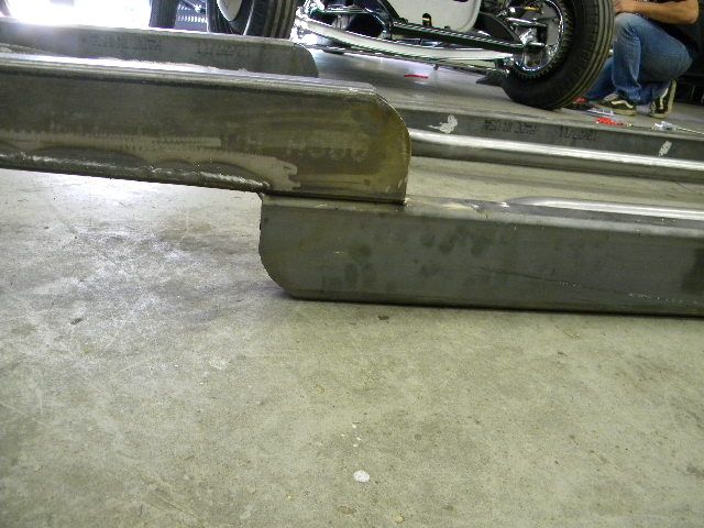

    had some friends come into town over the weekend for the wilmington mile speed runs. while they were here we built this ch***is for his model A truck, just tacked up in the pics until i get the flat 32 front cross member in.
    2x4x 3/16 tube, 4 inch Z up front 11 in the rear, tapered front rails, 1.75 wall tube for the center section

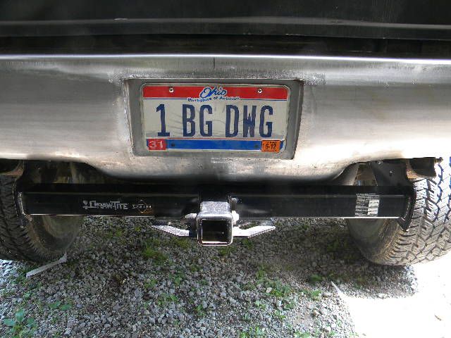

    made this roll pan the other day for an O/T car. made completely from scratch, 18 gauge steel. rolled edges, whole thing is crowned and recessed plate box

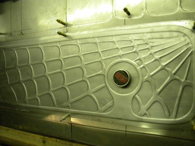

    have not been doing a ton of cool stuff worth posting on here. a lot trans and rear end swaps........ blah. i have done some more bead rolling on a customer car, and made some bomber seats. here are some pics for proof lol
    some floor pics in a sedan i am working on
    fuel tank cover panel in the same sedan

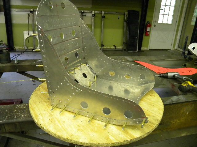

    and the bomber seats
    all the pieces cut, drilled and bead rolled, all the large holes still need dimpled, and the seat belt holes will be cut out later
    added the side brace on the inside
    and the finished product ( seat 1 of the pair)

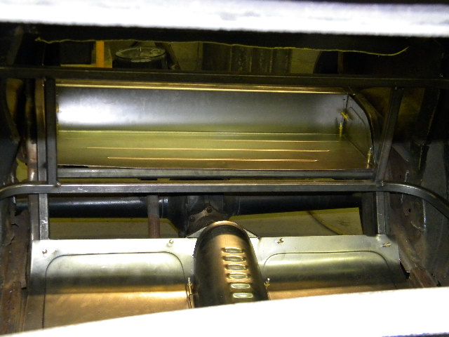

    some more work from today
    fabbed up front section of the trans tunnel
    p***enger side toe board
    area of the floor were the fuel tank will sit
    all the lines laid out for the section of the floor that go between the floor pans, and the gas tank area
    the panel made up and in place
    this panel goes behind the area for the fuel tank and makes a small storage area in the rear
    and with the fuel tank in place
