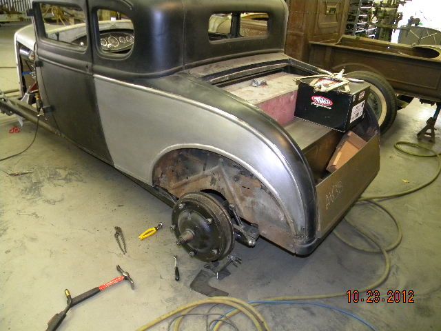

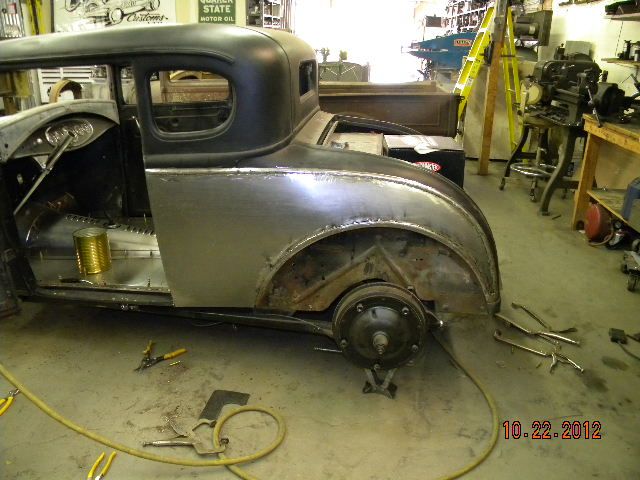

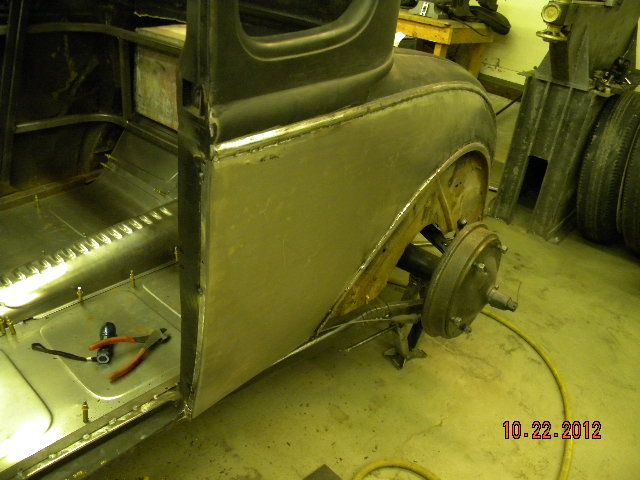

    made a little progress on this one today. the original quarters had the fenders gas welded on, higher than normal. needless to say they did a horrible job and ruined the quarters. i tried to grind down the welds and straighten the original metal, but it was to thin and brittle. so i decided to just make new centers for the quarters. here is how they are coming out
    before i got started
    the old quarter center removed
    the new sheet metal, spent some time on the english wheel to get the crown to match the original.
    first test fit, pulled it back off and did some more wheeling and shrinking on the flanged side
    started tacking it in place
    mostly welded up and ground, ran out of welding wire for the day. once i get it fully welded and ground, i will do some more metal working to finish it out

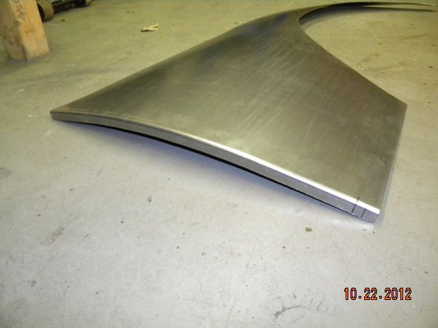

    since i ran out of welding wire and had a couple more hours till close, i started on the hood. making a cardboard template
    bead rolled, flange bent, and ran through the slip roll
    some more rolling
    got it fitting good, still needs some finish work

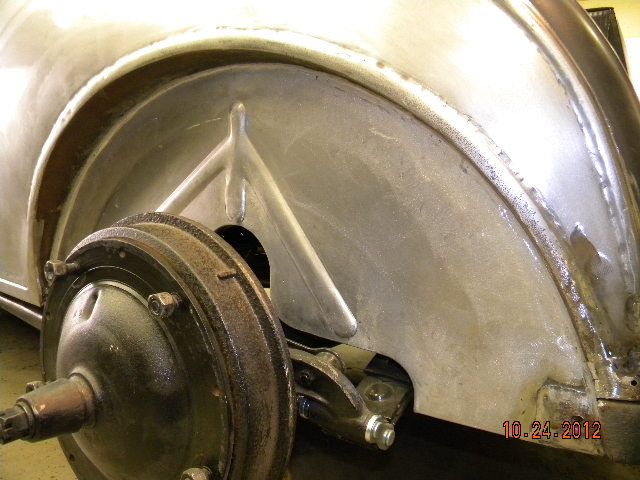

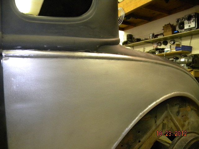

    got the driver quarter pretty much finished ( still need to do a little the rear area) .after all the welding and grinding i think it turned out nice, will just need a little filler right around the body lines to smooth out some of the grinding marks. then it was time to start on the wheel well.
    cut the old wheel well out
    the customer had already bought these wheel wells so i will use them. needed to be cut out for axle and spring clearance. i also moved the finished ends of the beads up that i had to cut through. i think it gives it a nice finished look.
    then i need to add the flange back on where i cut

    got the wheel wells tacked in and then welded solid and smoothed out

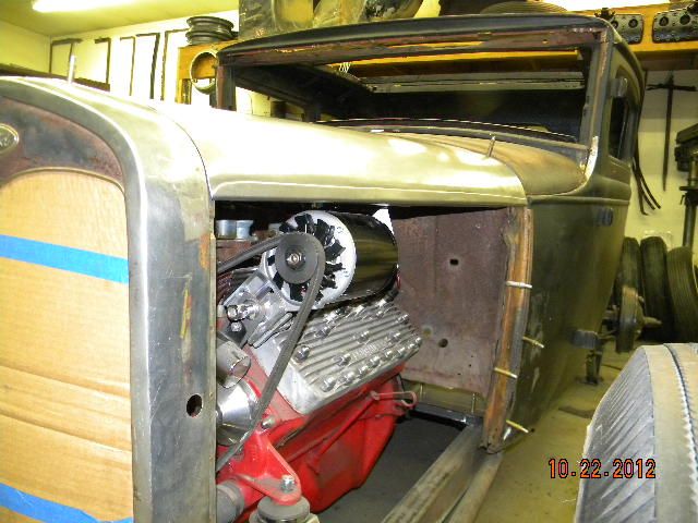

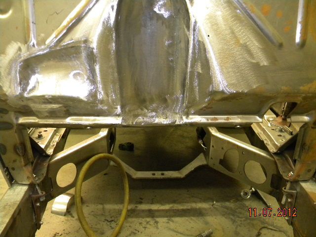

    finishing up a 1930 roadster for my uncle. he bought this form one of my customers that had lost interest in it. i did not build the car to this point, but will be finishing it. needs a little more metal work and ch***is welding, then body, paint, and interior. hope to have it finished for him in march.
    as it came in, mostly mocked up
    some of the work that needs to be finished up.
    the start of the new distributor recess in the firewall
    after some shrinking, plannishing, and rolling. also got the head recess made for the p***enger side and welded in
    pulled the motor and trans to aid in finishing the firewall work

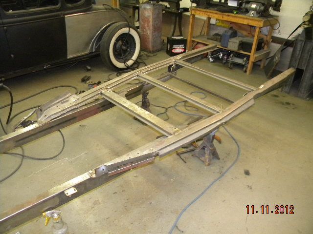

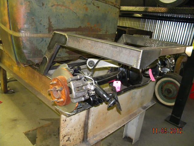

    so i had a customer drop this car of that he bought. it was half *** tacked together and needed to be redone as well as some other work he is wanting done.
    brookville frame that has had the rear x member cut off. going to "Z" it 3 inches in the rear
    trimmed and rounded the rear section at the point of the new "Z"
    the frame "Z"ed and the sub rails laid on the frame
    cutting and re working the subframe
    starting to get the sheet metal clamped onto the subframe. then all the bracing
    angled the rear sub rail back down to get the body to sit level

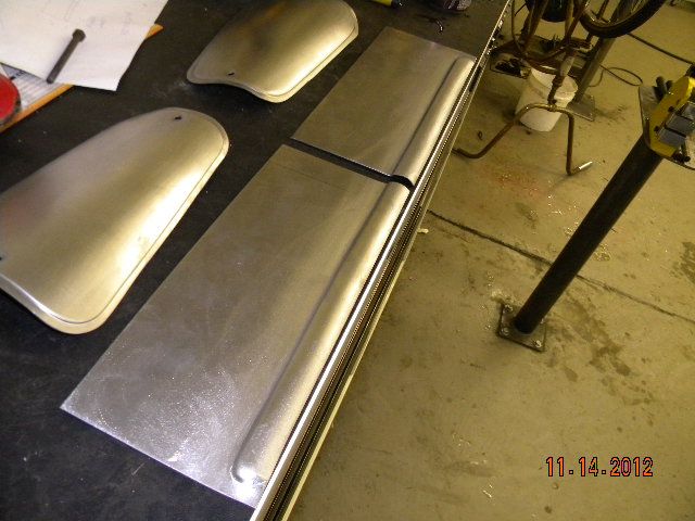

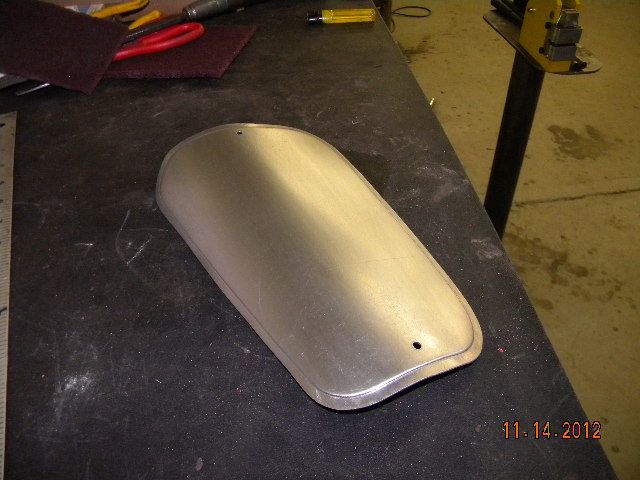

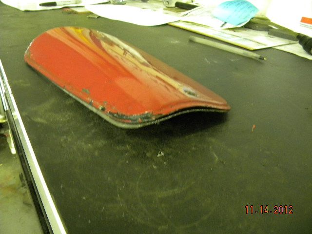

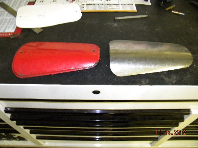

    the other day i got a package that had a sketch of some lower cowl patch panels for a 37 ford truck, and also one windshield wiper motor cover. i needed to make two lower patches and both motor covers. so here is what i did
    here was the wiper motor cover he sent me.
    made a cardboard template
    after a trip through the slip roll
    and a little wheeling to get it closer to a good match
    after some more wheeling, and running it through the bead roller to get the flange
    now time for the lower body patch. i didnt have a bead the right size and shape so i had to hand make it
    ran it through the bead roller to get the bead started with a step
    after some hammering on a 1 in round T dolly
    all finished up after a lot more hammering and plannishing and repeating the processes for the opposite side panel
