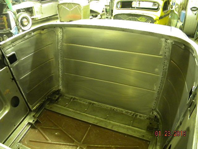

    its been a while since i have been able to work on this car, but am slowly getting caught up on work at the shop. i have been busy getting all the metal work finished up so it can get epoxy primed and start the body work. the first major job was to get the panels made that go beside and behind the seat. these give the upholstery something to attach to, so needless to say no one will see these when the car is finished lol
    a shot from inside the trunk

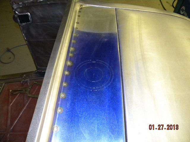

    doing some welding and grinding on the street rod styled tail lights that were in there. they will be replaced by some 50 Pontiac lights
    laid out and drilled the hole for the deck lid handle
    laid out the placement for the flip top gas cap
    welded the transition peice that attaches to the 1/4 panel and rear panel
    removed the trunk flooring to prime all the flanges that will be welded
    getting welded up
    then pulled the body off to do some reworking on the frame
    going to redo these body mounts that were on the car when it came to the shop.

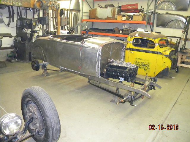

    working on getting this one a full roller with motor and trans installed
    tig welded the 4 link links up
    got the rear axle mocked up on jack stands
    bolted the mock up block to the trans, then mocked up in the frame. going to be fully mounted up tomorrow
    and i made this the other day, milled it out on the bridgeport, did some minor grinding, then sand blasted it to make it look cast
    Hollywood-East likes this.
