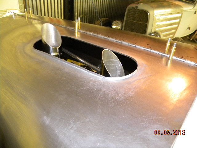

    so first thing this morning i got started on the driver side hood top.
    then i had to cut the hole for the carb scoops to stick through, after i cut the hole i had to add 1/4 inch flange that came up from the hood top for strenth as requested by the owner.
    then moved onto the hood side, here is all made up, i added an 1/8 in wire edge on the bottom and ran a flap wheel over it to clean off some marring left of doing the wire edge
    then i went back to the p***enger side and started to fit the mesh screen into the opening i had cut. here it is mocked up for a good visual, so it only has bolts in every other hole or so
    then onto adding the latches and lift handle
    and a few pics of how she looked before i left for the night.
    now after the owner stops by tomorrow and checks to make sure he likes the way it looks it will be time to dis***emble, drill drill drill, and do some buck riveting to hold it all together

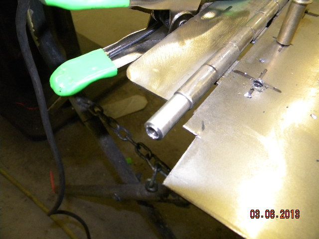

    the center hinge pin didnt fit in the hold downs very well so i machined a sleeve out of aluminum to take up the slack
    got all the holes drilled ready to put together

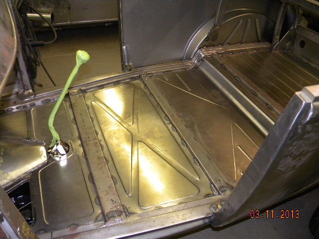

    made all the floors and cleco'd them in place
    removable panel to make it easier to fill the brake reservoir
    all welded up
    then started on the panels the will separate the p***enger compartment from the trunk area

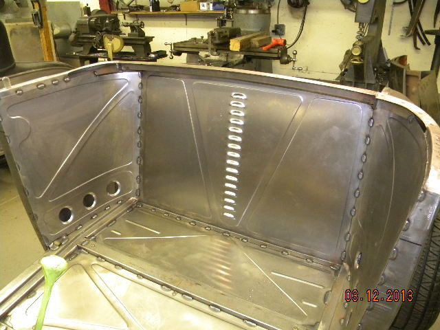

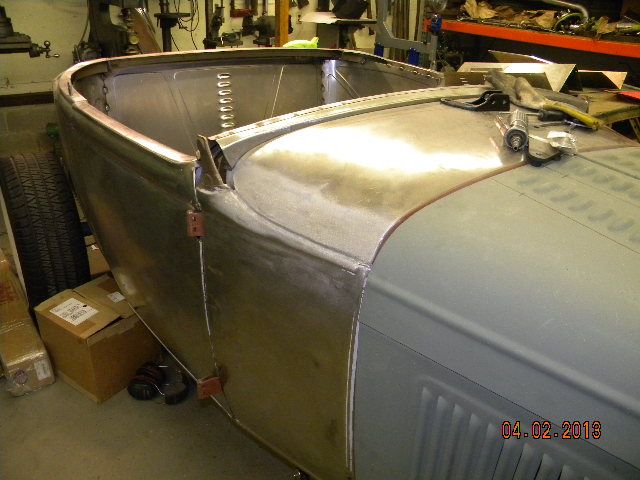

    finished up the panels that go behind the seat and separates the p***enger compartment and trunk area
    moved onto the door panels and kick panels
    the before and after
    after, and before sand blasting and scuffing
    and the driver side in

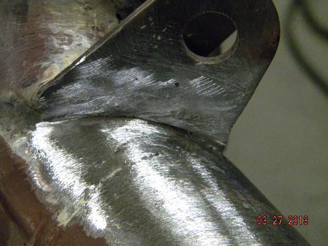

    i have been working on this car for the past two weeks getting it ready to go off to the paint shop. the frame is all welded solid, ground and cleaned up. we were doing some checking on the rear end making sure the drums and backing plates matched the brake off set, and cutting off the brake line mounting clips. when i though " i really wonder what is under the filler on the housing ( the previous owner had welded all the brackets and smoothed everything out and primed it). well i am really glad i decided to grind out some of the filler to investigate. some of the worst welds i had seen in person were holding all the 4 link brackets on.
    to get it all fixed right i gutted the housing, put the housing in a holding stand and installed my narrowing jig to hold it all straight. when i installed the narrowing jig bar there was some tension on the bar so that meant the housing was bent from all welding on the brackets. so i used a torch to heat shrink/ straighten the bend before i started the welding repairs. then i ground out all the old welds and re welded everything making sure to jump all around to keep warping down. then after the welding was finished i had to do some more heat shrinking on the tubes to take out some of the warping from me welding on the housing. now it is all good to go after about 8 hours of repair on the rear end housing.
    all the "welds" that i found under the 1/2 inch of filler

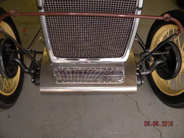

    making some progress on this one.
    frenched in some 59 caddy lights, the old tail light holes
    the new going in
    welded some supports in on the back of the tail light can
    all welded up and ground down
    made some brackets to hold the fuel cell
    welded up and smoothed out the gas tank/ cowl side seam
    working on setting up the steering, got to love string
    more of the steering also got the pan hard bar installed
