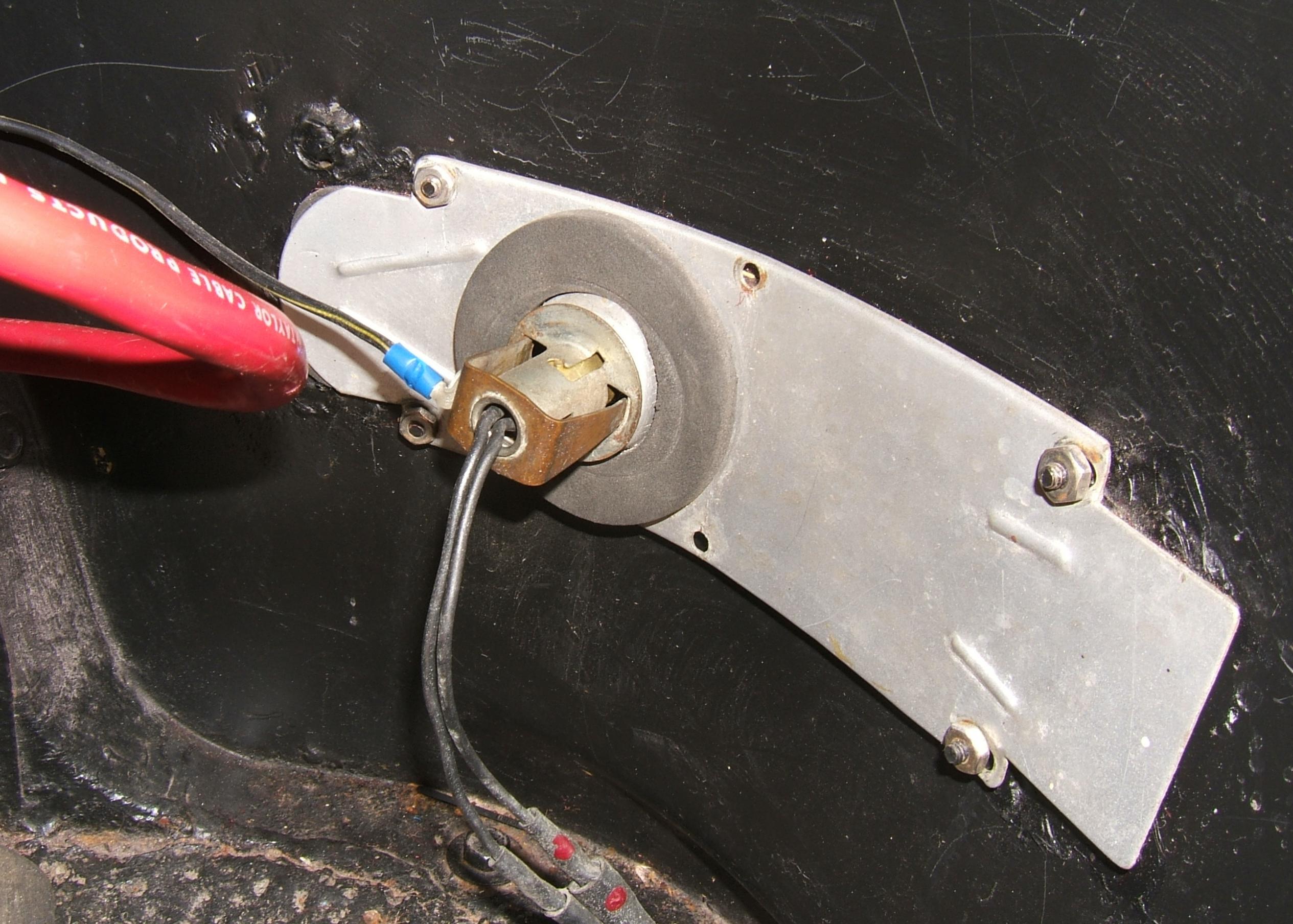

    Frenching stock taillights
    TwoChops
