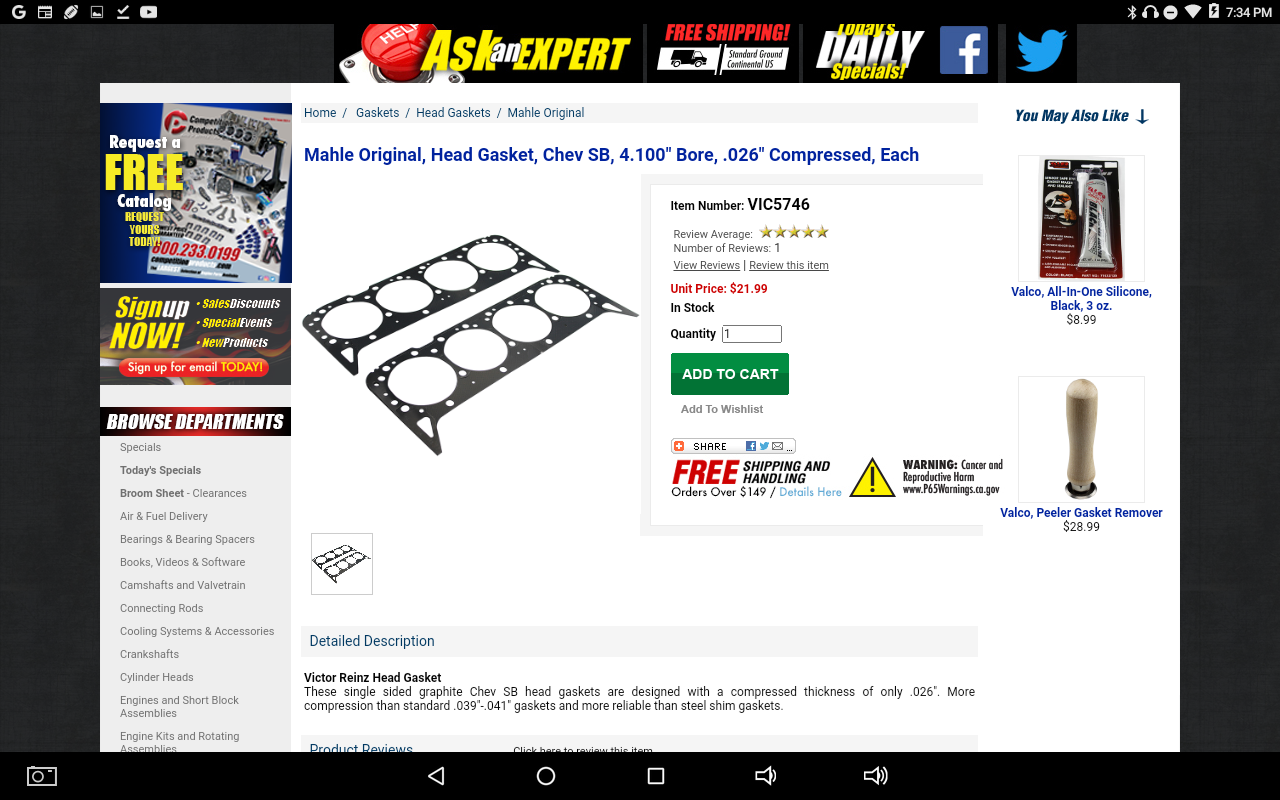

    Screenshot_2023-09-08-19-34-29.png These are a bit more forgiving to head & deck surfaces
    bobss396 and Budget36 like this.
  14. Budget36
    Joined: Nov 29, 2014
    Posts: 15,849
    Budget36
    I used that same set before.
  15. Koz
    Joined: May 5, 2008
    Posts: 2,793
    Koz
    I've had good success in the past with Fel-Pro 1096. This is a stainless .015 shim that has proved reliable. I can see where the composite gasket would have an advantage. Thanks!
