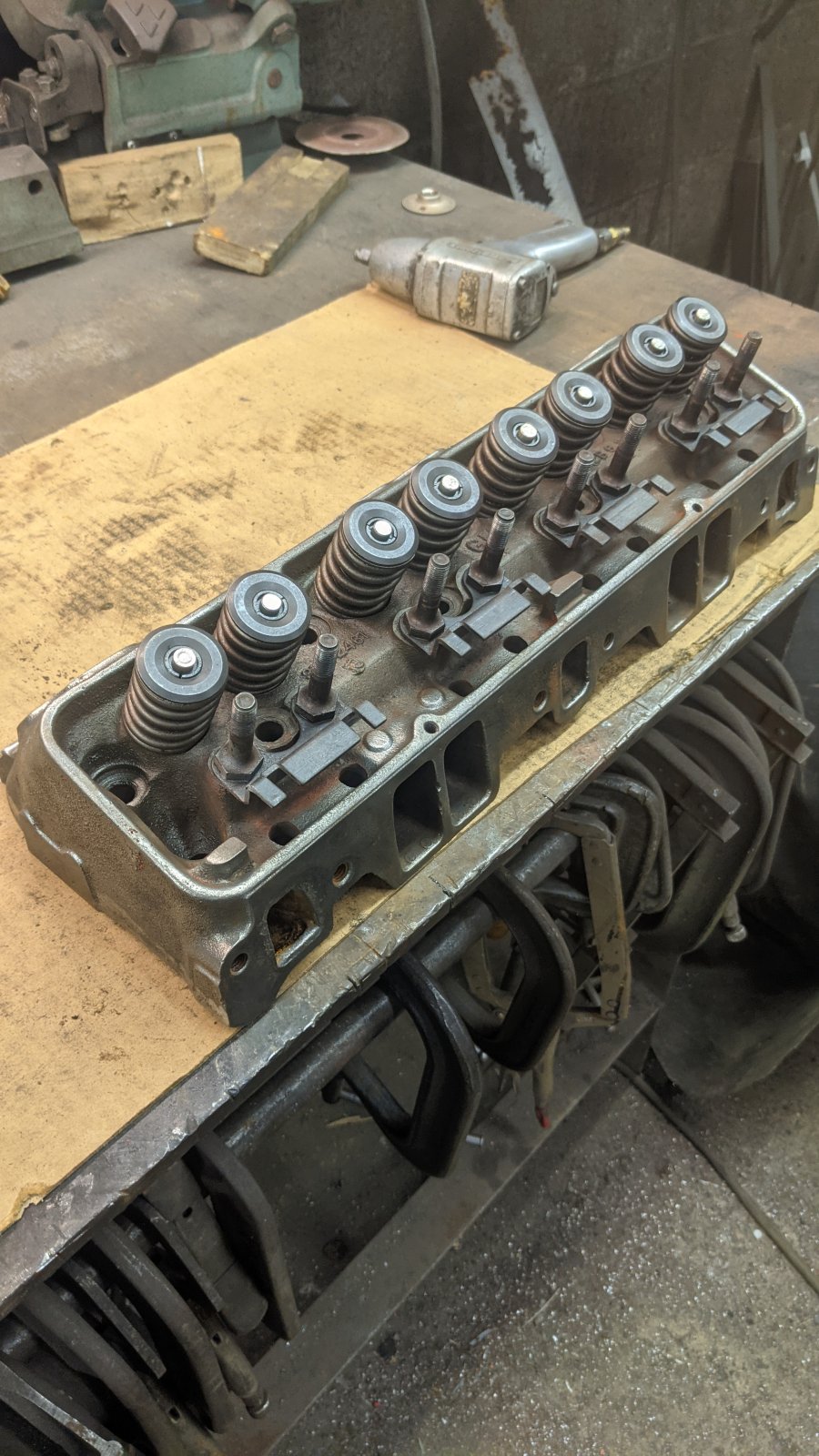

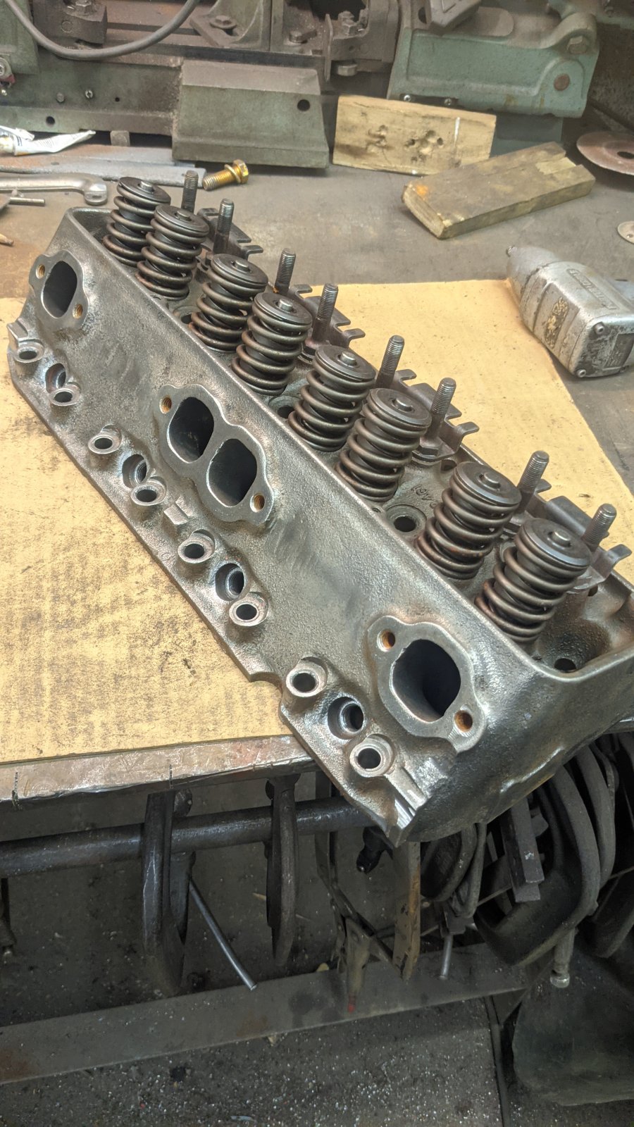

    Spent a little time today cleaning up the heads I acquired this week. They look pretty nice as they are. Good guide plates, 3/8" screw in studs, I pulled a couple valves and they are just as the fellow said, very fresh. I'm very happy with these. They come in right around 62cc so I'm ***uming one cut at some point in their life, although I have heard of 461's that were 62cc from the factory. They are dead straight however and no cracks or other ****. They have one hole in the top oil rail only, (didn't hit any water), that was put in to attempt to run later accessory brackets. Nothing a little PC and a bolt won't cure. I'll cut it flush and nobody will notice.
    They came off a 383 and track use. You can tell they were running tap water, no coolant, by the **** inside which will clean out pretty easily. They have never been ported,(excellent!), so I'll just do a light port match before they go on. I'm happy.

    Id check the spring pressure . Those springs look a bit much for a mild hyd RV cam and bit much for what your were thinking
    Koz likes this.

    I don't have the ability to check spring pressure but I'm sure it's up there. I'm going to use a good quality hydraulic cam and lifters along with hardened push rods so I don't think I'll have much of a problem. I have a set of stamped steel roller rockers, a 1.5/1.6 split set that I could use. I should probably just use stock style stamped rockers but the rollers wouldn't hurt anything. I myself have never broken one although I hear the usual stories about losing rollers into the galley. No preference either way.

    You don't want to break the cam in with some big heavy springs . Id recommend removing the inners for the break in at least .
    Any shop can check the spring rate at your installed height for a few bucks . there are even tools to check them on the heads .
    Watch that the stock rockers do not hit the larger valve retainers . I had that happen once.
    Extra stiff springs are hard on the cam , Hard on stock rockers and push rods an need more horse power to work them . If there for a solid roller cam ( I dont think they are ) they will not go well with a HYD street cam .
    Amazing what a set of early standard size z28 type springs can support on a under .500" lift cam .

    I just visually compared them to a stock 307 head I have here and it is a huge difference. I'll see if B&Y Machine can check them for me. Once again I've made what should have been a cheap junkyard engine into the money pit. Sometimes I just can't resist screwing myself. Hopefully it will run half decent when I'm done.

    Yep! They check at about 4.100" in diameter.....

    I see valve springs with dampers .not necessarily hi perf. You didn't mention what condition the guides are in or whether or not there are valve seals . go to your local machine shop & grab some used( worn out) valve springs for break in .

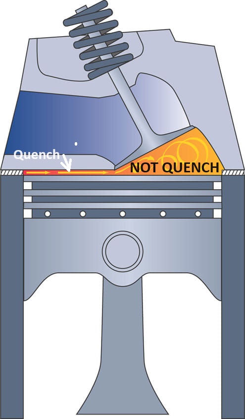

    I don't think you realize what not having a proper quench area means in the operation of the engine. Its really not an "option", as the combustion process can be a real problem. It may actually be the reason the engine was removed from service. Met a guy who did it wrong one time and he had to buy octane booster to add to his gas to prevent knocking.
    Your choice is to either get new pistons or to deck the block.
    To make your "band aid" approach work, you want to use a cheap head with small combustion chambers. That does not help solve the quench problem. If you deck the block, you can then buy any number of heads that will work. Some heads have different accessory holes. Usually an old set of heads ends up needing to be refurbished and you have as much in them as better newer heads would have cost.
    I'd deck the block and then look for a decent pair of alum heads to put on it. There are some decent used alum heads out there that will end up costing you little more than repairing clapped out heads.
    Something to realize is that compression ratio and quench are not the same thing. You can have proper quench and still build for a lower compression ratio.

    Good idea on the valve springs. I have a pretty good supply around the shop. I do primarily fabrication work and usually send the motor work out. This is the exception because it's mine and I usually just buy a salvage motor for my own stuff. The heads are indeed fresh. nice valve guides, seals, and everything else. I believe the springs to be some variation on factory high perf. hardware. I honestly don't think they are some insane roller cam territory springs with an insane spring rate. Most certainly aftermarket but not high end.

    Regarding the springs, if you have a bathroom scale, drill press and calipers you can measure the pressure at installed height and open height of the cam lift.

    you never going to get what the guys on the internet call proper squish , quench, clearance
    @Budget36 said: I was under the impression it was to reduce the possibility of detonation. (Yes, that's correct)
    I asked the question once about how you could maintain quench in an engine with low compression. The noted journalist explained it to me.
    The compression ratio essentially has nothing to do with quench. By that I don't mean that it doesn't play any part in the compression ratio, only that you can build to have any compression ratio you want and still have proper quench. The dishes and valve reliefs do affect the compression ratio......but around the outer cir***ference of the pistons top there is usually some flat surface. The distance from this surface to the bottom surface of the engines head is where quench resides. Yes, making the quench distance larger or smaller will have some effect on the overall compression ratio because its part of the compressed volume contained above the piston at TDC. The point simply is that the initial combustion process works better when it starts in the smaller confined space between the flat part of the pistons top and the bottom of the head. Not having quench or the proper amount of quench to start the combustion flames travel across the chamber can lead to detonation. Realize that quench is not the whole top of the piston, because there is a combustion chamber rising into the head to accommodate space to open valves and expand the burning gas. Quench is only basically where the bottom surface of the head is flat......and slightly above the flat surface of the piston. Even if you had a completely flat top piston, quench would not be the whole top of the piston because you have a combustion chamber above most of it..
    "]www.motortrend.com/how-to/ideal-quench-height/[/QUOTE]

    While new pistons may come with a better quench, realize that it doesen't matter if you raise the compression ratio if you still have poor quench. See the article I attached above. You may luck out or you may not, but check the pin height of your current piston and the ones you may order. If the pin height is the same, the quench will be the same even if you changed the compression ratio.
    Basically you need to calculate what deck height and gasket thickness you need. I'd just mill the block and re***emble it. There is nothing wrong with keeping compression low so you can run regualar gas because you drive a lot. I fool with old 472/500 Cadillac engines and they built many of them with 7.5 compression ratios.
